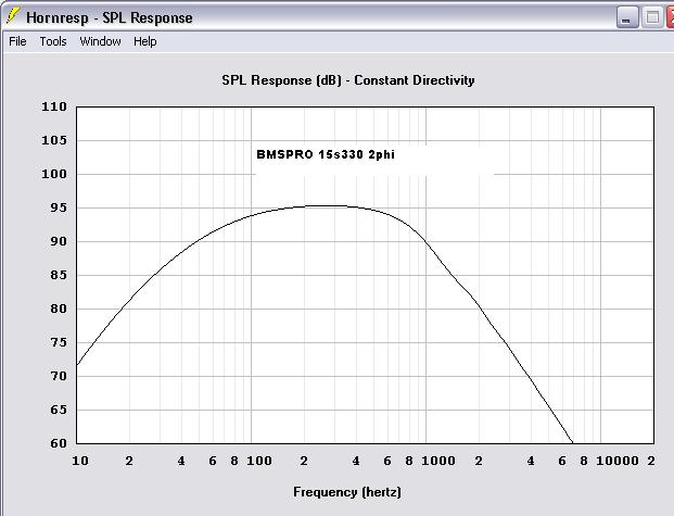

BMS 15S330 nice driver xmax 8mm. Athough the Altec is hard to beet it is a very good choice for a OB.

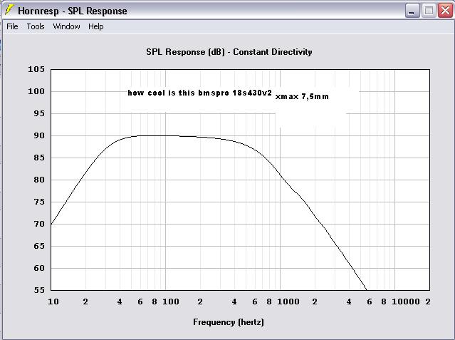

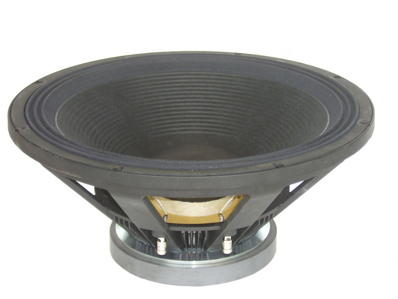

What did I say altec hard to beat? This 18" is perfect.
BMS pro 18s430v2 within xmax up to 110dB incredible!
Thiele-Small

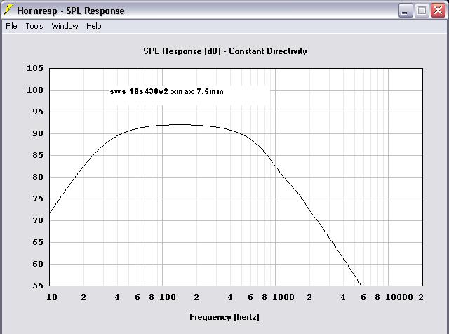

A fault enterd the simulation, with a wrong Re I had simulated.
Here the corrected simulation. still great even better spl.
