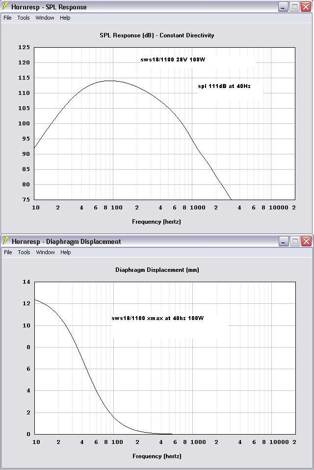

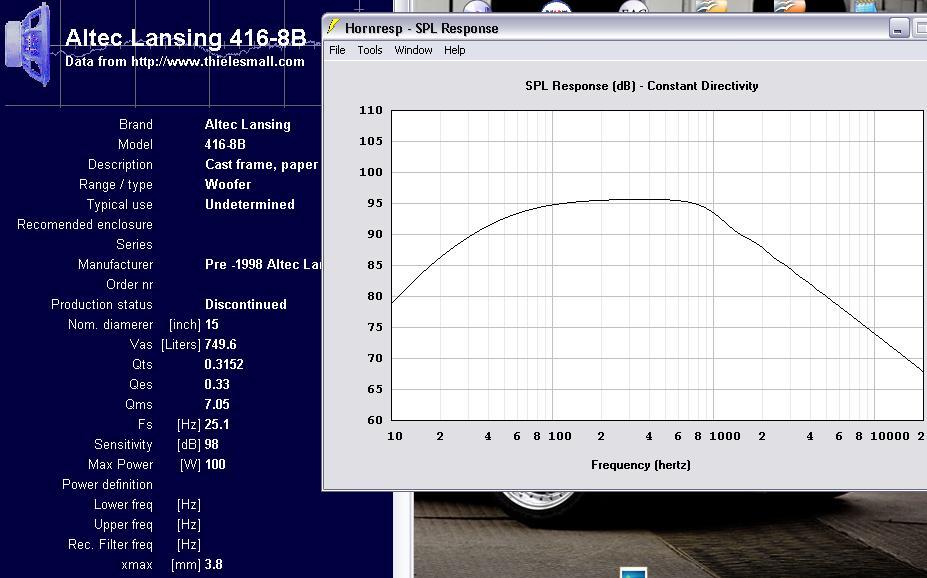

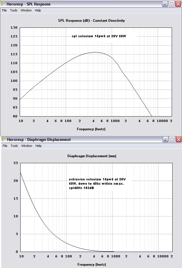

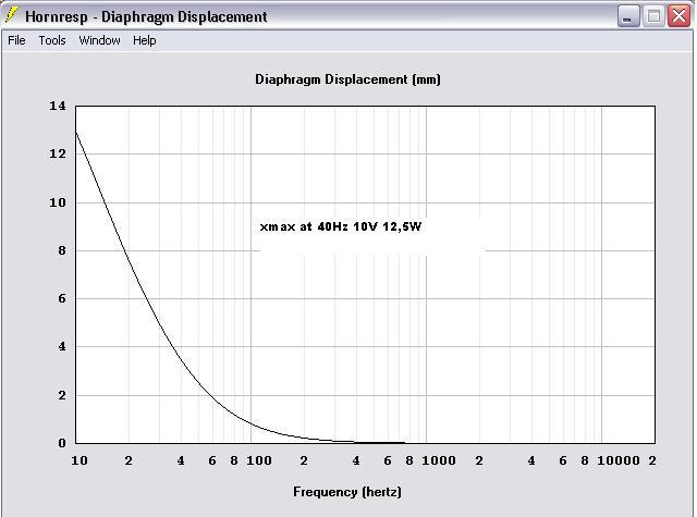

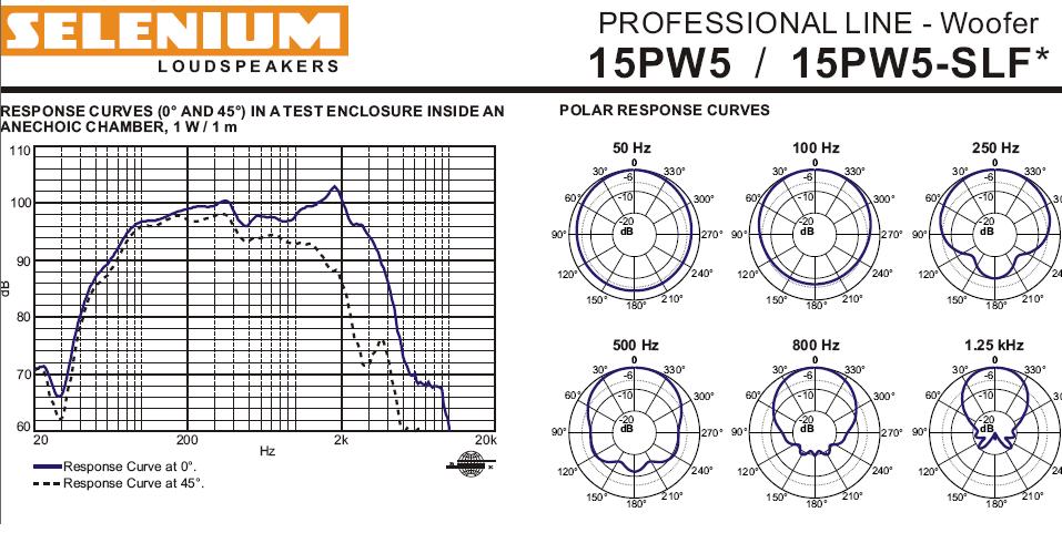

When you simulate you can see what spl you will get at given power and the xmax the driver makes.
So your xmax depends on how loud and low you want to play.
Loud and low means big Sd and xmax.

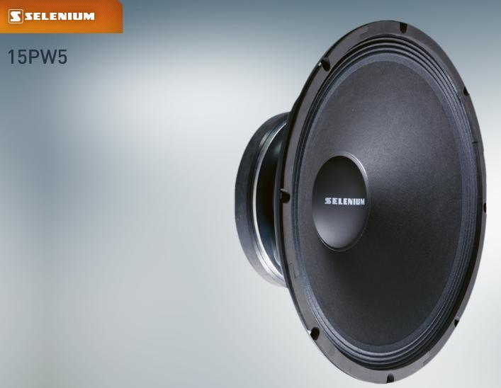

A 15" with 5mm will be enough when you use two like i caculated for you with the linkwitz sls driver. It is about how much air the driver can move Sd*xmax and then with the right Q to have a flat response.

High Qts drivers are popular for open baffle applications because the bump in response at FS helps to counter the open baffle rolloff and extends the low frequency response.
That only applies to passive systems, however. With EQ it's easy to boost the low frequency response and there is no real benefit to high Qts.

And not only to active systems.An open baffle speaker placed at some specific distance from the nearest boundaries,design specifics prevail,will overcome a low Qts, 6db/octave loss,without equalization.Listening space,is the main component that a system must be tuned to.

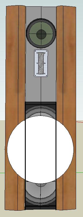

It seems my desire to have two 12" is a lost cause:confused: I'll see if I can come up with an aesthetic design I like that incorporates, two x 15 or 1 x 18".
The aesthetics are very important to me, even though I dont have to worry about the WAF. I cannot live long term with speakers I dont like the look of, especially if I have built them.
Obviously I dont want to comprimse the sound quality for the looks, it's just finding a good combination of the two.
Maybe I could use the 12"s then add a sub to fill in the bottom end, althought that seems like a compromise & from what Iv'e read hard to get a seamless fit.

The baffle that you did design can easy hide a 18" behind is and then it is not a big problem to keep the opening for the cone 12" wide and 18" high. So what concerns dimensions you do not have to change your design.
Correction maybe make the opening wider 11-14 inch. Or make the opening round where the woofer is located.
Designing is often about making compromises DQ828.

Yes I read your post & perhaps I was being a bit melodramatic saying using two 12" was a lost cause. Your suggestion are very valid, but are also a long way from my goals, being, a hi efficiency, passive design, the tweeter is about 96dB & the mid is somewhere closer to 100dB, or so I have read.
I dont want to get involved in an active design at this early stage of speaker building hobbie. Also I aleady have the amp etc.
If you know of any hi efficieny, 12" drives with a Qts of about 0.7 & a xmax of 6+ let me know, all suggestions are welcome.
