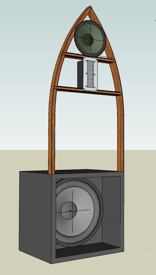

New Concept
Well Iv'e committed to the Dipole15, I have two on the way, which has blown the woofer budget, especially since the shipping cost more than a driver.
I have been reading lots & have a new concept, have a look at the plan & see what you think.
I am also toying with going for the Neo10 & Neo3.
Iv'e read good things about the Neo10, but thee measurements Iv'e seen dont look that impressive?
The drawing is only a first draft, I thought I'd put it out there to gauge wether its a good idea or not before I got too carried away, as my first design didn't go down to well, as much as I liked it.

Like the gothic arch style. If you get the thickness right it'll operate as an inverted pendulum but I'm not seeing a good way to do a magnet mount on a cone mid without messing up the look. It'll also sound better if you decouple it from the H baffle and move the woofer's acoustic center forward so it's time aligned with the mid and tweeter. See here and the next few posts for some of the issues around vertical separation of drivers.
Are you making the common mistake of looking at the free air SPL in the Neo10 datasheet and thinking it's infinite baffle?

Well, congrats on the Dipole 15's! Low cut filter below 25-30Hz and you will be rewarded with great sound. How high do you intend to take them? Your mid may be too far away being way up on top like that. I'm running them up to 300Hz right now, but will try up to 400 also. They can play clean as high as you would ever want to go, but being in that H frame, you'll want to cut them pretty low or you'll be running into the resonance of the frame.

I'm not sure how high, I need to measure the various speakers & see how it pans out. I wont get them for 4 to 6 weeks so have a bit of time up my sleeve.
I'll probably make a test box & play around a bit first. I assume you would give the Neo10 & 3 the nod of approval?
