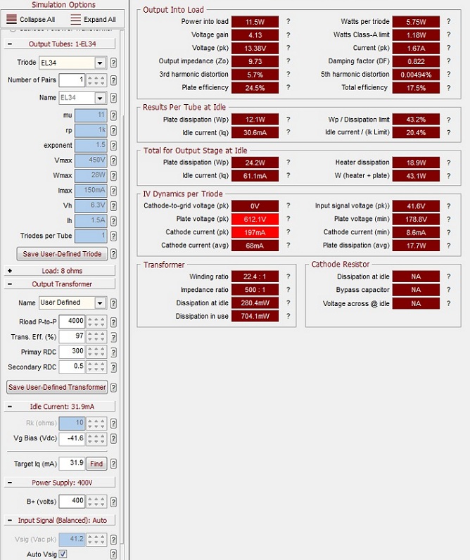

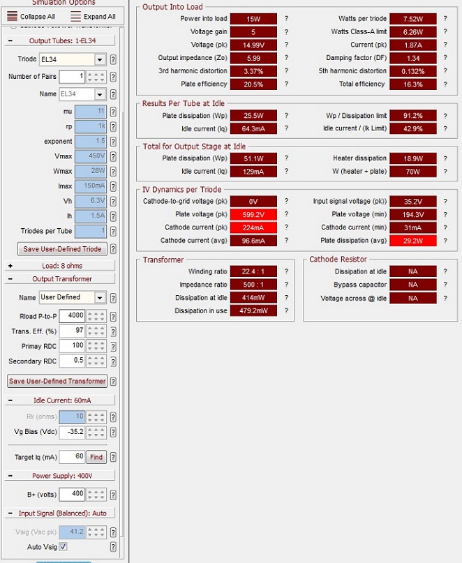

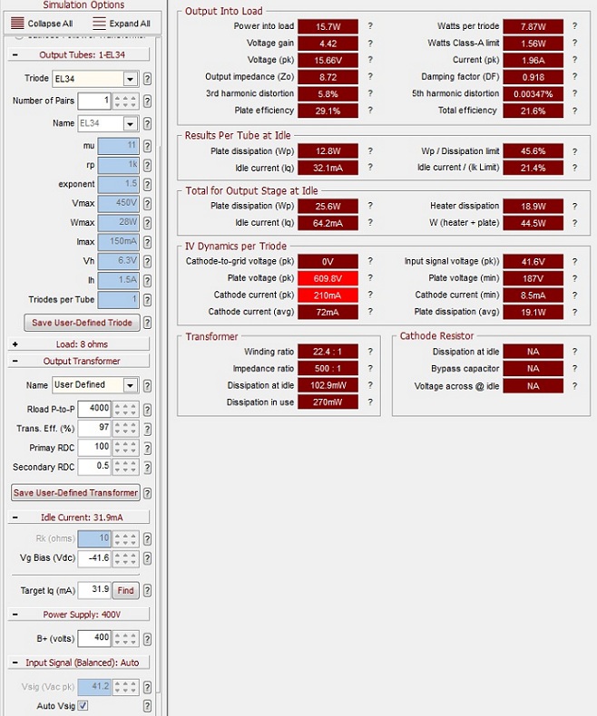

Stuart: Thanks for the screen shots, the first thing that I notice is that your PP calculator GUI is totally different than mine! A few screen shots:
My PP calc GUI has a box for transformer primary DCR....that impacts power out.....
So the first two screen shots are with 31.9ma, 400V, 4K OT with 300R and 100R primary, and the third is with 400V, 60ma, 4K and 100R.
Also, for reference, here is the link for Duncan Amps TDSL for EL34. Notice last entry in the table is AB1 PP triode, 400V, 65-71ma, 16.5W, 3% THD.
