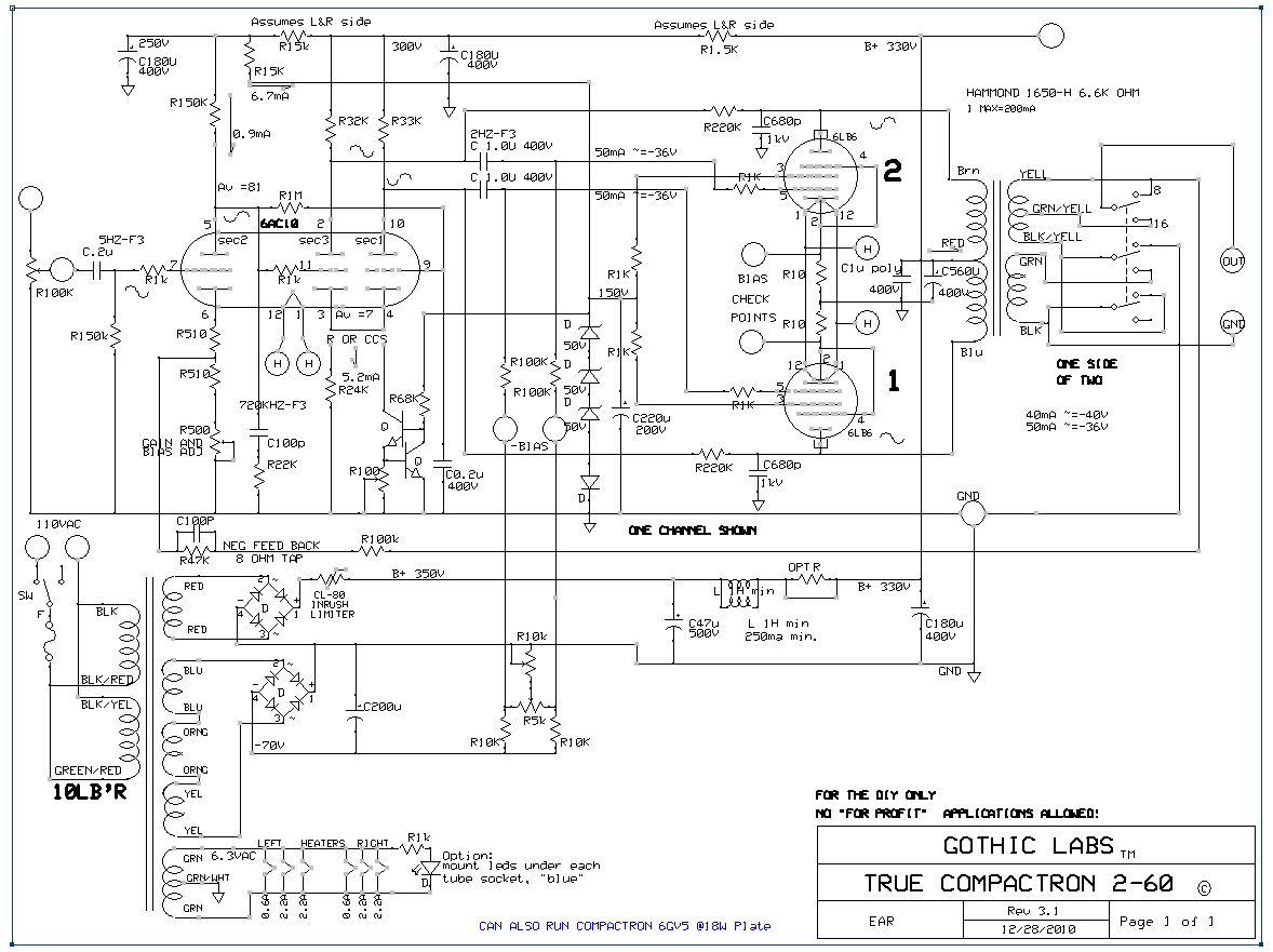

Thanks very much for all the help everyone. Indeed I am slowing osmosifying a bit into my head.
Zout for EL34 PP Triode is 5000 ohms. It seems then that 4K primaries would load the tube a bit less than what would be ideal. Can I still make this work alright with my iron? I can't easily afford to spring for a decent quad of KT88 right now. I'm gonna be scrounging as much as I can from existing parts for all of this. If I can make it work I think I am going to go with something derived from the 5-20.
Next question -- If'n I wanted and easy tool with which to draw my schematic what might I use? I've used Eagle before and that's an option. I am a Linux user and prefer not to drag out the the ol' Windoze machine but I have a few around and can if I need to. I'll note here for other Linux users that PSUD II does run in Wine.
You'll be just fine with 5k. If you choose triode, it's easy enough. You could also consider a separate screen grid regulated supply if you wanted to try pentode. Either will work.
I run LT Spice in Wine in my ubuntu machine all the time. Easy to draw with and with some patience, you can also do simulations.
Stay as true to the 5-20 circuit as you can. If you want to get creative later, that's great, but the circuit is proved as is. The big improvements are in the power supply.
4.3K loads the tubes a bit more than 5K, usually resulting in more power out and more distortion. Do you any idea what power the transformers are rated for?

Re: the amp circuit, you can experiment with different output tubes at your leisure. If you wire it with an eye towards compatibility, you can swap in KT88/6550/EL34/KT66 to your heart's content. But it's really hard to beat EL34s, 6SN7s and EF86s for great sound. Not saying it can't be done, but I don't think you'd be embarrassed by the sound of your amp ever.

The transformers were from an amp with PP 7355, which are supposed to dissipate 25W so I figure EL34 in triode mode should be alright(?). Physically they are as large or larger than my set from an amp which is basically a Mullard 5-20 (a Knight KA-95...which ain't working either).

Again, within the context of your project, it's a big job, keep it as simple as possible. Buy a couple of inexpensive NOS 6SN7 variants. Even the cheap ones sound good. Check out Jim McShane's website. He's an honest guy. his advice is golden. He suggests new reissue Tun Sols @ $18+ each

I like to set up the input with stable DC bias and AC couple into it with a 5-10 hz -3db point. I'm not sure for the EF86 if that would be around 250k to ground on the grid and a .1u couple to the input pot. around 6hz -3db point....
You still need the cap on the gate of the LPT lower SN7 biased by the 1M, .05 .1u would work and you have excessive mismatch in the resistors. 33k-27k only need 33k-30k and they can be matched if you use a CCS.
If you use the common 10 ohm bias check resistor, the output tubes will need to matched, if you allow for bias adjustment for each output tube use separate resistors at 10 ohms each. It will allow you to minimize the offset current through the transformer that helps the low end response, preventing early saturation, and you can use tubes that are not "matched".
Furthering Roline's comments, consider a 10M45S CCS on the 6SN7 tail (super easy to implement, you need a current set R, and a gate stopper R), and reduce the value of P1 down to 100K-250K or so.
Also, you will need more than -30V to bias the EL34's. Shoot for a range of -30 to -40V or so. Separate bias pots for each tube are handy, and consider designing the bias supply to fail safe if the pot wiper lifts.
Someone with more experience than me may suggest a cap on the input depending on the quality of your transformers. Refer to Sgregory's Opus thread.

Well, most of that went half way over my head...but that's why I'm here. I had drawn up a fixed bias version as well. I'll go back to that and work on it.
The schemo you posted is fixed bias..........cathode bias will have much larger cathode R's and no negative rail.
Look at the Opus for the CCS in the LTP tail and the Opus and Music Machine for the bias supply circuit.
Playing around with various sweep tube bias, the 18watt biased at about -25 volts but the larger 35watt tubes biased at closer to -35 volts with one that wanted -55. I believe that you will also find this true going from EL34's to KT88's, so design the bias supply low enough to throttle back the tubes allowing yourself the option of all tube flavors. You may discover that you like the KT88 over the EL34's if you cant afford the holy grail mullard flavor. I just added a couple of the extra 6.3 volt windings to the 55 volt winding used for bias to go low enough. The attached schematic could be modified to just replace the output tubes, it has enough tricks of the trade for a very decent and well behaved amp, local feedback around the output tubes, in the form of plate-to-grid feedback coined Schade.
If you decide to go to cathod bias, the resistors grow in size and you loose voltage swing, output power....

1) No need for an input cap, unless you suspect you have DC leaking through some source output cap.
2) DC coupling as many places as possible (1st stage-phase inverter) is a goal to shoot for. Don't add signal circuit caps where not needed.
3) IF you do add a CCS in the tail of the phase inverter (6SN7), THEN the plate loads can and should be equal, as stated by roline. The numbers you have worked for Eico. ;^)
4) Yes, the EL34 will need a lower voltage (greater negative voltage) bias supply. -45V should cover any contingency.
5) As roline stated, better to have individually adjustable bias for each output tube. Reduce those 10ohm cathode resistors to 1 ohm. They are only useful for measuring bias current. Ideally, the output cathodes should have zero ohms between them. 2 ohms is a lot better than 20. If you stick with the larger resistors, consider connecting the cathodes together with a huge film cap, or non-polar electrolytic. Personally, I'd rather use the smaller resistors.
6) At the input, add a 1M resistor from grid to ground. Do not rely on a pot wiper for a grid leak.
7) Do you need the input pot? If you are using a line stage of any sort, best not to add another pot. If you are building an integrated amp, that is, including a volume control and selector switch, I'd use a smaller value pot, especially if you use the EF86 in triode mode. In pentode, Miller capacitance is not an issue, in triode, you have to watch out or your volume pot becomes a tone control.
8) Why not use the EF86 in pentode? It has none of the pentode edge and eliminates the Miller problem. The amp has lots of gain as designed by Eico. Probably it will still be enough with the EF86 in pentode, but you may need an active line stage depending on your source output.
9) For feedback: when you first build it, leave the NFB disconnected. Measure the gain. Then add a pot in the NFB resistor location. Set it for 20dB of feedback to start. Fine tune it by ear, but 20dB will probably be close. When you find the number that suits you best, replace the pot with a fixed resistor. Then, use a 1k or so square wave and a scope, look at the leading edge. Add capacitance, if needed, across the feedback resistor to tame any leading edge ringing. Don't overdo it, one or two waves is okay.
10) If you are considering compatibility with KT88/6550 types, you'll need a -75V bias supply, reduce those output grid leaks to 100k and increase the coupling caps to 0.47uF.

Oh, one more thing. If you can, build a completely separate power supply for the input stages. No need for any fancy regulation, just simple and straightforward, but:

My bad, it must have been the schematic before or after that that had the EF-86 as the amplifier. I single one will certainly give as much gain as both sides of the average 12AX7. I know I saw one in around there somewhere, at least it had EL-34s in it.
Thatch
If mfaughn uses the EF86 triode wired, will there be enough gain for a reasonable amount of feedback? I suppose this depends on whether or not a preamp will be used.
An even more basic question........since the outputs will be triode wired does he need any feedback?
