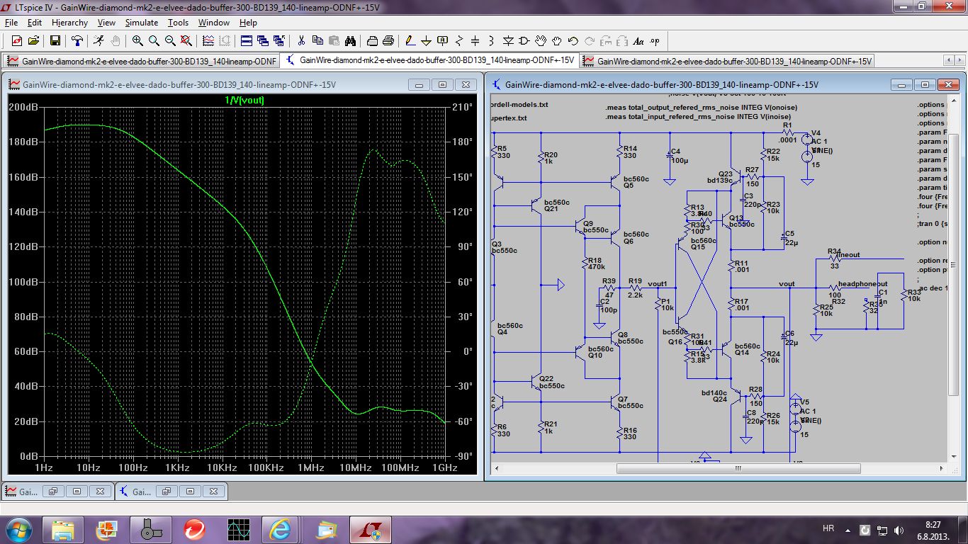

ODNF gainloop, the gain plots and asc zip file.
Thanks, had to take out the references to dadomodels.txt and supertex.txt but it runs now.
LTspice calculates THD at 1kHz as 0.000000%
Not enough digits after the decimal point? First time I've seen that!
Even at 20kHz THD is 0.000004%.

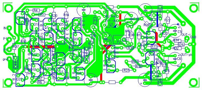

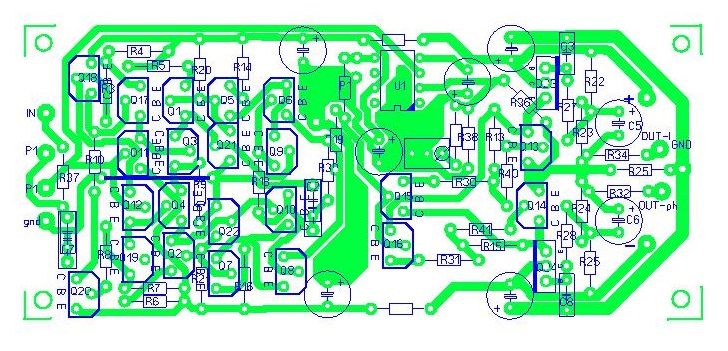

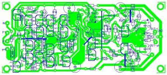

Two proposed PCBs, single side and double side. Corrected some mistakes.
Dimension 115x50 mm.
BR Damir
Thanks, Damir.
My only concern (not a show-stopper) is that the ground is not a star ground, and has lots of taps along its length. Perhaps it could be reworked into a single-point star ground, close to the centre of the board?
I'm not too intuitively familiar with the topology and its large-current flows, to be able to give specific suggestions, but it looks fine otherwise.
Thanks, Damir.
There are actually two separated grounds, input groung(gnd) and power ground(GND). I thought to connect those grounds to outside star ground where all grounds will join, power supply too from the power supply unit.
Thanks linuxguru!
BR Damir

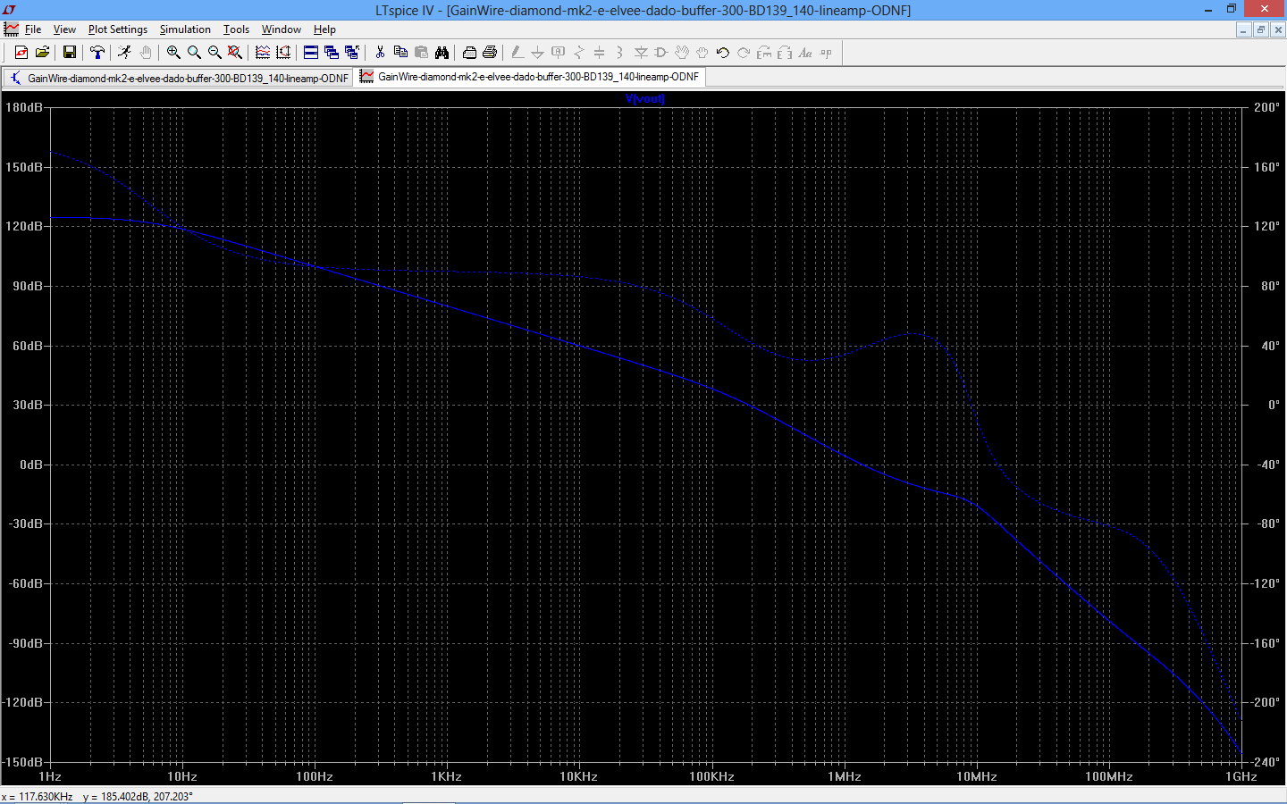

Damir,

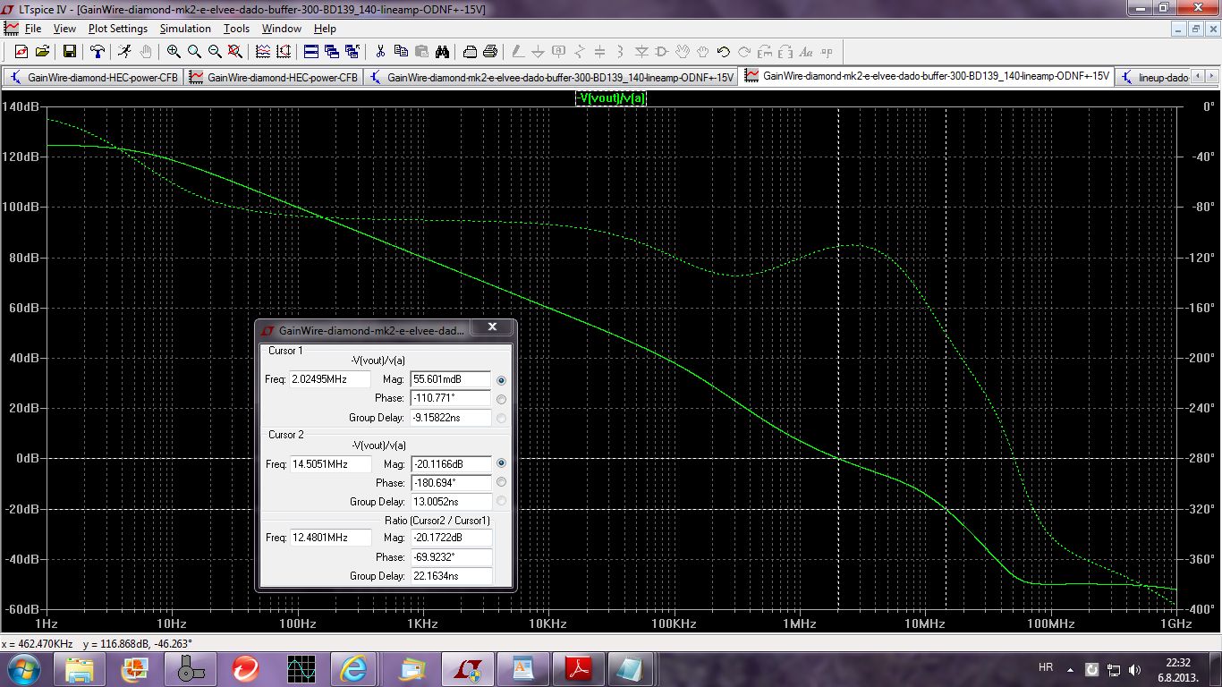

This is the open loop gain and phase margin of your circuit.
Unfortunately it does not have the minimum phase margin of 60º, and it has less than 30º at 1Mhz , the problem is caused by the P1 (10k) .
Damir,
I don't know why you call it open loop gain and how you simulated it, but here is my simulation of the loop gain. Phase margin is 70degree, and gain margin is 20dB.
