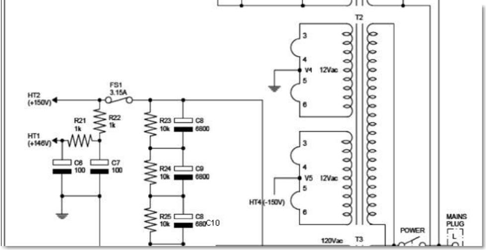

I check voltage on check point. Just after turn on all voltage was very close like on schem. But after warming up I find misbalance in the +150 and -150 rails It was around -146 and +166 I do not remember exactly(I bild amp in my lab.) . I check voltage on trans output – its OK 115v on both. How you solve problem with +150 and -150 rails centered around the ground??? but the current rise just on one side .... another one work ok...

I have always had similar problems of an imbalance between the +ve and the -ve supply rail voltages if I follow precisely the power supply design in the Tim Mellow article. I solved it by shorting out the 1K ohm resistor R33, so that the centre tap of the power transformer is then connected directly to ground. The two supplies are then pretty well constrained to be the same voltages (+ and -). As I said in my post 116, I think there are definite advantages to configuring the power supplies like this (although I don't believe it achieves any reduction in impedance at audio frequencies, but that is a different discussion), especially from the point of view of stabilising the voltages on each half.
You could also try an intermediate measure, of shunting R33 with a much lower value resistor.

Yes with the centre tap connected direct to the capacitors without any resistor you will not have any imbalance between the +ve and the -ve supply

Actually no. When I first built the Tim Mellow amp almost 2 years ago, I tried following his schematic with the R33 1K ohm resistor in place, and quickly found that it led to major imbalance on the two supply rails, so I shorted it out and fixed the problem. Just recently, a couple of months ago, I tried experimenting again with introducing R33 (but with a much lower value than in Tim Mellow's schematic--about 80 Ohms or so). There is still a significant imbalance, so next time I heat up the soldering iron I'm going to revert to a direct grounding of the centre tap. (But not for any any audio frequency impedance-reduction purposes! )

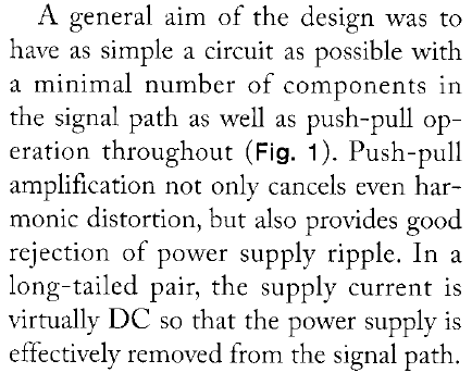

Yes, indeed. The design by Tim Mellow is probably a good one for nulling out any power supply ripple. If I get the time this weekend, I'll try to get some quantitative measurements of the hum level on the output, and the ripple voltage on the supply rails. It could be interesting to compare with other designs.

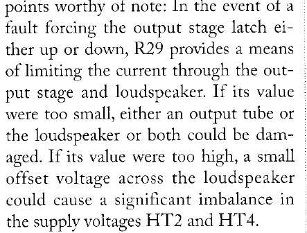

And yes, I felt a considerable nervousness at first, when I shorted out R33 (inadvertently called R29 in the text of Tim's article), precisely because it then means that a fault in either the upper or the lower output stage could have potentially catastrophic consequences. Two years on and I've not had any trouble, so I've more or less stopped worrying about it. Hopefully, the fuses will take care of any fault-induced surges. The security one would achieve by including R33 comes at the price of the tendency of the supplies to go out of balance, so I suppose one just has to make one's own choice of risk vs benefit.

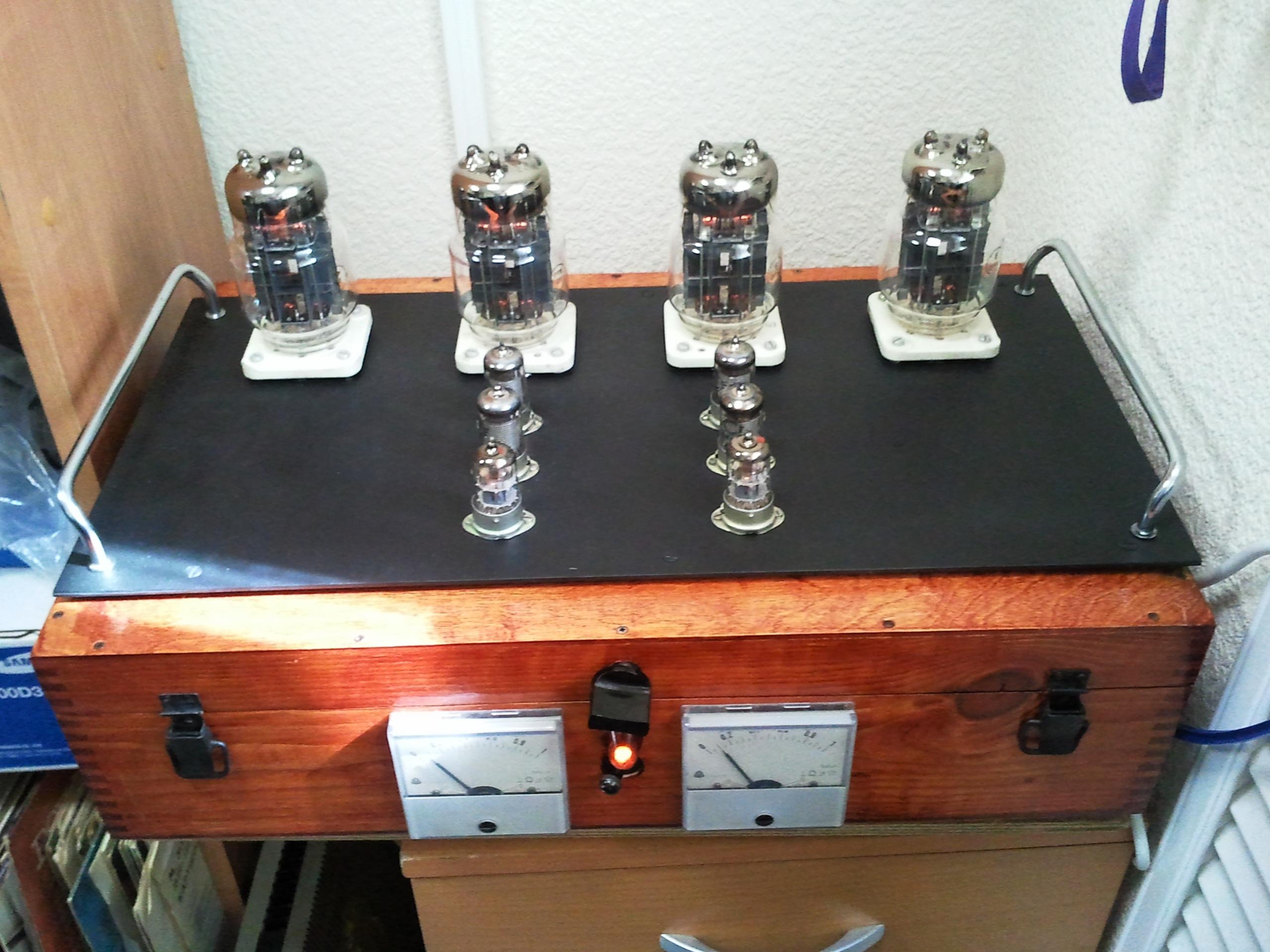

Thanks Chris ! I connect ground point with common point of transformers and solve problem with imbalance of power supply. The current stay more stable .
And finaly I can not adjust zero on one side. ... It still 200 mv even then I full rotate RV2 to one side ?? On another side all OK May be it no big deal .....Sounds good even in this case

I would suggest that on the side with the 200 mV imbalance, you try swapping the two 6C33C tubes, and see whether that changes the sign of the imbalance voltage. If that doesn't do it, then try swapping the two EF86 tubes, and see if that changes anything. If not, then try a different ECC83 input tube. If none of those alters the sign of the imbalance, then there must probably be something imblanced in the circuitry. Assuming no wiring errors, then maybe an out off spec resistor? But much more likely, I suspect, is that it's something to do with imbalanced tubes, which should be revealed by the swapping suggested above.

As I said before in post #123 '' for saftey reasons'' and I mean that , using high gm / high current tubes like 6C33C there is more possibilities to destroy the loudspeakers if the CT is connected , so BE CAREFULL it's better to use protection circuit for the loudspeakers when you connect the CT .maby Tim Mellow amp designed like that for saftey reasons or other reasons .

"you try swapping the two 6C33C tubes, and see whether that changes the sign of the imbalance voltage."
I try swapping two 6C33C tubes but sign of the imbalance voltage same. Before i change all anothe tubes. So it seems some thing with value resistors .(actually i am not use precision stuff, )

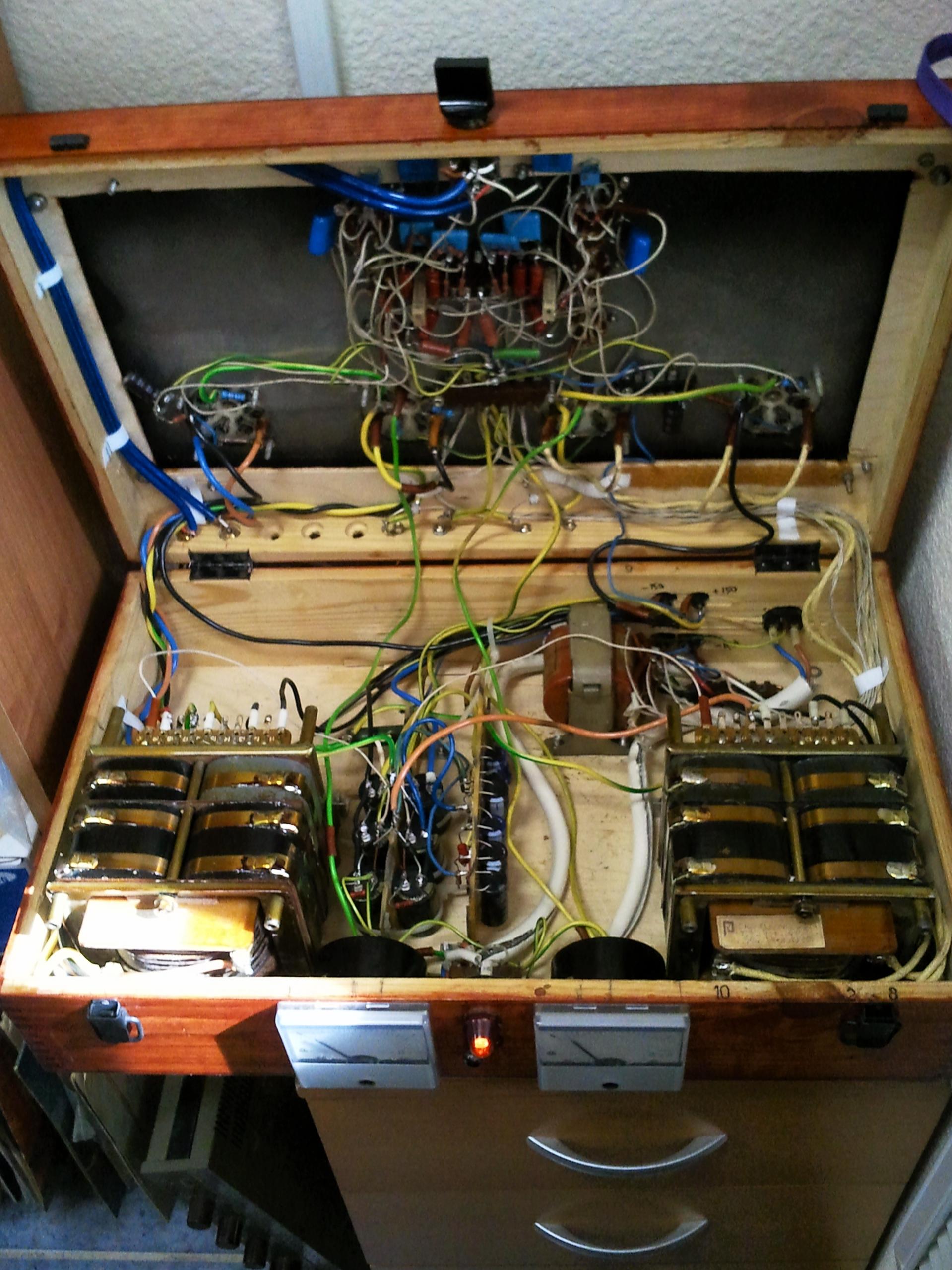

About Hum. Actually then I bild this type disine of body I am waiting for some Hum . But surprisely nothing scary. The trans plased not directly under tube . And quality the trans good(500 va each , grounding wire etc...no noisy ). I got them from poland CAMAK systems

Just remind: it was problem with zeroo reg. on one side my OTL
I check value resistors R8 R9 it was not correct 4,8 m (more) I change both of them and now zerro ok.

I made a few measurements this last weekend, to try to estimate the hum level. On my Hans Beijner OTL, which is a bit lacking in smoothing capacity on the main supplies, I measured a ripple of about 1.25V peak to trough. On the output to the speaker, this was leading to about 12mV mains ripple.
On my Tim Mellow OTL amp, I have about 0.5V peak to trough ripple on the B+ and B_- supplies to the output tubes. There was no detectable ripple signal on the speaker outputs, even on the 2mV/div scale on the oscilloscope. So hum on the output, which was inaudible by listening on the speakers, is indeed unmeasurable on the scope also.
My conclusion is that the simplest of power supplies, provided that the capacitors are reasonably big (4,400uF in my Tim Mellow amp), is more than adequate. Hum is simply not an issue.
