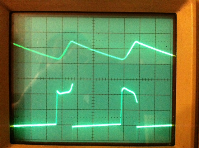

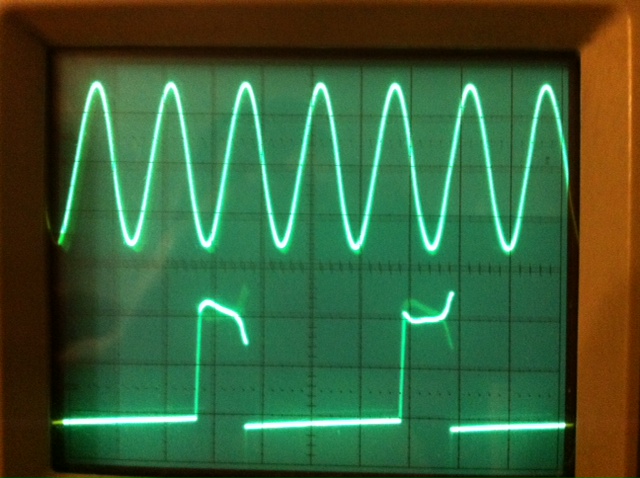

Yes, absolutely. Here are two photos showing what I am talking about. In the first photo, the upper trace is the audio output signal, and the lower trace is the signal on the centre-tap of the transformer (with 82 ohm resistor to ground). Both are 2V/div. There is no sign of the audio signal on the transformer centre-tap.
In the second photo, the upper trace is showing the voltage on the +160V line, showing how it decays (by about 1.3V) during each half cycle of the mains frequency, and then rapidly recharges. The lower trace is again the voltage on the transformer centre tap, illustrating how the ugly pulse correlates with the recharging phase.
Chris
Chris
Very interesting,
It would be interesting to see a trace of center point of caps with and without CT. Then a duel trace of CT connected each side of R33.
The traces you show don't even show a significant modulation from the audio out which would seem to say that the caps are in circuit for both situations, this would not account for the change in sound...except that the charge pulse " is ?" present at the cap Center point?
Regards
M. Gregg

Yes, the power supply capacitors are in the signal path equally much in either case. Also, it is obvious that there must be a "flatlining" of the signal on the centre tap for most of the mains frequency cycle (as is very clear in the traces), since for most of the mains cycle the output voltage from the power transformer is less than the DC voltages across the capacitors, the rectifier diodes are then completely non-conducting, and so the "hot" ends of the power transformer secondary are effectively completely isolated. Clearly, therefore, no current can flow out from the centre-tap during the majority of the mains cycle. This is one way to see why the centre-tap cannot possibly have a clean copy of the audio signal on it.
By the way, I suspect that the reason why in my traces the signal on the centre tap is a definite upward pulse is because of an imbalance between the capacitance of the B+ capacitors and the capacitance of the B- capacitors. (Electrolytic capacitors are notoriously imprecise in their tolerances.) I'll try to check this when I get the chance. I suspect that if I add a bit more capacitance to the one that is at present smaller, then the height of the pulse should reduce, and it should be possible to make it become instead a negative pulse if enough capacitance is added. If this is right, then it would seem that if one is going to have a non-zero R33 then it would be good to "pad" the smaller capacity bank so as to balance it with the other bank. I'll report back after I get the chance to check this.

Seems now to be more likely the asymmetry (upward pulses on centre-tap rather than downward) might have a more mundane explanation; just an imbalance between the current draw on the upper and lower power supplies.
Chris
