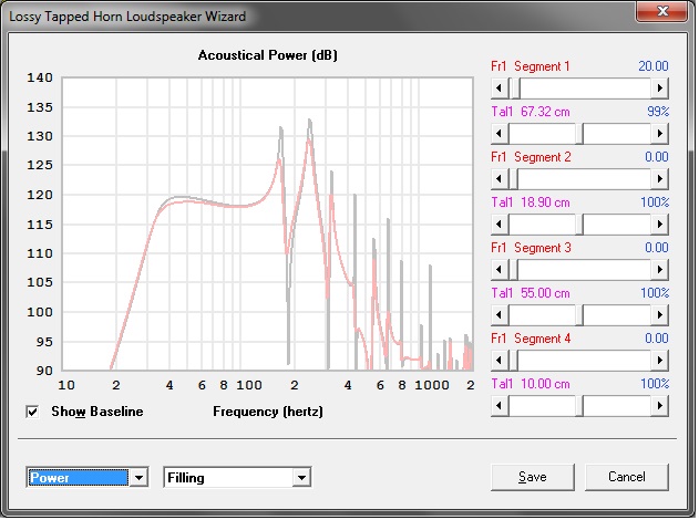

A while back I searched the interwebz high and low looking for different examples of what stuffing can do in a quarter wave pipe and generally what you find is what you would expect, but there was a couple of examples like that tapped pipe example that seemed out of the ordinary ....
There was another example of a TQWP or a voight pipe or some such thing which gained midband response (with stuffing) while the upper and lower ends of his usable response were smoothed and reduced a small amount, if i can find that graph i will post it ..
Referring to a question i brought up recently: The screenshot i attached to this post is what i think is roughly equivalent to Akabak's VISC=30 setting in the first section (S1) of an offset design like the Karlflex, i mentioned i would post something like this the other day and here it is, seems like HR's "Fr1" almost correlates to Akabak's "VISC" in this range , and i'm assuming that this setting is for simming a very light and loose stuffing of the entire first section ......
More densely packing the stuffing in the first 25% of S1 ( Fr1=520 and Tal1=25%) seems to work just as well in HR's Loudspeaker Wizard "filling"sim ....

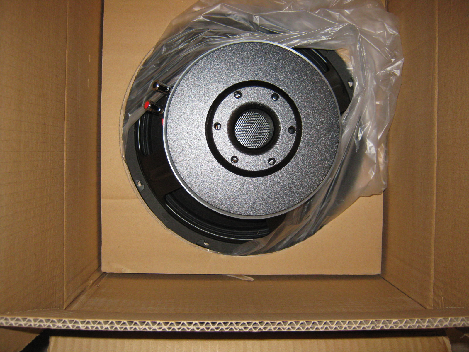

by the way , the Dayton drivers were delivered about an hour ago !!!:happy2:
I already opened the box and took a good look at them, they are kinda sexy ! Will post pictures here in a few minutes ...
Dayton PA-310s! SEXY !

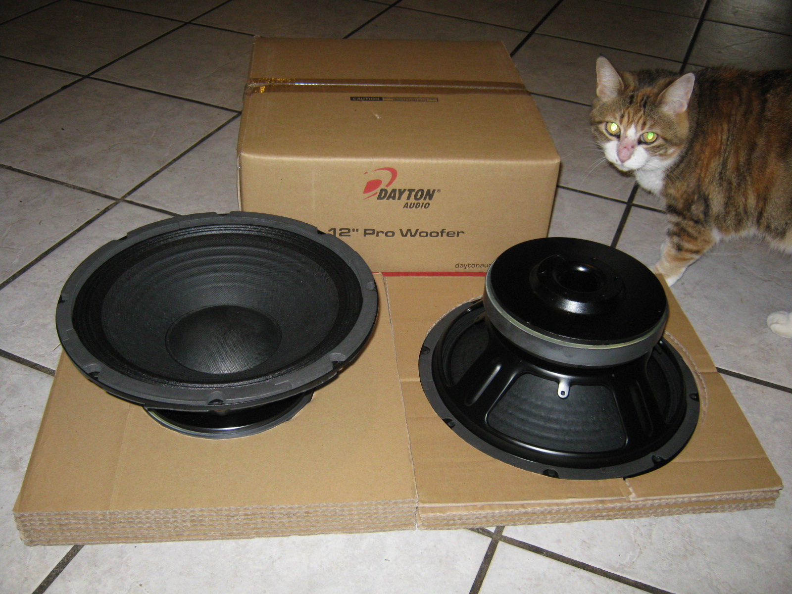

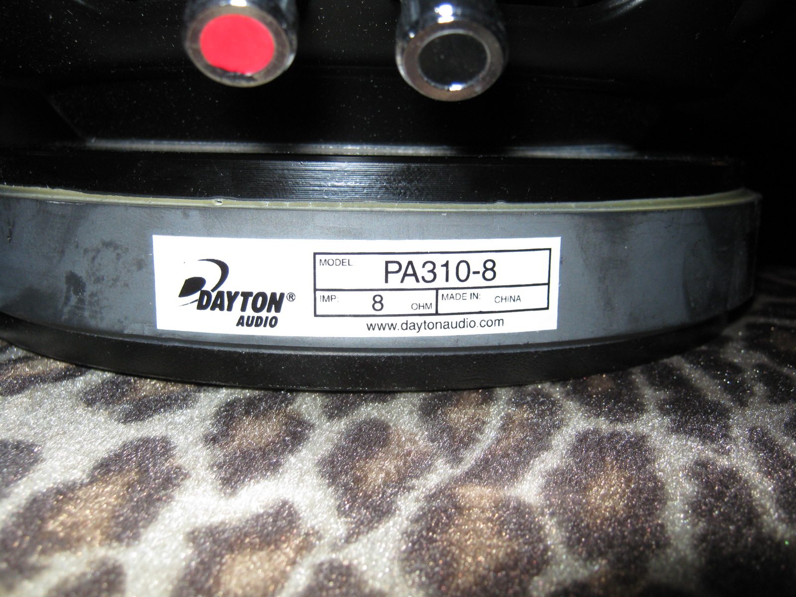

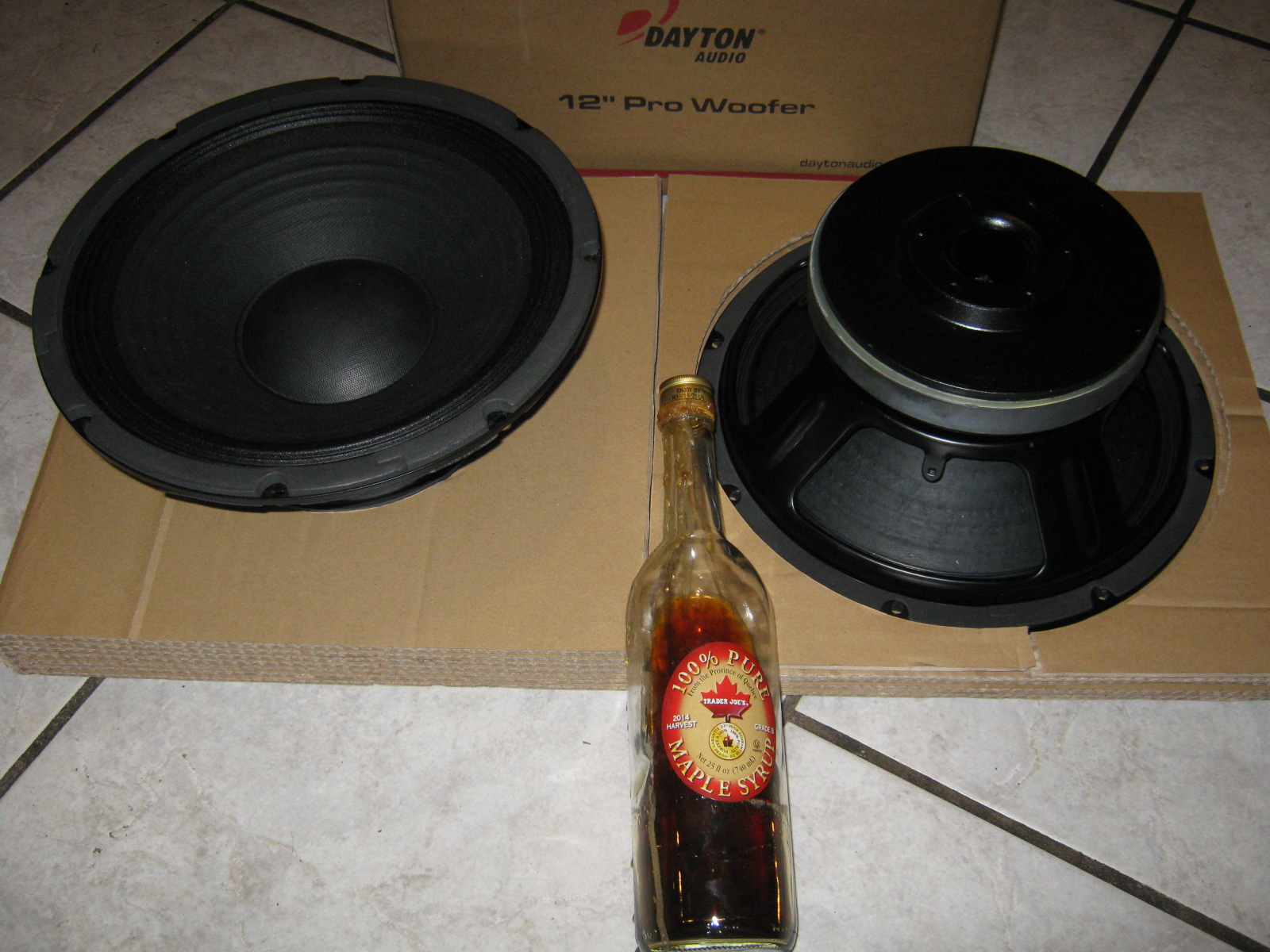

The new Dayton drivers have arrived ! :D

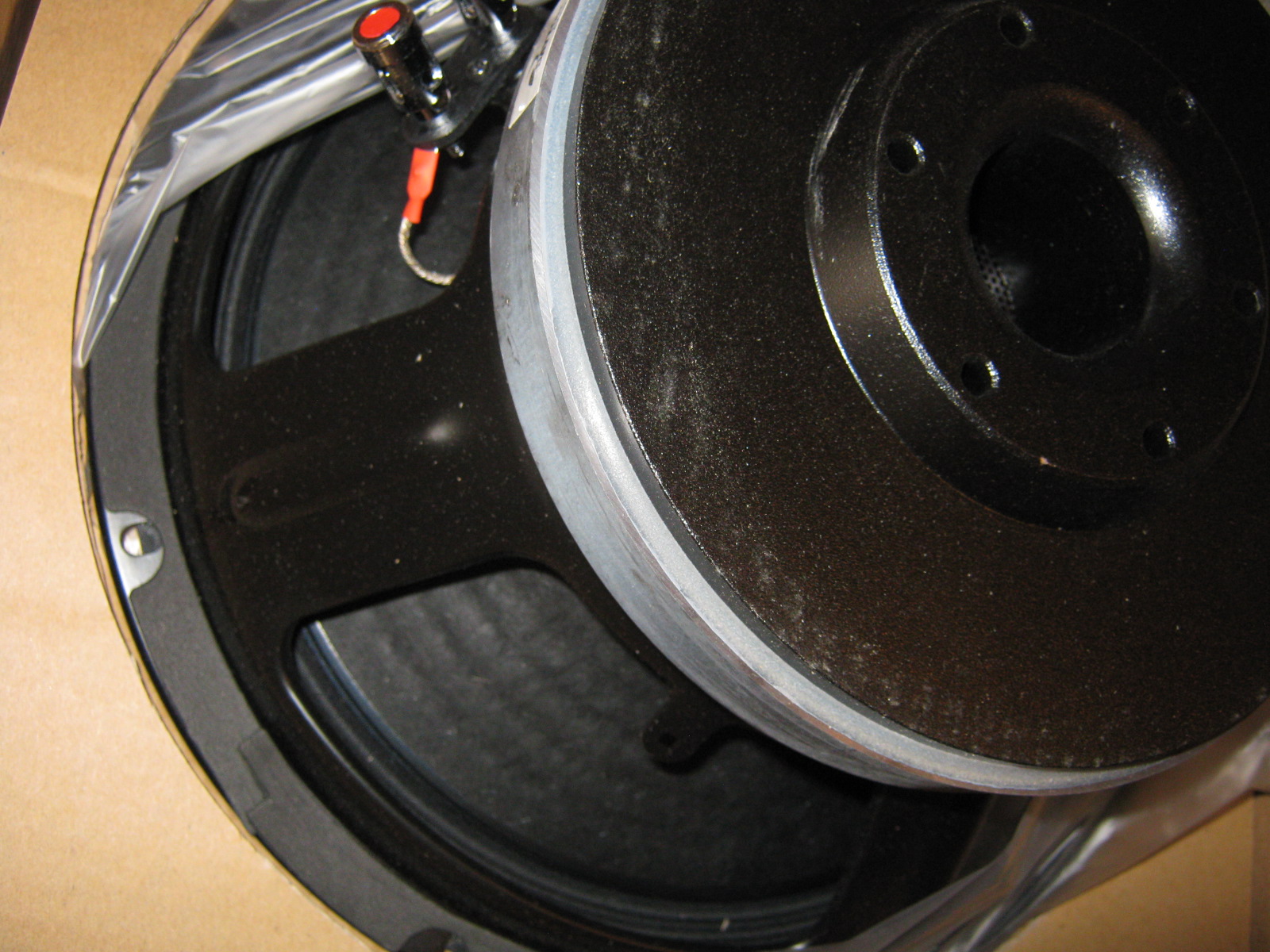

They were well packed, boxes within boxes, and they arrived in perfect shape, no shipping damage that i can see ...
Attractive looking drivers, well constructed, clean and precise application of glue, driver components look aligned accurately, these appear to be very professional for a budget driver....
These should excel in the midbass and midrange, im not expecting a tremendous amount of sub-bass out of these because they are limited by their xmax figure but in the right cabinet the output at 40hz-50hz should keep up with everything else as long as i don't drive them beyond their limits .... Perfect for the two little class-d amps i have set aside for the bottom end on my mini-pa system ...

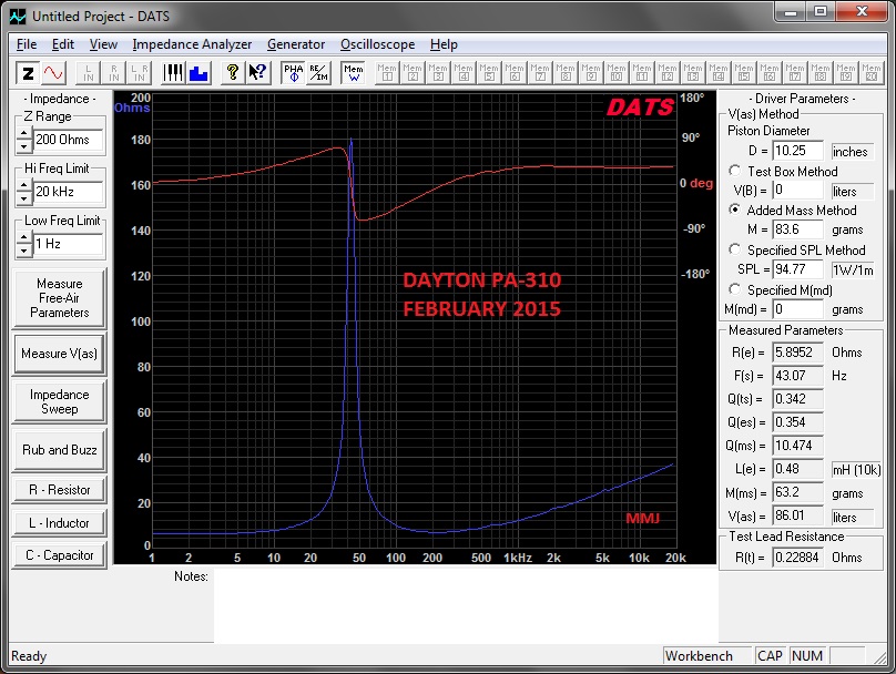

Just finished testing the new drivers with the DATS , will post the screenshots here in a moment ...:D
FRESHLY MEASURED T/S PARAMETERS FOR THE DAYTON PA-310
These Dayton PA-310 drivers measure close enough to what they publish, however i really do like the marginally higher QMS figure :D
:checked:
I just tested them with the DATS unit (not the current model , it is the first generation DATS but it works)
Behold the screenshots!
:happy2:
