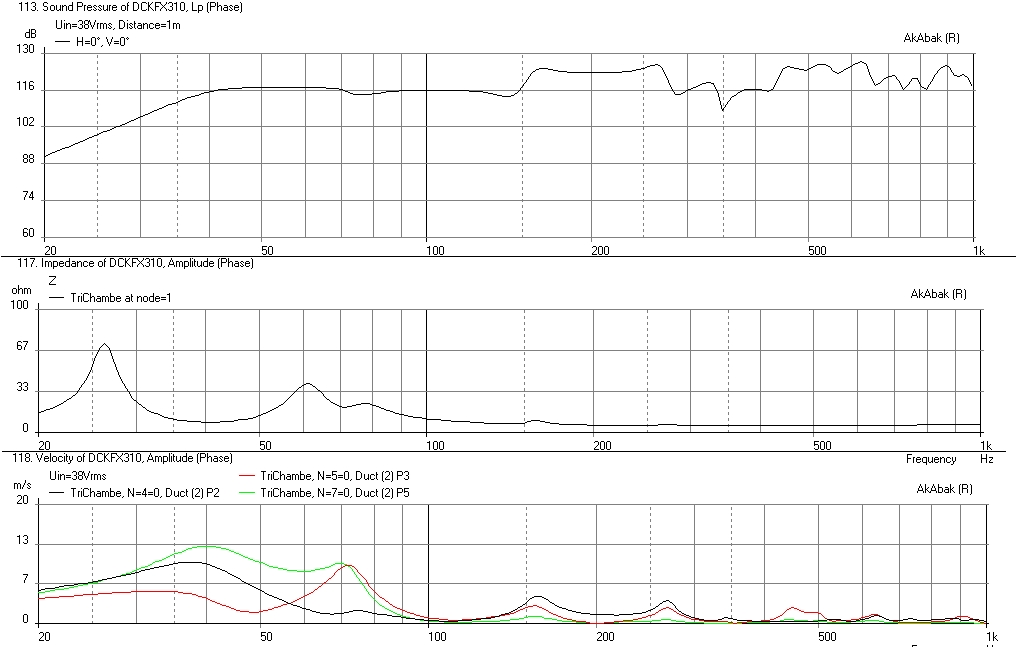

Ok ,

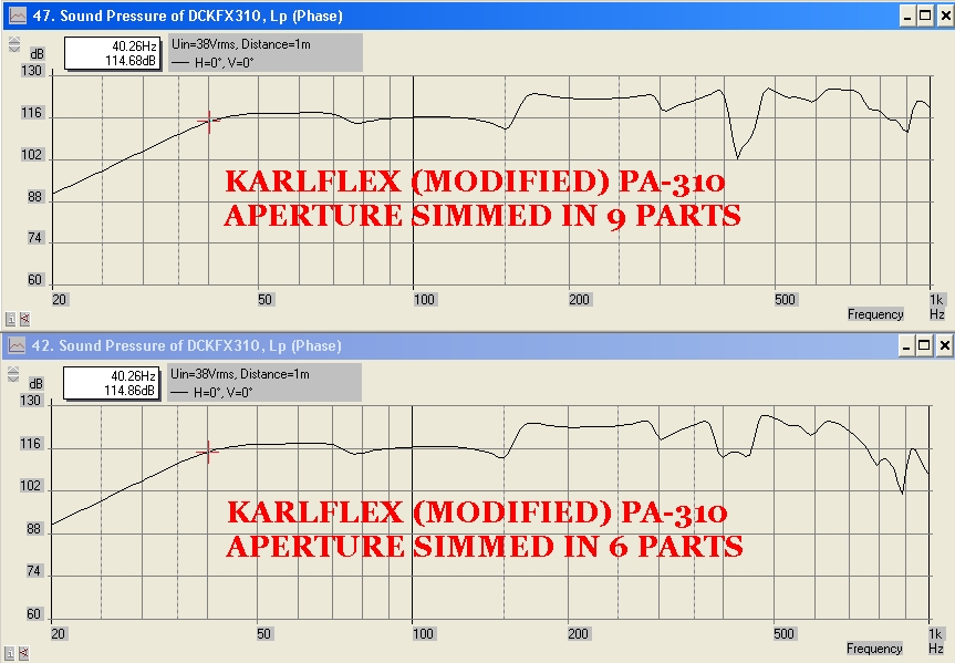

The K-aperture is in 9 parts now (9 is the minimum suggested by X), and i have them all spaced evenly ....
However, since i wanted to sim the Aperture at 60cm tall i had to divide 60 by 9 to derive the length of each part which gives me 6.66 !! Then, in order to get my coordinate placements i took 30 and divided it by 4.5 which also gives me 6.66 !!
XRK's new name is going to have to be HexRk971 !!
hehehehe
Will this speaker produce dark undertones?
Ok , now seriously , superstitious inSINuations aside
Here are the results , looks great except for the dip at 420hz ....... Needs more 420 ! .... Other than that it looks great! I still need to add the code to build out the front chamber properly and then i would imagine that the response will end up looking different than what we see here ...

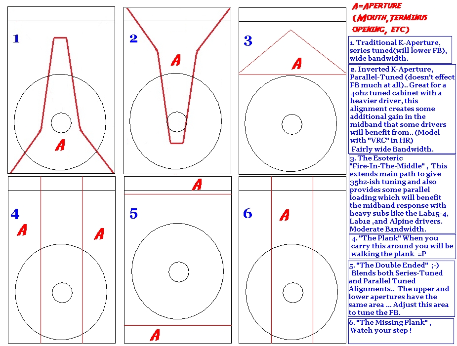

Nice work! I think you are the first to fully understand how I implemented a K-aperture as a series of variable sized radiators in Akabak. Are you using rectangular vent apertures or round with CSA proportional to area of rectangle? I used the rectangular ducts and radiators.
Isn't it neat that the K aperture makes the bandwidth go from 40Hz to 400Hz?

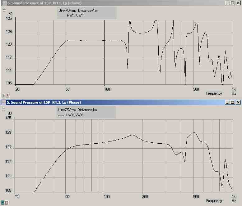

You have come a long way from this:
To this:
A work in progress
Thank you ! , and yessir , i think TB has a pretty good grasp of it too, in fact i think he might be a little bit ahead of me on this , i am still catching up .....
The PA-310 has the right qualities to allow a lot of upper bandwidth when loaded into one of these series tuned 6th order K boxes ...OTOH a real sub like the LAB15-4 or Alpine SWS driver won't reach as high but will create some highly respectable bass output...
I used round ducts in this sim with proportionate diameter ..... This sim (that produced the above graphs) is also a Karlflex with a twist borrowing the parasitic chamber/resonator concept from a DCR cabinet (notice the little dip at 76hz) ... Since the Karlflex already has dual chambers it would mean that adding one more makes this something like a Triple-Chamber-Karlflex or 3C-Karlflex or whatever we want to call it ..... This driver really needed better cone control since the PA310 is so excursion limited, and this was my solution ..... The box ends up being larger but i think it is a worthwhile compromise with this driver... At around 90 to 100 liters it seems to keep up with a 120 liter 40hz Tapped Horn using the same Dayton woofer with 1mm less cone movement at the same voltage drive .... The parasitic chamber requires some damping though in order to work well ... Once i have finished working through the details i will post more graphs and the script ..
The split path and extra chamber tends to ease particle velocity so that is an added bonus The impedance peak above FB also gets turned into two smaller peaks if the parasitic resonance is tuned properly ..

Hi MMJ,
Sounds like you are making progress. On the raditors and radiator ducts, I would go back to the rectangular openings, the way you are doing it they should all be the same height. Together w/ the coordinates that should be more accurate.
Looking forward to seeing this latest design stage.

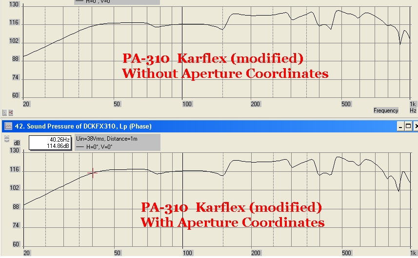

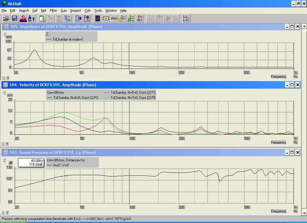

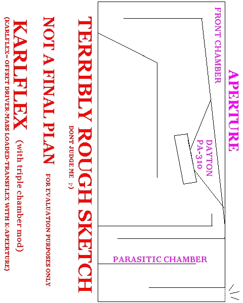

HOLY GOATS! I MADE A SCRIPT!
Ok Gentlemen, here we are ,
Project is moving along slowly but surely
This is the script for the Karlflex (triple chamber) which was modified to add a parasitic resonance around 75hz (like a DCR) which helps control excursion on this PA-310 (something the PA-310 really benefits from since it is a very capable driver electrically speaking but not physically capable in regards to linear cone travel) ..... This mod isn't necessary for many of the other drivers i would load into a Karlflex (only with lower xmax rated drivers like the PA-310) ......
*I have built out the front chamber properly (for a somewhat laid back baffle) ....
* I added height and width for all ducts (instead of diameter)
*This script also contains "Y" coordinates for the radiators ....
*K-aperture is split into 9 parts ..
* The Aperture's contour is currently questionable in this script and i may adjust it to better emulate a more traditional style Karlson contour ... Total CSA for this aperture is fairly large-ish at nearly twice the driver's SD ..
Despite this large CSA the aperture does tend to shift the FB down quite a bit , which is great news and helps to reveal our range of tunings ...
After the updates our notch in response has moved down to around 360hz , with some careful adjustment to the script i may be able to fill in that dip.
NOTE: depending on how i try to build the box i will likely replace this script's DUCT "P1" with two waveguides in order to follow the correct taper shape..
Just a couple of notes - as I mentioned, it's a lot easier if you start in Hornresp, let that generate the script, and finish in Akabak. Hornresp could have given you the first half of that box in about 3 minutes of work and you could have just exported and added to that. There's nothing wrong with writing the script from scratch in Akabak but there are several advantages to not doing that. Saves time, ensures accuracy (no schematic in Akabak), etc.
Second, there are 23 db between the lines in the sim you showed. Even a 10 db bump will look pretty smooth at that resolution. Within a sub's passband your response is fairly smooth anyway, there's nothing to hide, so it's common practice to zoom in to a higher resolution and show no more than 5 db between the lines like Hornresp. Some people zoom in closer than that even.
Not sure what nodes are what and I don't have time to figure it out. Did you check velocity at the pinch points? What's the velocity at the mouth?
I told you Akabak was the way to go for these things. There's really no way to get accurate sims of the stuff you want to do without it. (ABEC maybe but no other software can do these and guessing with Hornresp just doesn't cut it).
a tiny hop at best or maybe a slow shuffle =P
JAG,
Right , starting off with HR would be fast and effective, but in this case i just modified the heck out of (and built upon) a DCR script that someone posted elsewhere in some Akabak tutorial ...
I was attempting to fit three graphs onto a single easily viewable image without the need for scrolling , so that was the reason for the graph proportions , and right , not too much to hide there really, bandwidth looks pretty good out to at least 260hz , might even be useable to 330 .... I would like to improve the range between 300 and 400 , and mayhaps as i fix the contour of the aperture that will happen, but if not i am still happy with that sort of bandwidth from a 40hz tuned bandpass box
Yessir, take a look at the bottom graph from the attachment in post #1233 .... Those are the velocities from the points of greatest constriction in the cabinet , nothing exceeds 13 m/s at 38v ......Being set-up like a DCR gives this cabinet a split path, which can ease the air flow as part of the flow is directed through the parasitic chamber/radiator section........The velocity at the mouth is very low because the mouth's area is even larger than the driver's SD .....
I am loving Akabak so far, i love the freedom if it, and the ability to basically add as many components as you will ever need and arrange them in any manner you like.
