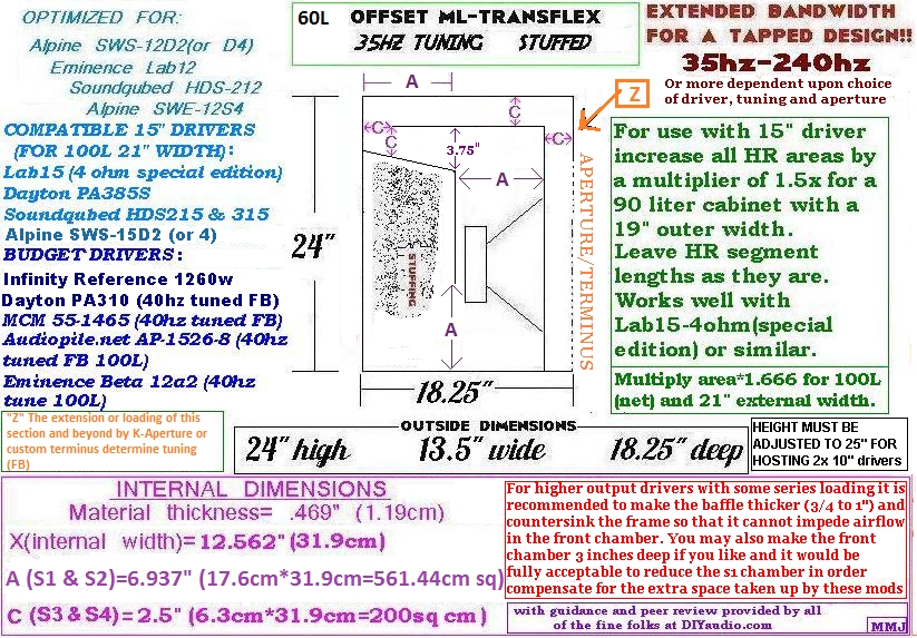

flare mod update
Here is a simple modification i will be working into the Karlflex design now ... The vent will now have an internal flare, and at the other end of the vent the aperture will constitute the external flare... This is done to further reduce any potential for velocity related issues ..
The mod will raise FB slightly but that is fine since this cabinet already had an abundance of path length and the FB is dialed-in with adjustments to the aperture anyhow ....

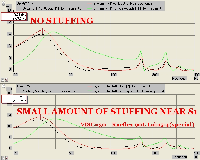

My first Akabak edit
Ok, excellent, I am still trying to figure out how to do a driver offset, I guess i would just have to put two segments end to end and stick the driver at the node in the middle right?? ...
I did a script edit just a moment ago by adding "visc" (stuffing/filling) to the ML-transflex's large throat chamber which is something that HR would never allow!
It looks like a small amount of stuffing near the closed end of the pipe has a very significant effect upon the particle velocity!! This is great to be able to verify this! (once again Hornresponse would not allow for it)...
It only requires moderate stuffing to make this happen and it is surprisingly effective at smoothing over and knocking down the velocity peak without sacrificing too much output on the bottom end due to losses...... Check it out for yourself .... I used a "visc" figure of 20 in the first segment (a very large throat chamber in this ML-TP case).... Combine that with a vent buried a few feet deep into the cabinet (like it is with the Karlflex) and velocity will end up being reduced quite a bit ...
Mostly what I do once I get to Akabak is copy and paste segments and do minor edits (like changing node numbers, lengths, volumes, etc). Very little actual writing of anything, just copy, paste, minor edit.

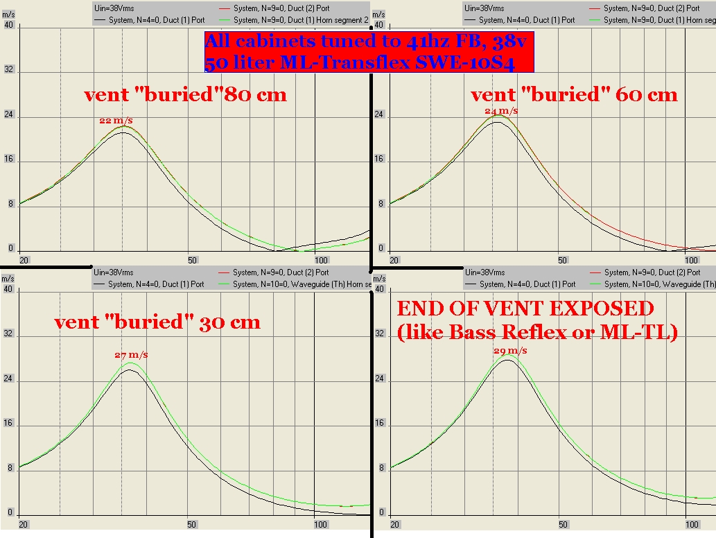

My very first Akabak screenshots posted on DIYaudio !
For anyone who is interested , these are the sorts of particle velocity reductions you can expect when the vent/duct (section with reduced CSA) is placed mid-path instead of at the end of the path ...... The graph screesnhots are without any stuffing/filling .......
To even FURTHER reduce the particle velocity peak near FB by 20% to 25% you can moderately stuff the S1 region("visc" figure of 20 to 50 in Akabak) (this method is especially fantastic for offset designs like the Karlflex)..
This is all now verified in Akabak
NOTE: Look closely at these velocity graphs, it is interesting that even though all of these examples are boxes tuned to 41hz the velocity peak shifts downward when the constriction is recessed further into the path! This means that your high pass filter will be able to more effectively reduce the particle velocity below FB ...
I also noticed during these tests (in both HR and Akabak) that as I was approaching 60cm (meaning distance to exit from vent, so this makes the vent recessed by a few feet in a cabinet that has a total path length of between 4 and 5 feet) i was getting close to a sweet spot in terms of bandwidth and phase response ... . I suspect that this may be similar to Brian Steele's DFD duct observation .....
This vent's "sweet spot" (if you can find it in other cabinets) will likely be determined by lots of various factors like tuning , total path length , expansion/taper and so on , in other words this "sweet spot" (once again, if it exists in your particular cabinet) will have a different placement for every design .........
yet another NOTE:
yet another NOTE:

Just a couple of notes. If you need to know how to do something in an Akabak script just let Hornresp do it for you. Import a Hornresp script with an offset driver and you can look through it and see how Hornresp did it.
Stuffing reduces velocity because it eats up bass. There's no free lunch. If you need stuffing to calm the response that's a valid use but I would never put it in just to reduce velocity. The high pass filter (if used) will do that.
In the latest design you posted, the aspect ratio of the line is not going to let the last portion of the line function as a useful part of the box. There's no radiation resistance at the beginning of the mouth and the air flow is free to escape into the room. To be clear, the line would effectively end at the point where I've drawn the red line. Not sure if that's how you simulated but I would guess no. I think a measurement would show that this line would act quite a bit shorter in reality than you think it is.

You might be surprised by this JAG, try it out for yourself, I am only getting 1db loss at FB yet a 15% reduction in velocity! This is with only a dash of stuffing in the S1 region of an offset design.... In this case it is a rather small box with a large high xmax driver loaded into it with no ringing peak to speak of at FB (with this particular combination) to begin with but there is some ripple towards the top end of this box's usable range which is what many folks would be attempting to smooth out with stuffing .... The thing is, the very small amount of stuffing i used (visc=30) did not entirely smooth out the midbass ripple so some folks would be using more stuffing than this to accomplish a smoother upper end and would consequently get even more reduction in velocity (more than the 15% you see here) ....
My point is that i think the stuffing is a good deal for all of it's benefits such as the lowered velocity (with the peak also shifted down in frequency) , lowered excursion hump (by 1.25mm) , improved group delay , smoother phase response , not to mention smoother frequency response of course ....... You get quite a lot in return for your 1db loss! So yes , there is no free lunch but this looks like a feast for pocket change!
Question is how much stuffing is Akabak's "VISC=30" ???

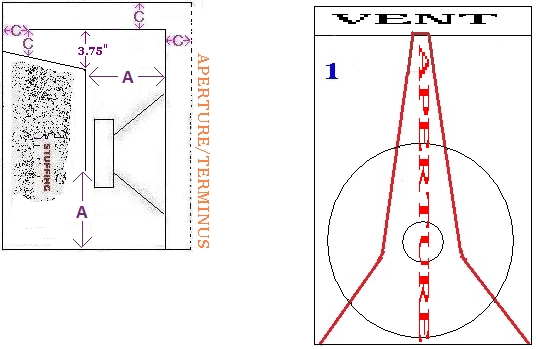

My suggestion would be to add stuffing to the S1 region chamber until there is 1db loss at FB ..
There is a K-aperture in place of the perforated line that you see in that sketch, the aperture could start even higher up and extend for the entire front face of the box , i just wasn't able to draw the aperture because of the side view orientation used in the sketch.... Using the classic K-aperture (Type #1 in the aperture options sketch that i posted recently , it is series tuned) we have a small gap or slit at the top which opens up to a mouth at the bottom, and this shape constitutes a flare with radiation resistance ... It is a very space efficient way to achieve a flared section in a scenario like this ....
Karlson also used a similar concept with a slit tube in other designs .... Karlson enthusiasts swear by the technology, but his following is by no means a cult made up of mindless zombies, on the contrary people like his stuff for a reason (because the designs work) ... His ideas may be out-of-the-box but at least some of his ideas (if not all) are valid...
You can add stuffing in Akabak using the damping term and set damping as pressure loss in Pascal per unit area per distance (m^3). I find 5000 to 7500 Pa/m^3 corresponds well to typical polyfill stuffing. You can also look up tabulated pressure loss values for mesh screen and use mesh as well.
I don't know, you could probably correlate it to stuffing in Hornresp and get a decent answer. I don't use stuffing in Akabak. The designs I usually use Akabak for generally don't need or benefit from stuffing. For stuff that Hornresp can't do I use MJK's software for ported and mltl and tl designs, and Akabak for horns, which don't need or benefit from stuffing.

There is a K-aperture in place of the perforated line that you see in that sketch ...
Ok, I didn't see that because it wasn't in the pic. The k mouth will provide more radiation resistance, but it really should be simulated accurately, the way XRK does it, with a series of little side by side mouths increasing in size to approximate the shape of the actual hole. If you just sim it as a big circle at the end of the line the response won't be predicted accurately.
Thats true, i can emulate it in Loudspeaker Wizard, i will post a screenshot ....
