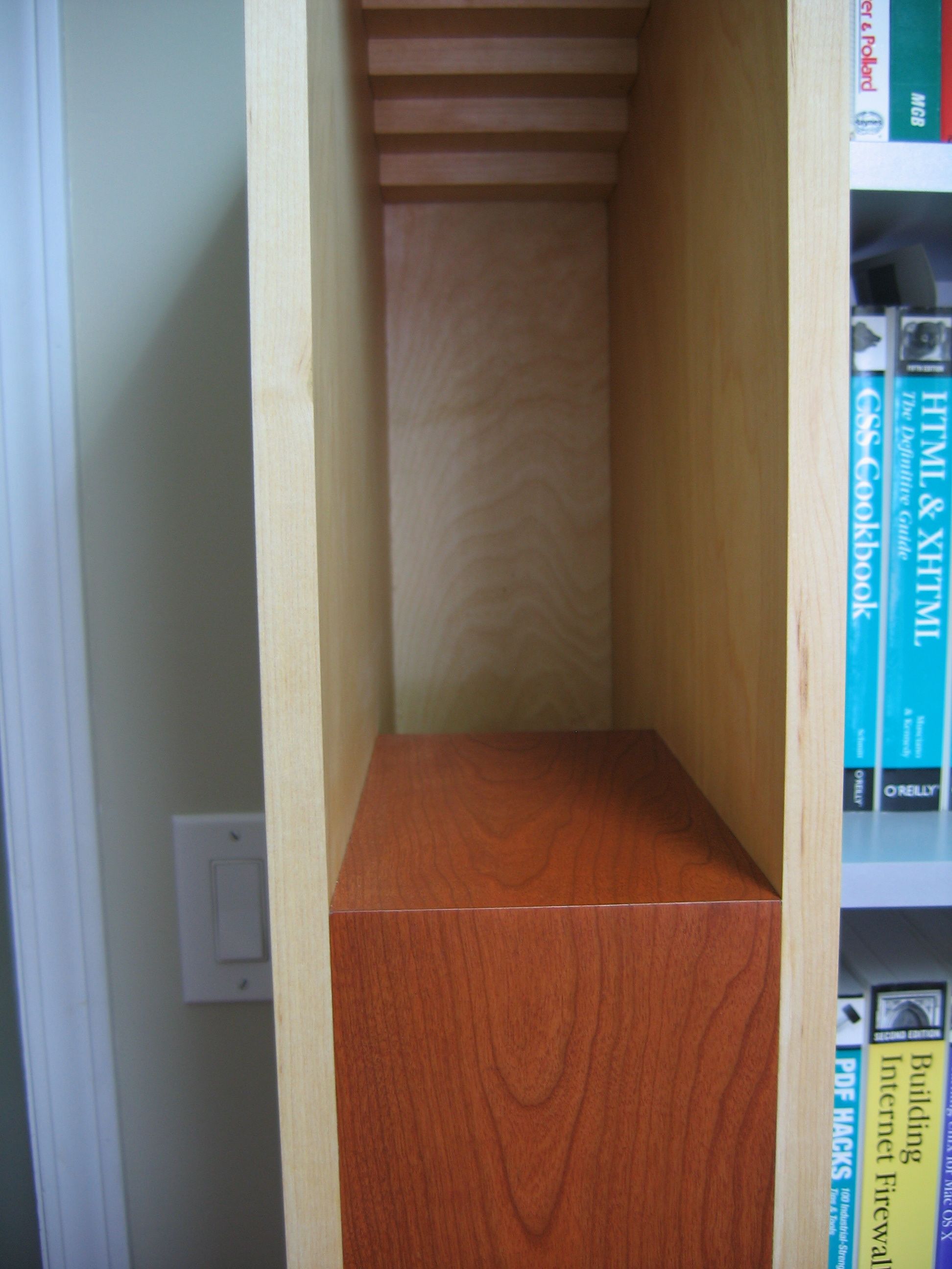

I finished my Saburos in Danish Oil as follows:
1) Sand with 220 grit paper
2) Seal coat with a 50% mix of wax free shellac and denatured alcohol
3) Lightly sand with 350 paper
4) Apply first coat of oil as per instructions. I used Deft oil which allowed me to recoat in 3 hours
5) Apply second coat of oil sanding with 400 wet/dry sand paper. Be very careful if sanding on stained wood as you can sand through the stain. If you want it even smoother you can do a third coat sanding with 600 grit.
6) Wait about 24 hours and apply funiture wax.
The finish is smoother than I ever achived with varathane and sanding, took way less time to finish, and no dust and flies in the finish :) I don't have a spray booth otherwise I would probably have sprayed with lacquer as recommended by Chris.
You definitely want to do the sealer on birch otherwise you will get blotching. If you're staining, then you want to apply the sealer before staining. The attached picture shows the saburo with stained cherry veneer on the baffle. It was sealed, stained, oiled, and waxed as per above.

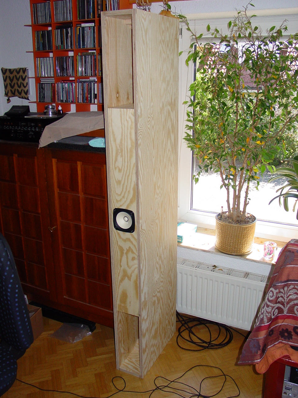

Mine are making the finest music reproduction I've ever heard, but haven't got a finish yet...
I encourage everybody to do the job!!! To me they sound more balanced than the Sachikos I build last year...
Pine tree 18mm plywood
Definetly it doesnt matter if you use 19mm or 18mm... you just have to adjust the inner "wood maze" to the right proportions...

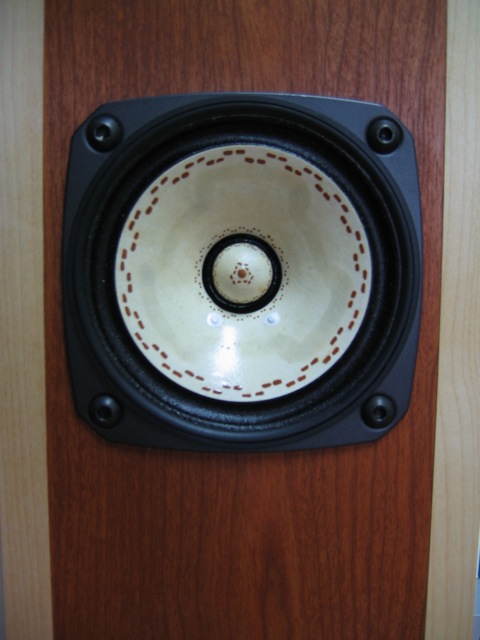

I have been playing my Saburos with Planet10 EnABLed FE126eN drivers for about a month. It took the drivers quite awhile to break in, and they are probably still not completely broken in, but the sound just keeps getting better and better. About a week ago I switched from a SS amp to my newly built SimpleSE tube amp. I was very surprised how much difference this made to the dynamics and sound stage of the music.
Attached is an image of one of Dave's EnABLed drivers in my Saburos. Sorry for the picture quality.
