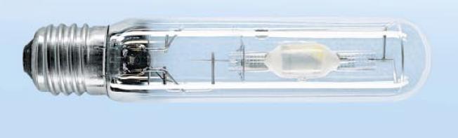

Bangalore Metal halide dealer
I have bought the metal halides and ballast for my projector. The specifications are below.
Lamp model no :OSRAM HQI-T 250/D
Lamp wattage :250 W
Luminous flux :20000 lm
Luminous efficacy :80 lm/W
Colour temperature:5300 K
Colour rendering :1A (greater than 90)
Base :E40
Length l : 225 mm
Outer diameter : 46 mm
Price for the Lamp was 800Rs
Original Osram ballast for 250 w lamp costs 1450 Rs.

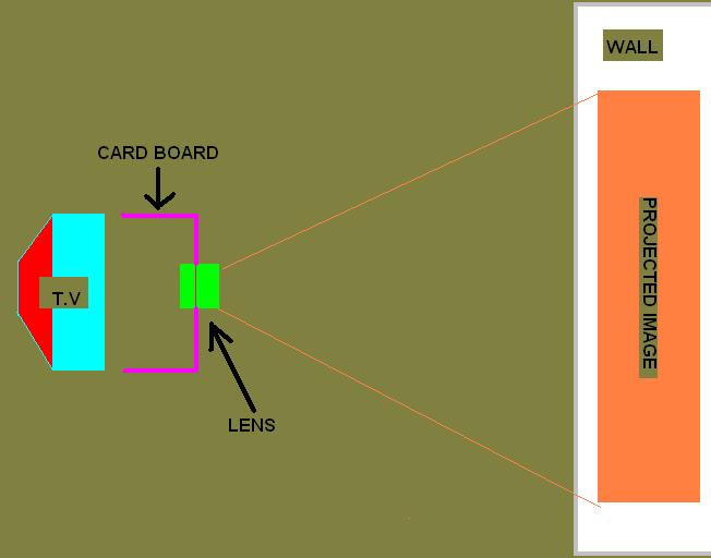

I am going in for my first projector.
will be using LEDs as light source(don't know how well it will work but want to experiment). will be using a panel with 100 LEDs with each giving out 50000 mcds right behind the LCD screen.
will use 6" LCD screen.
slightly confused about lenses.
does anyone know where to get TV projection lens from?
a probably stupid question:
can a camera lens be used as a projector lens? a lens with 85mm focal length and f1.8 speed?I am a doctor & almost zero at optics. what i thought was that only direction of light will change as compared to camera. rather than gatherintg light from wide field and concentrating it on photo film, the lens should gather light from LCD and transmit to a broad field.

One easy way to validate the lens is by projecting the image from a T.V on to a wall. You can do this by taking a card board sheet / box as big as the T.V screen. Fit in the lens in the center of the card board.The tv should be roughly 6 feet away from the wall.Now put the lens & card board device in front of the T.V with around 1 feet between the them.Adjust ast the distance till you get a clear image projected on the wall.When you get the sharpest image measure the distance between the lens and the T.V that will be the focal distance of the lens.
I have attached an image showing how to do it.If there is no projected image it is very probable that your lens wont work.
