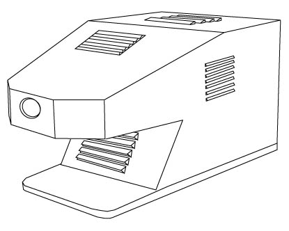

Hi Maks,
Sorry, I am keeping quiet for a long time. My attempts at carpentry failed miserably!, and so now I have entrusted the work to a carpenter. Hopefully the shell will be ready by this weekend, and hope to see some result by Monday or Tuesday. I will post the results as soon as possible.

pollok said:And this is the basic design of the shell
Man... this is Fundoo..!!! Nice design, Pollok.
Just a small suggestion.... try to keep those air-vents only on the rear, or at the most on the lower front and rear. Vents all over may spoil the looks.... and if the carpenter does a shabby work, then it is screwed.
Thanks Maks. I am going to conceal the air vents in black lining, so that it won't look ugly. And also, the vents at the front top are angled towards the rear end and those at the bottom are facing down.
Anyway, these plans have to work. If the carpenter screws up, then I'll be back in square one.
- Pollok

Gosh! It's happened again!! The carpenter brought back the plans and advance saying he could not do it!!! The measurements in cm and mm were too much for him, it seems. I think I'll have to settle for the normal box type PJ for now, and if and when I find a 'real' carpenter who can follow my plans, I will switch to the new one...
pollok said:Gosh! It's happened again!! The carpenter brought back the plans and advance saying he could not do it!!! The measurements in cm and mm were too much for him, it seems. I think I'll have to settle for the normal box type PJ for now, and if and when I find a 'real' carpenter who can follow my plans, I will switch to the new one...
Pollok, that's how these carpenter guyz are. I had a similar experience when I had designed my Speaker columns, and I had a tough time explaining the design to my carpenter. He took over a week just to understand the push-pull type design. Anyways... my suggestion is, just pick that saw and hammer and get on to it yourself... that's what I did. It's no good relying on these duds. Moreover, when you do it all by yourself you get a satisfaction of creation, even if it's a simple design.... and your PJ can truely be called a DIY Pj.
