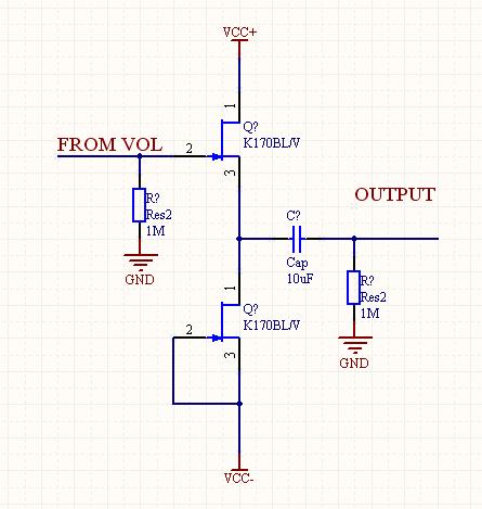

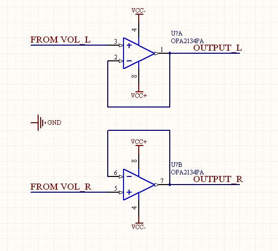

adamus said:I'll probably go for a buffer with this, but if not, what are the negatives to lowering the 10k output resistors?
Hi adamus,
You can add a simple buffer such as a OPA2134 or 2*K170. But if the impedance of your preamp/amplifier is higher than 50K,it's OK to use the VOL kit without buffer.

wirewiggler said:I just ordered one I plan using it with a
pass B1. I hope there is not a issue with impedance matching.
Bill
Hi wirewiggler,
I think there's no problem, please refer to the JFET BUFFER in my last post. Actually , the buffer is the same as B1 ^_^

I was looking at your drawing and figured it would work. I built a B1 and am using it with my tube amps and am quite pleased with it. I needed another preamp for my F5 and thought your controller with the B1 would be a nice combination. I plan to use the toolreg whenever they finish it up with the B1 as well.
Bill
Bill
wirewiggler said:I was looking at your drawing and figured it would work. I built a B1 and am using it with my tube amps and am quite pleased with it. I needed another preamp for my F5 and thought your controller with the B1 would be a nice combination. I plan to use the toolreg whenever they finish it up with the B1 as well.
Bill
Hi Bill,
This may help ^_^
regards
Lu

Hi rob,
Many thanks for your feedback.
The following step may help:
1. add two copper boards (for ex. two new pcbs) to the top and bottom side of the VOL main board, this may improve the shield condition. For the main board is not small, it may induct 50Hz interference from the human body and environment.
2.when you test the distortion, add a OPA2134 buffer such as I post before, that buffer has a low self distortion.
3. A low distortion signal generator is need ^_^
Thank you for your work again
best regards
Lu
