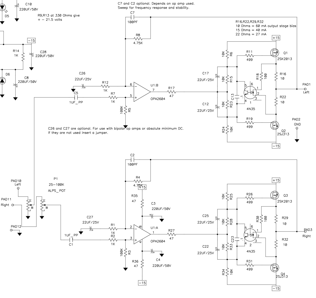

Can we use Fairchild FQP3N30 and FQP3P20 in place of Toshiba 2SJ313 and 2SK2013 for the outputs? The Toshibas are discontinued and difficult to get. Do the outputs need to be matched? I am thinking not.
