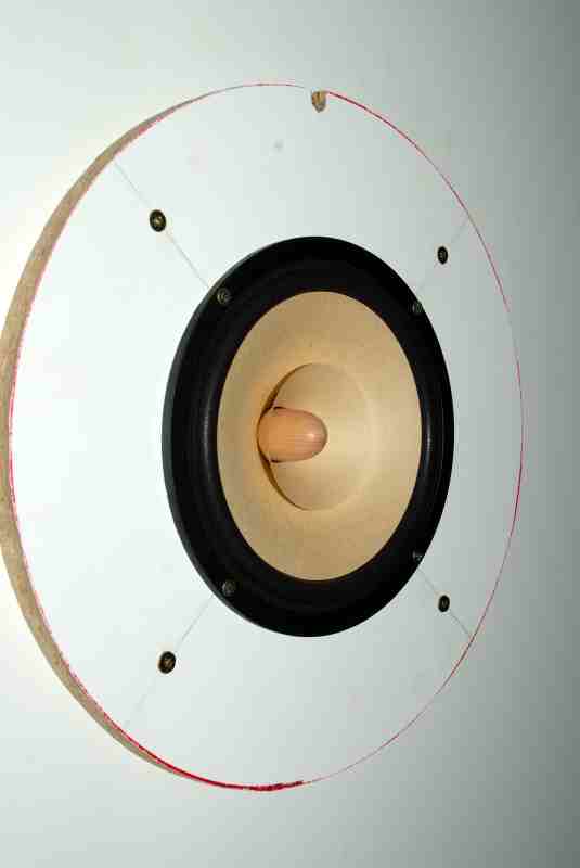

Hello NYCOne,
I have been perfectly pleased with these. The Fostex lives up to it's reputation: a bit forward at first, and then it breaks in and gives me a big smile. It's not overpowering the Alpha in the H-frame for me. However, I work in a concert hall, and I listen to mostly concert recordings, and in real life the bass frequencies aren't pumped up the way they are on the radio.
If you like a lot of bass, then I would recommend two Alpha 15 drivers per speaker, but I don't need that. I'm also running these off a little Onkyo TX8222, which only puts out ~40watts per ch. Get's plenty loud enough for me sitting 8ft away from them.
later,
G

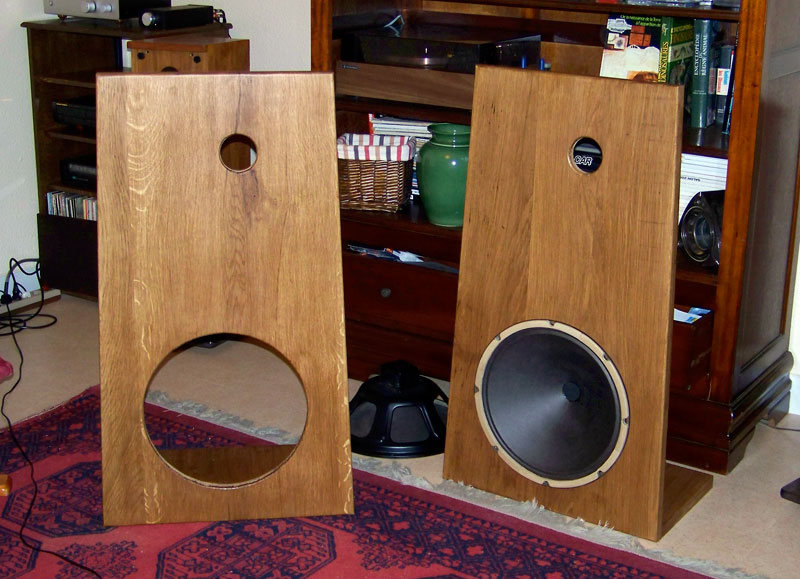

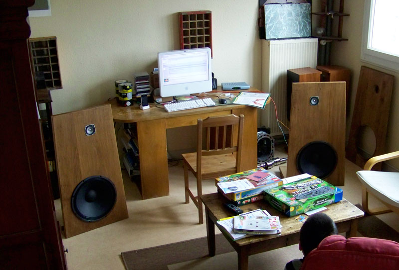

Hi fellows,
here is my attempt on Martin's smart OB. With a bit of Jim Shearer's style.
30mm oak baffle, they are lovely and heavy but as a friend has done it with my specs... on one baffle drawing, you can see the result. Saldy not both baffles... ='( I'm sad to death...
FF85WK are on their way from USA and I'll use old alnico 15" before I buy modern drivers.
No life! Lost to ne next crossroad...

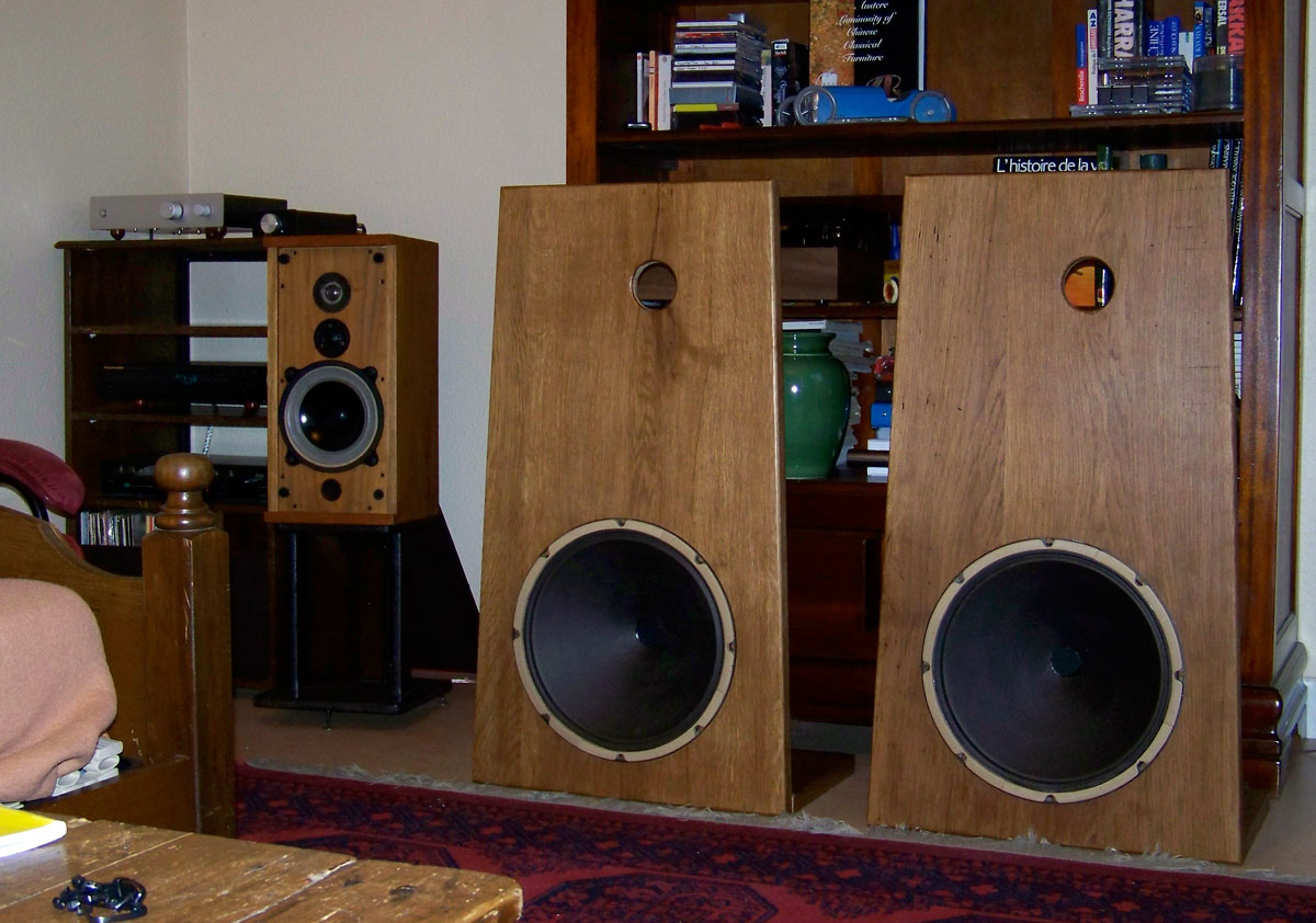

Hi there,
having done the XO, after a while of full range playing, and tunes are on.
I know my amp is not powerfull enough, on paper. Volume is more than needed, but no slam, no life, do power manly do handling more than volume?
I know ringings can happen, speakers, baffle, rooms... I have a bass frequency wich resonate like hell, the same in highs, a peak at something like 2K wich make some pipes notes ears killers.
Beside that great speakers have their fans pointing wich amp best matches that very speakers, but in a thread like this one it's almost the inverse, amps are not much in question, the flaws of the design yes... again, the amp is not to be chosen to match and are these statements done on sepcial "perfect" amps?
And what about room... endless quest ;)
