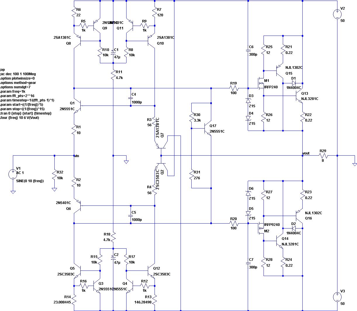

New Lineup IDEA - Power Follower/Output stage
Great jkuetemann.
If you go back to the beginning of this thread,
you see I use simple pair of IRFP240/IRF9240 for output.
The numbers were very good.
This circuit now shown to work good with following outputs
- pure MOSFET pair
- Lazy Cat BIGBT
- Triple darlington BJT
I must say it is a nice Power Buffer.
EVerything points this way.
Next I will go back to the MOSFET output, once again :)
The somewhat higher input impedance of the MOSFET Gates
is good for the results.
There is also higher voltage across the input transistors.
Like 4+4 Volt.

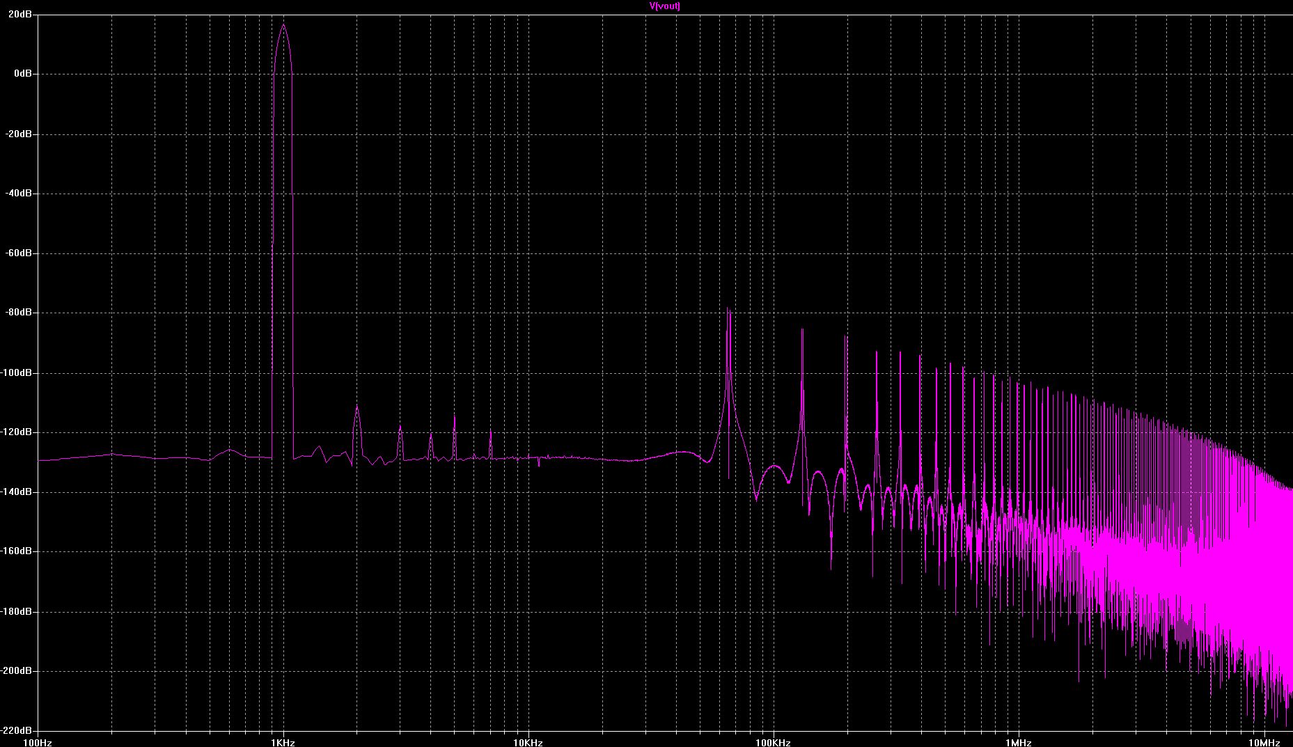

I spent some time playing with the lower CCS currents to get the circuit into a balanced condition (BTW, the input pair balance is very touchy and important for performance) and got some nice numbers. I'm wondering about some kind of current mirror with one leg reflected to the opposing rail for the front end to keep it well balanced. The diamond pair seems to be more important with respect to output offset and as such I think is best left adjustable. Currents were ~100mA through the BIGBT BJTs and 50mA through the MOSFET driver.

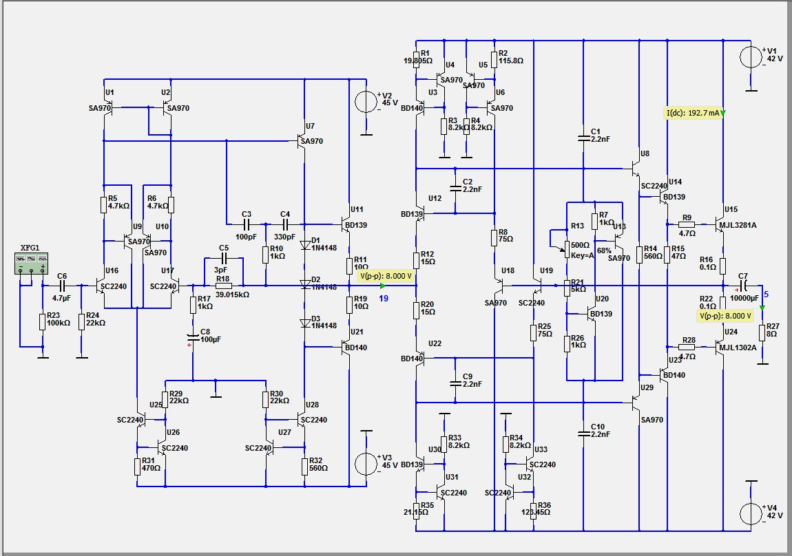

This is a Combined Voltage Amp Opamp
and
The Power Buffer.
The OPamp has got voltage feedback and TMC error correction.
It is rather precise.
The LU Power Buffer is one version with Triple EF.
The buffer and voltage amplifier work separately.
There is no global feedback.
These are the simulated THD figures
Combined VoltageAmpSC2240_1c PowerBuffer_6p
Power Supply is +/-42 Volts
THD 1kHz
04 Vp, 01 Watt THD 0.00016%
08 Vp, 04 Watt THD 0.00024%
12 Vp, 09 Watt THD 0.00034%
16 Vp, 16 Watt THD 0.00044%
20 Vp, 25 Watt THD 0.00054%
24 Vp, 36 Watt THD 0.00067%
28 Vp, 49 Watt THD 0.00080%
32 Vp, 64 Watt THD 0.00095%
36 Vp, 81 Watt THD 0.00115%
40 Vp,100 Watt THD 0.89761%
The mirror current source is a good idea.
The DC Offset should be solved some way.
If people see an Output cap,
they shake their head and go elssewhere.
Myself is not at all afraid of using Output capacitor. Say 10.000uF
When we use NPN + PNP MOSFET output pair
we can get offset like several 0.1 Volt.
Because one MOSFET can have 4.3 and another 4.5 VGS.
One idea is the let the frontend 10+10 Ohm be one trimpotentiometer.
A precision trimpotentiometer of 20 Ohm
and take the input through the wiper somewhere in middle.
This calls for having maybe 0.3+0.3 Volt across the input trimpot.
If this voltage is too low, then the adjustment may not be enough.
Those figures are dissapointing given the low THD from the buffer. Now try a straight forward Blameless amp and use TMC with it. It will result in much better figures.
Yes, I think the bottleneck is the driving circuit. About the buffer itself, it is a buffer, with normally low distortion. Now the question is, is the extra low distortion worth the extra complex buffer circuit. I mean, many other simpler buffers are low distortion, even if they are not super low.
Try to setup a diamond normal power buffer,
and you see what distortion figures you get.
That is what I call disappointing
:D
I agree with homemodder regarding a Blameless with negative feedback and TMC.
But then you have global negative feedback over your ears.
This buffer approach try to get away from GNFB.
And so, like Struth understands we get 2 distinct parts with only local feedback.

Whats wrong with GNFB ??
How can you define as being local feedback. Here you have two GNFB loops, Im not sure which is worse.

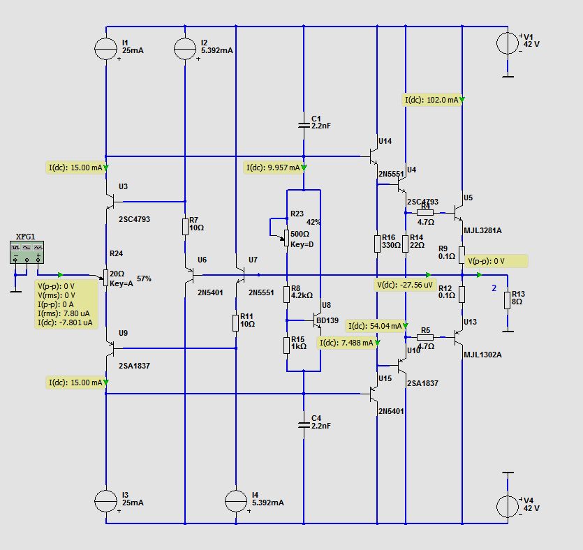

So far I have only tested this LU Power Buffer
with standard Class AB with bias set to 100mA in MJL3281A/1302A.
The use of these output devices is because I know I have good models.
I just tested THE BEST VERSION so far in my SPICE.
I was get stuck with THD 0.00016% at 1 Watt.
It seemed impossible to get lower.
The Cure was to change to other transistors.
I had used only BD139/140 and 2SC2240/SA970.
Now I use 2SC4793/SA1837 and 2N5551/5401.
Voila!!!
The nice numbers are almost frightening.
THD 0.00006% at 1 Watt
I show here the new and best version with new transistors.
Of all versions I prefer TRIPLE EF output.
Voila!!!
Bravo lineup :up:
The same THD number jkuetemann got in post #121 ;)
As homemodder said for unity gain buffer that's not so very surprising THD, as complete amp should incorporate voltage gain stage with its own anomalies to correct too. Try to sim something like global CFB symmetrical amp. Hopefully phase margin and OLG bandwidth will show us something special too. :cool:

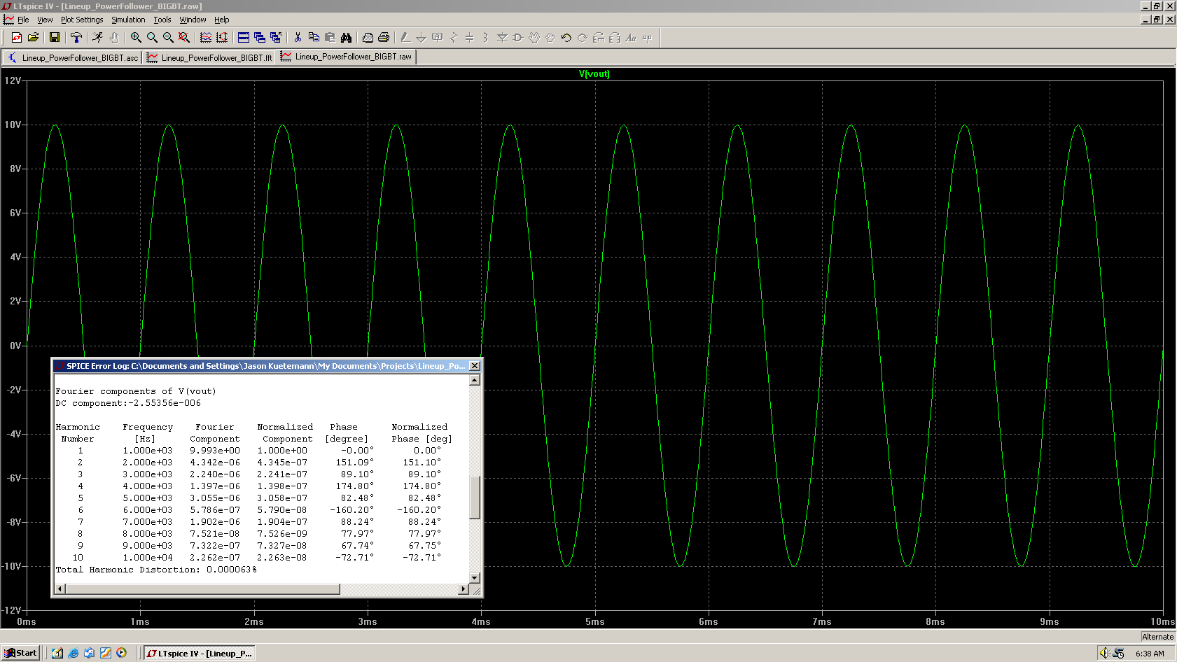

I did a 20kHz test. For 1, 4, 9 Watt so far.
The numbers are promising:
THD 20kHz
04 Vp, 01 Watt THD 0.00022%
08 Vp, 04 Watt THD 0.00072%
12 Vp, 09 Watt THD 0.00119%
Regarding how fast. The last version above is -3dB at well above 10 MHz.
So some little input filter is probably a good advice .......

The 2N5550/5400 pair have been industry standards since the late 1970s or early 1980s. They are used in many of the best production amps. Some details of their specs are unexciting but their linearity is excellent, producing a balanced distortion spectrum.
Most of the solid-state amps I've built in the past twenty years have been for guitar or bass. In that environment, and because I also use these BJTs in kits related to tube equipment, the high voltage capability of the MPSA42/92 is convenient. They have a pretty flat gain over a wide current range. Again they have some unspectacular characteristics, as well, but are also quite linear devices as Self demonstrated.
Since Toshiba introduced the 2SA1302/2SC3281 and 2SA1306/2SC3298 pairs, I have only used these and similar for hifi amps and drivers in guitar amps. Some of the latter had TO-3 devices since they were the fashion of the day and easy to acquire. Everything has gone to TO-247 and TO-264 for outputs now, which are a convenient package. It is a good thing that Motorola licensed the Japanese technology so they could improve their line of fairly good devices. The MJL21193/94 are pretty much MJ15024/25 die in a TO-3P case. The MJL1302A/3281A are renumbers 2SA/2SC to appease US buyers loath to buy foreign-numbered product.
I assumed you were using BDs instead of better devices out of convenience - you already them or you already had the sim models. It is no surprise that the numbers are better with the more linear devices.
Matching of devices will lower THD and help with DC offset. Device parameters and matching can be made less critical with emitter degeneration in place. The use of Rs instead of CSs pretty much eliminates DC offset based on current imbalance of the CSs and provides a very balanced rise/fall of supplies while maintaining low offset.
Leach suggested a GBW of 8-10MHz is a reasonable range for an amp to have low TIM and otherwise good performance. The LU buffer is in that ball park, so no need to try to make it faster as that is just asking for critical layout problems.
