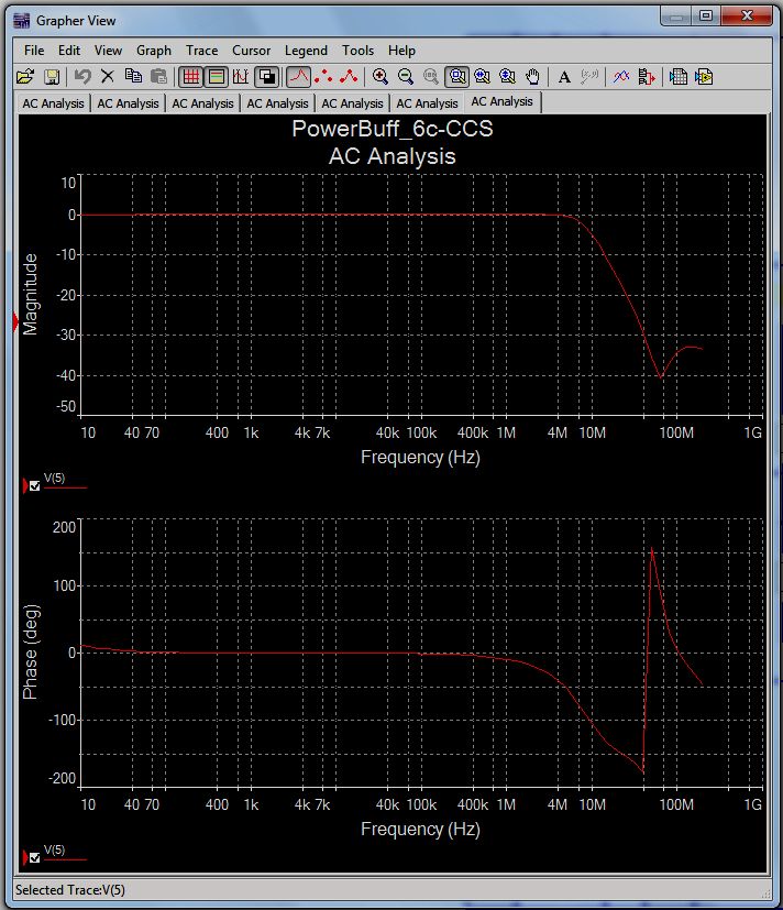

Now, this power follower circuit has an upper -3 dB at 8 MHz
as can be seen from the diagram I post here.
There is nothing bad about the behavior
This is done with two capacitors across the ouput.
They are chosen for stability: 1.2 nF each

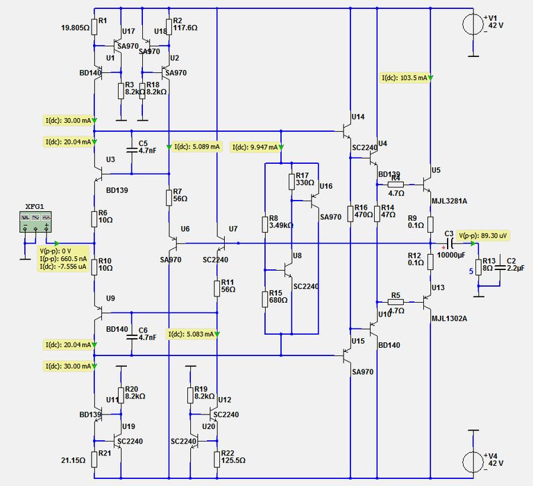

The NEW circuit can be seen in diagram 2.
The currents all are at idle. 100 mA quiescence current.
I be back with the THD figures of the circuit.

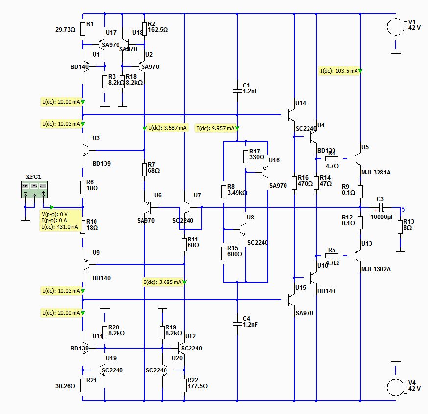

Here are the results.
Kevin, I must thank you for the suggestion with current sources.
I did not think they would improve so much.
But they did.
The figures at both 1 kHz and 20 kHz are absolutely fantastic.
Here you have it. The circuit can be found in my last post before
Power Supply +/-42 Volt, 8 Ohm load, 6c
THD 1kHz
04 Vp, 01 Watt THD 0.00006%
08 Vp, 04 Watt THD 0.00007%
12 Vp, 09 Watt THD 0.00007%
16 Vp, 16 Watt THD 0.00008%
20 Vp, 25 Watt THD 0.00008%
24 Vp, 36 Watt THD 0.00009%
28 Vp, 49 Watt THD 0.00010%
32 Vp, 64 Watt THD 0.00013%
36 Vp, 81 Watt THD 0.00017%
THD 20kHz
04 Vp, 01 Watt THD 0.00019%
08 Vp, 04 Watt THD 0.00040%
12 Vp, 09 Watt THD 0.00052%
16 Vp, 16 Watt THD 0.00057%
20 Vp, 25 Watt THD 0.00057%
24 Vp, 36 Watt THD 0.00058%
28 Vp, 49 Watt THD 0.00061%
32 Vp, 64 Watt THD 0.00063%
36 Vp, 81 Watt THD 0.00078%

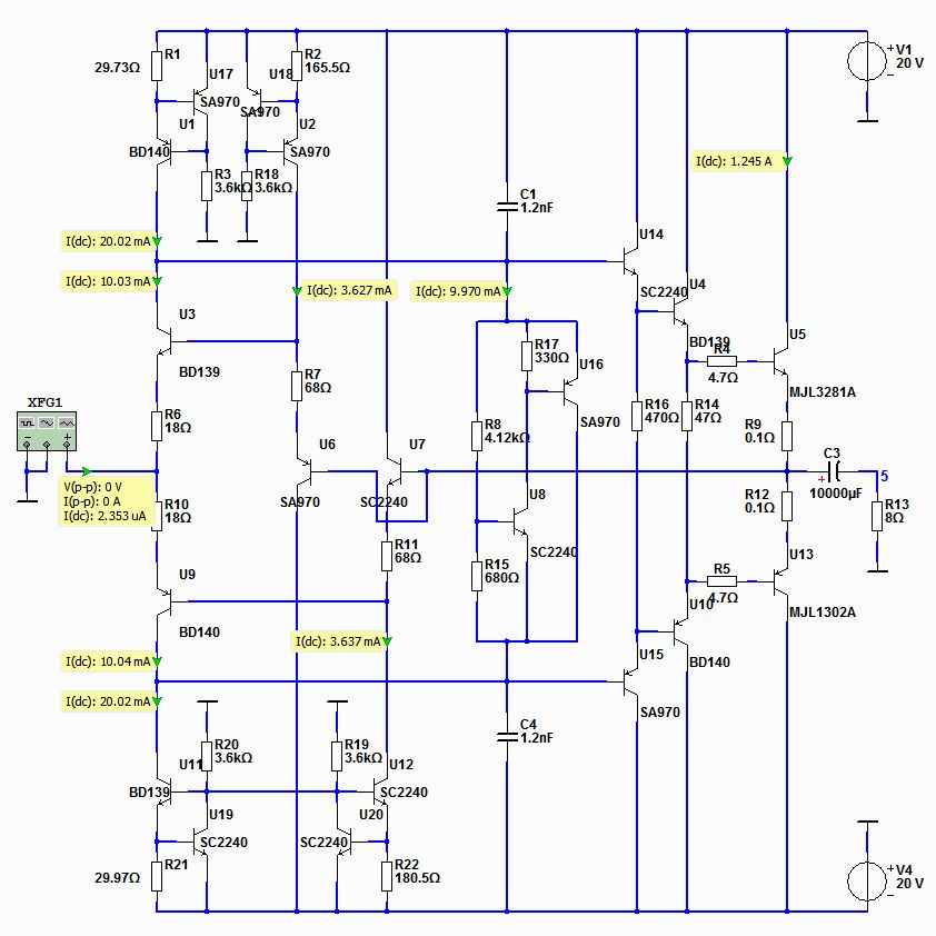

This is a version with +/- 20 Volts rails.
It runs in Class A with 1.245 A at idle.
The difference from my high power Class AB is minute.
I have not specially adjusted it for Class A operation.
Nevertheless it shows very good performance.
Here is the circuit and the THD figures at different levels - all in Class A.

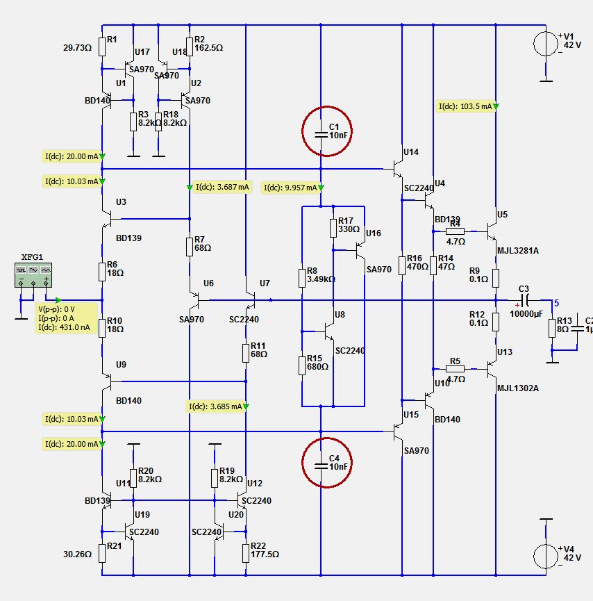

Hi Lineup,
I appreciate you work on this buffer, but have you checked it's behaviour on capacitive loads? Think that some unpleasant surprises are hiding there. As someone noted some more advanced compensation techniques should be used, or an output inductor.
I'm looking for a (near enough) perfect follower stage for an Aikido, hope that something along your idea could lead to that direction.
I thank you for your post.
To be capacitive stable is an important thing.
I have done some changes to my circuit.
It is now stable into 8 Ohm//1uF.
This was done changing the compensation caps, increasing them to make the amplifier slower.
Of course we can make the amplifier stable into 2.2uF,
but I think 1 uF is enough.
Here is the modified circuit.
Those caps are in red circles.
