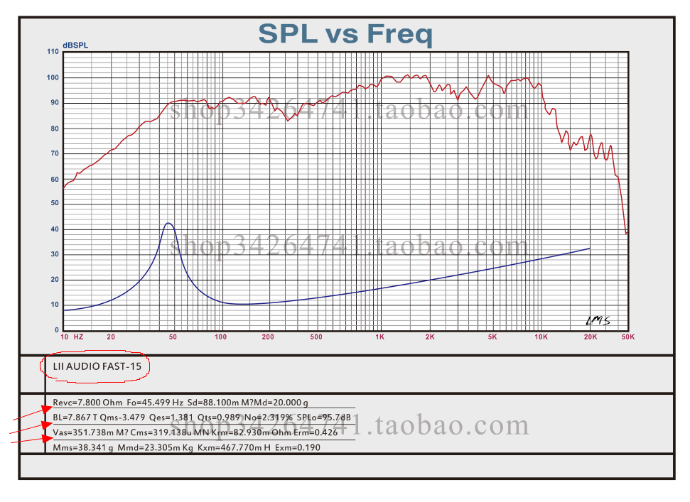

I guess no one has heard yet. Being watching their Taobao shop for a while and seems that they rapidly change models, it's either that they are too competent that can develop new models and obsole old within weeks, or they can't get a model that can constantly sell. From the look and SPL curve it seems the trumpet version of Fast-15 will be quite lacking high end but without hearing no one can tell. By the way their LMS interface is so funny, no curve illustration icon and the fonts looks greatly different than standard LMS software interface.

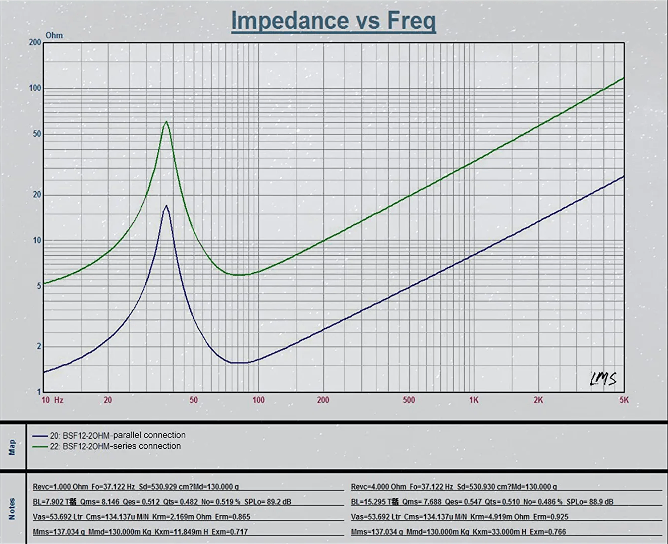

As reference this is what a standard LMS chart would look like:

quite orrible that's 18db 200 to 1k ,kaputt at 10k as always

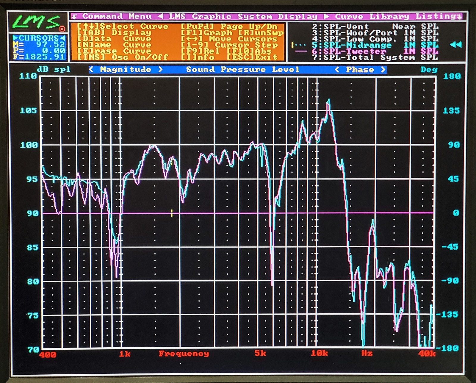

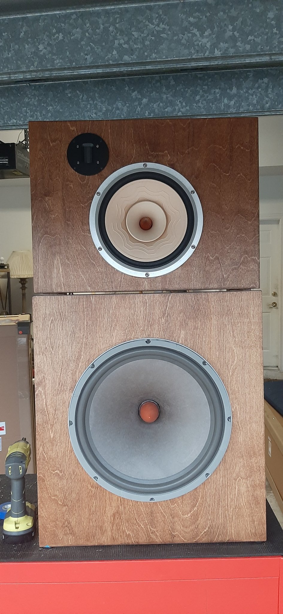

I know we're talking about the full-range 15", but I bought the SIlver-10 last year and it was nowhere near as linear as advertised. I was building the Lionidas and is was awful as sold. My speaker builder added a tweeter to fill in the 6-7khz dropoff. It made the overall response smoother but it became a very expensive project and sort of defeated the purpose of using a full-range driver.

Maybe. I have no inherent bias one way or the other. I bought them. I wanted them to be awesome. They were not.
I heard them installed in my baffle before the builder showed me the plot. They sound like they graph. They are recessed in the presence range and are done by about 13k. The other driver measured the same.
Someone on another board suggested I use the Lii xovers that came with the drivers (for the lionidias build) rather than different ones I had someone build for me. Uggh. Everything was much worse. My builder did what he could to compensate for the driver performance when he designed the crossover. FWIW, the 15" woofer sounds and measures pretty good.
I have lots of gear at home, 300B amps, 211s, 845s, 71A, 300W SS monoblocks, multiple DHT preamps, expensive speakers, etc. There was just nothing I could do, no equipment I could use to make it sound good as a 2-way. It sounds pretty nice now as a 3-way with the Fountek tweeter, but that defeats the purpose of buying a full range driver. C'est la vie.

ug.
Are those stiffening ribs on the cone ?
I assume the dip at 5khz is the antiphase from the whizzer.
I think bob brines mentions that on a dip up there on 8" drivers is due to the whizzer, it's a little higher in frequency (smaller whizzer, different frequency ?) that the 10" you have.
A dip at 5khz, not sure I'd hear that.
A peak at 6khz added clang to cymbals, but wasn't offensive on TB 1320 I had.
I see a whole lot of gain 1.5-4khz.
I'm surprised you hear a lack of presence.
I always eq that section down.
Reactions: 1 user
Maybe it's the earlier dips like 15db at 1khz and 10db at 3khz that are most audible.
My preference is for drivers that are a touch forward in the mid-range, At worst, I'd like them to be flat. It sounds as if you are listening many rows back from the stage. It's not something subtle. I heard them at the guys shop on mid-fi equipment, and I hear it at home on a $12k 845 amp. The LAST thing I wanted to do was turn a simple 2-way into a 3-way. If I wanted that build I would have bought a good midrange driver, not the 'full-range' Lii. I am slightly curious what it would sound like with a different 10" full-range driver. They are harder to find plus I don't want to throw much more $ at this. I have many speakers at home and have an Altec 612 build on the way.

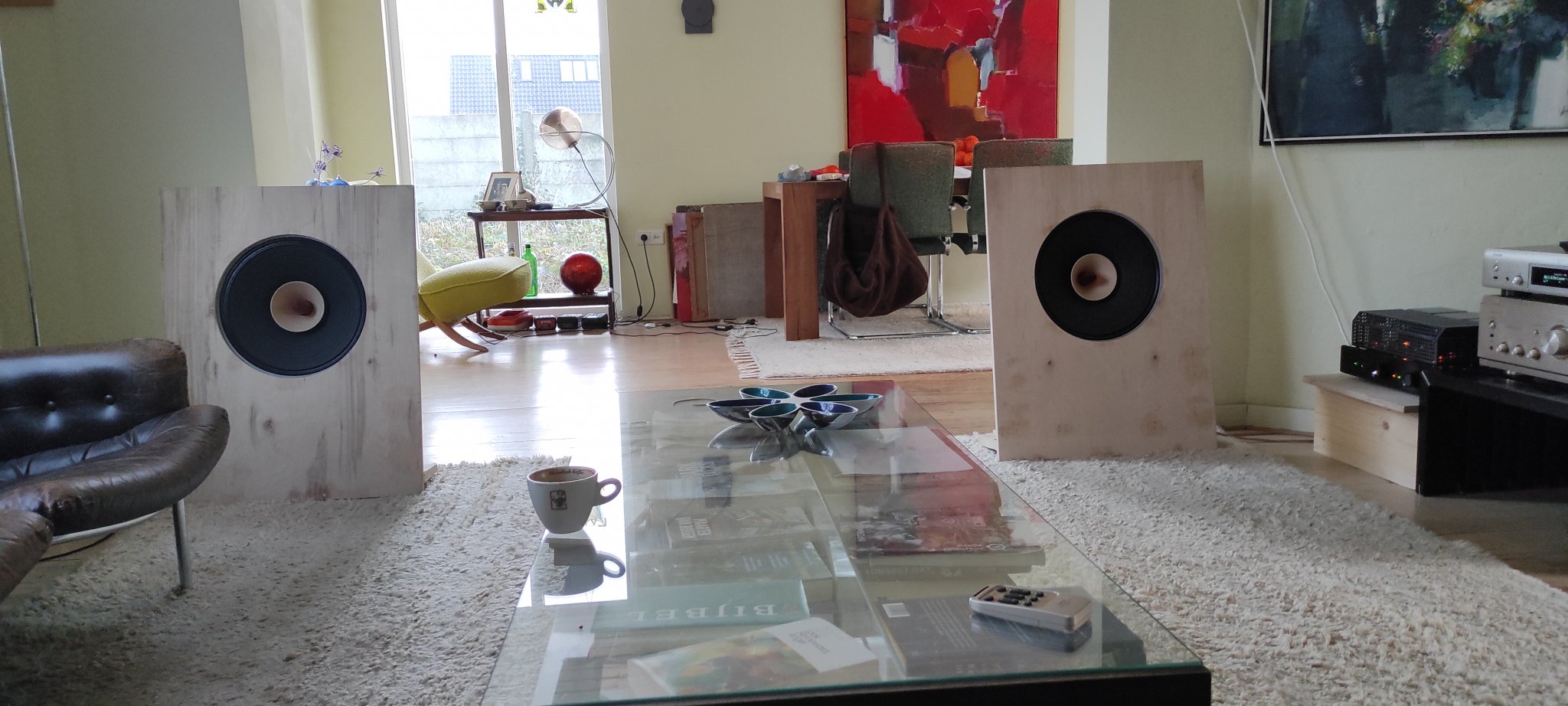

The bass depends very much of the placement.Near to abackwall and deep bass is almost no existing.Give them some air at the backside and deep bass comes alive .
They're at nearly 2m from the wall. I confess that - since my last post - I measured them and they go significantly lower (flat to c. 70hz IIRC) then hearing would suggest. I cross the subs at 65hz 4th order now, and my only complaint is a lack of punch e.g. on kick drums. Double bass is nicely balanced. Crossing the subs higher ruins that with a big peak around 85hz.

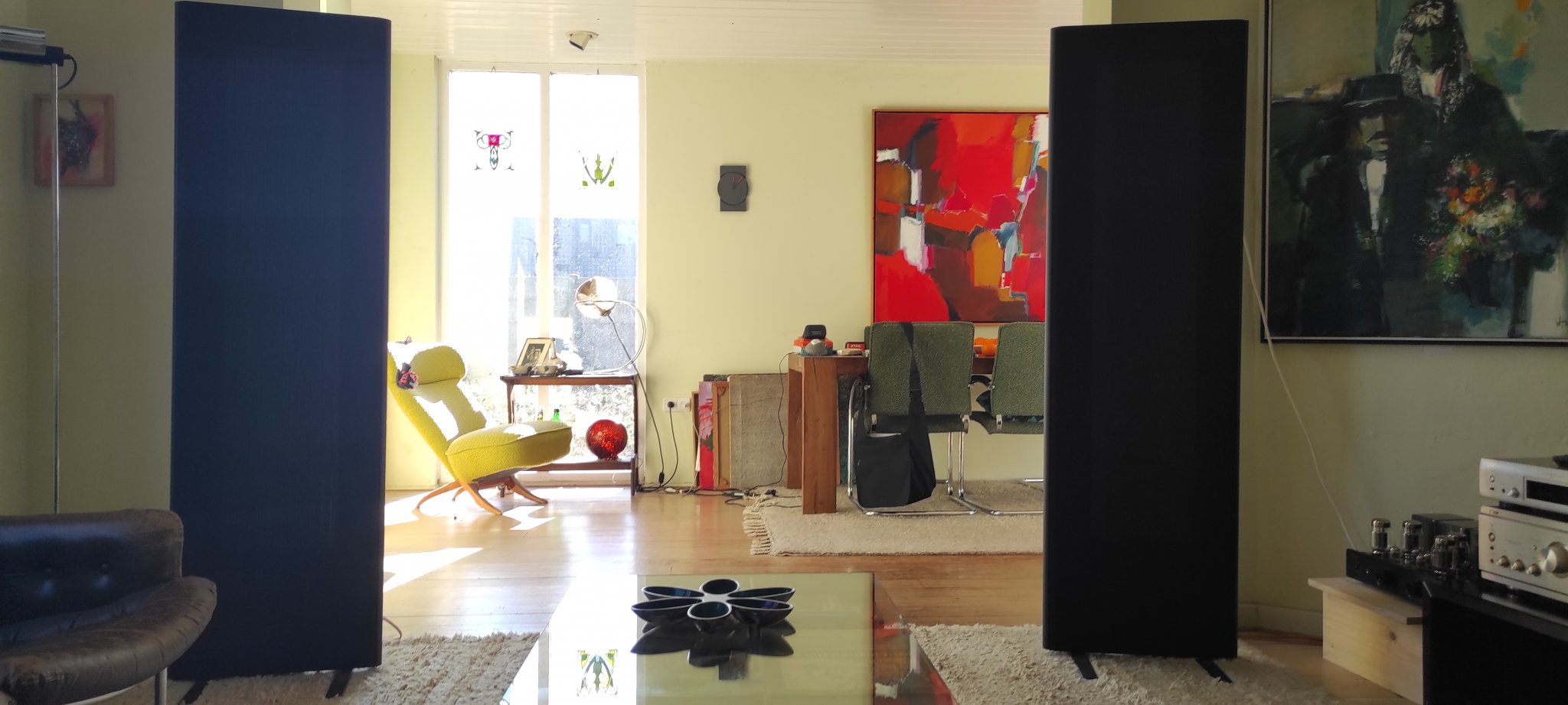

Comparing them once more with my Maggies and solid state
Those F15' s are incredible at 450 euros.
But as a dipole speaker they need room at the back to breath just like the Maggies.
Maybe that explaines some of the bad reviews.
