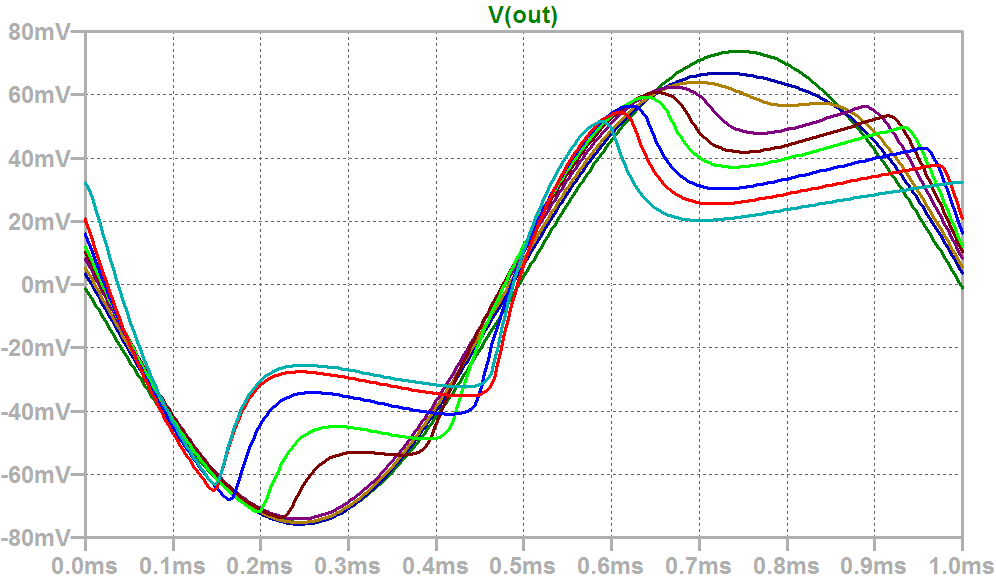

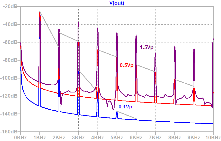

Here's the simulation output showing the effects of varying levels of overdrive. The undistorted waveform is with a 100mV peak 1kHz input. All the other waveforms have been normalized to this level and range from 05Vp to 1.5Vp at the input.
If you examine the family of curves carefully, you can clearly see increasing second harmonic distortion with increasing overdrive (note how clipping begins much sooner on the positive half of the waveform). -- a.s.

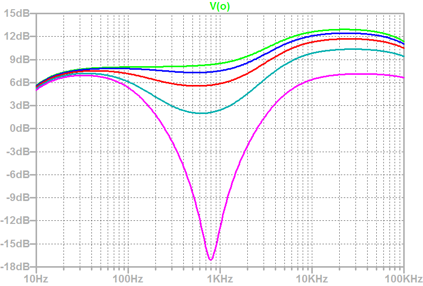

This next schematic is set up to simulate the small signal ac response of the preamp. It is the same as before except that R8 and R9 in the tone control section have been stepped in value to show the effect of combining and replacing them with a 100k potentiometer. -- a.s.

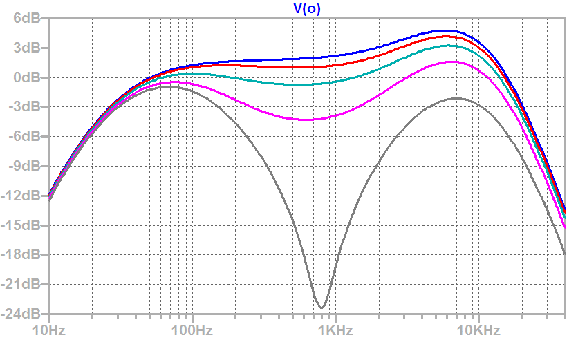

This plot shows the frequency response of the simulated preamp as its 100k tone control pot is stepped through 0, 25, 50, 75 and 100 percent. -- a.s.
Disclaimer: This is not meant to necessarily match the tone control response of JP Hugsley's actual preamp, which may have its tone control configured differently to that shown in the simulation presented here.

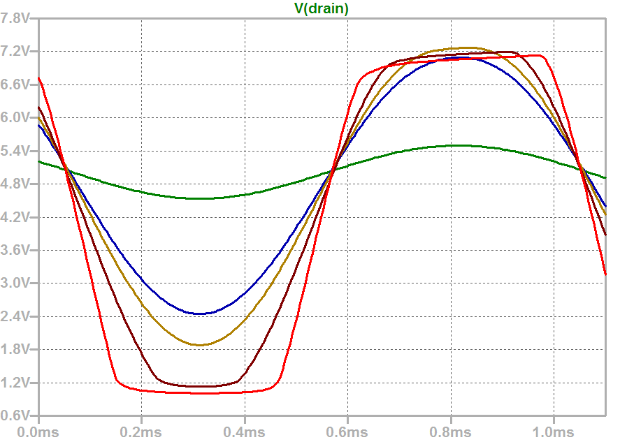

Here is a plot of the simulated drain voltage waveform under various levels of input drive. -- a.s.
JP Hugsley said:Can you please tell me what the IDSS and VGS-off is of the JFET you used in your simulation. I'll try and match them with a JFET I have in my shop.

- The filter used in the preamp is a typical "Enhance" filter used in many guitar/bass amplifiers. In some cases there is "Enhance" pot and in some cases the filter is fixed - without a posibility to change the frequency response of the filter. If there is a pot, it's usually connected differently than you used in your simulation. Why did you connect the pot in the way you did? (I will try later to post how it is usually done in amps).

Markus2006 said:- isn't the unsymmetrical clipping a result of specific Vgs(off) assumed in the J201 model?
Pretty much, although you could look at it turned around and say that it was due to the selection of the values for the source and drain resistors.

Markus2006 said:- The filter used in the preamp is a typical "Enhance" filter used in many guitar/bass amplifiers. In some cases there is "Enhance" pot and in some cases the filter is fixed - without a possibility to change the frequency response of the filter. If there is a pot, it's usually connected differently than you used in your simulation. Why did you connect the pot in the way you did? (I will try later to post how it is usually done in amps).
I tried placing the pot in several locations and just liked the shape of the response contours that one produced. What other locations would you suggest?

PS: Here's the output response with the typical guitar pick up model in place on the input.
