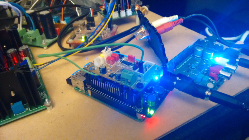

The Mamboberry DACs will require a mod to run in sync mod, but it is a minor one (at least in my world!).
If you look at the great picture Soundcheck posted of the MBLS in his thread on the DAC, you'll see just to the left of the clock a 51R1 resistor. The top pad of that resistor goes to the MCLK pin on the DAC (pin 13). You remove that resistor, then connect from the MCLK pin from the Kali to either the top pad of the resistor (ok) or directly to the MCLK pin 13 (better, but requires even bettery SMD soldering skills). Best to use a section of the coax from a u.fl cable, making sure to connect the ground close to where you solder each end. You might even be able to fit in a u.fl socket at that pad and the pad for the MCLK pin from the Kali on the expansion area of the MBLS.
If you like it, un-power the clock by cutting the 5v power trace to the input of the clock's regulator. See the rendering of the clock section of the circuit board that VASILIST posted. Do that right at the regulator and you can easily re-engage the on-board clock by scrapping off some of the mask at the regulator input lead, doing a small solder bridge to re-power the regulator and clock, removing your MCLK connecting cable, and replacing that 51R1 resistor.
Greg in Mississippi
P.S. This works about the same way with the original Mamboberry, the resistor is a 100R instead of 51R1 and you are cutting the clock power trace right at the local reservoir capacitor, but otherwise it is functionally the same. My mod list for the Mamboberry's will include this.

John, whilst it might offend Gregs audiophile sensibilities, if you just want a to dip a toe in the water before you mod your Mambo by cutting traces, drop me a PM with your address and I'll send you a HIFIMEDIY board with a jumper so you can switch between on-board 50MHz Foxconn and external MCLK (from Kali Pin 29).

Hi Bart, I use the 2 pin header next to the power socket (I didn't have anything to fit either, and continuity buzzed out as connected) It's dead easy to get the polarity reversed so be careful!
The Kali power barrel is 5.5/2.5 rather than the more usual 5.5/2.1......

In the first mambo DAC ( not dedicate HAT board ) it was possible to chance external or internal oscillator source , but in a dedicate for RPI there is no reason for something like that , practical there is not reclock or something ... in the street
not even master clock .. from RPI
The synchronous " way " its always prefer ... but the master oscillator mast have good specification

Today i received the Kali reclocker, after ordering it last monday @ the Volumio webshop. Hooked it up this evening and was blown away by first results, but more on the soundquality side of things later. For now just a short list of my config, because i think others can bennefit from the things i learned.
I'm running piCoreplayer v3.02 on a rpi2, stacked with kali reclocker. Linear 5v, 1Amp power to kali and pi through kali, connected to the +/- pins next to the regular power barral. I2S signal goes from Kali GPIO to an I2S over HDMI module that's powered by its own 3.3 V 1Amp linear powerline. The hdmi module is connected to my external Pink Faun I2S dac via a short hdmi cable. To only audio output driver in piCore that works is the I2S GENERIC. I'v tested material from basic mp3's to 24bit 192khz, all without any problem.
