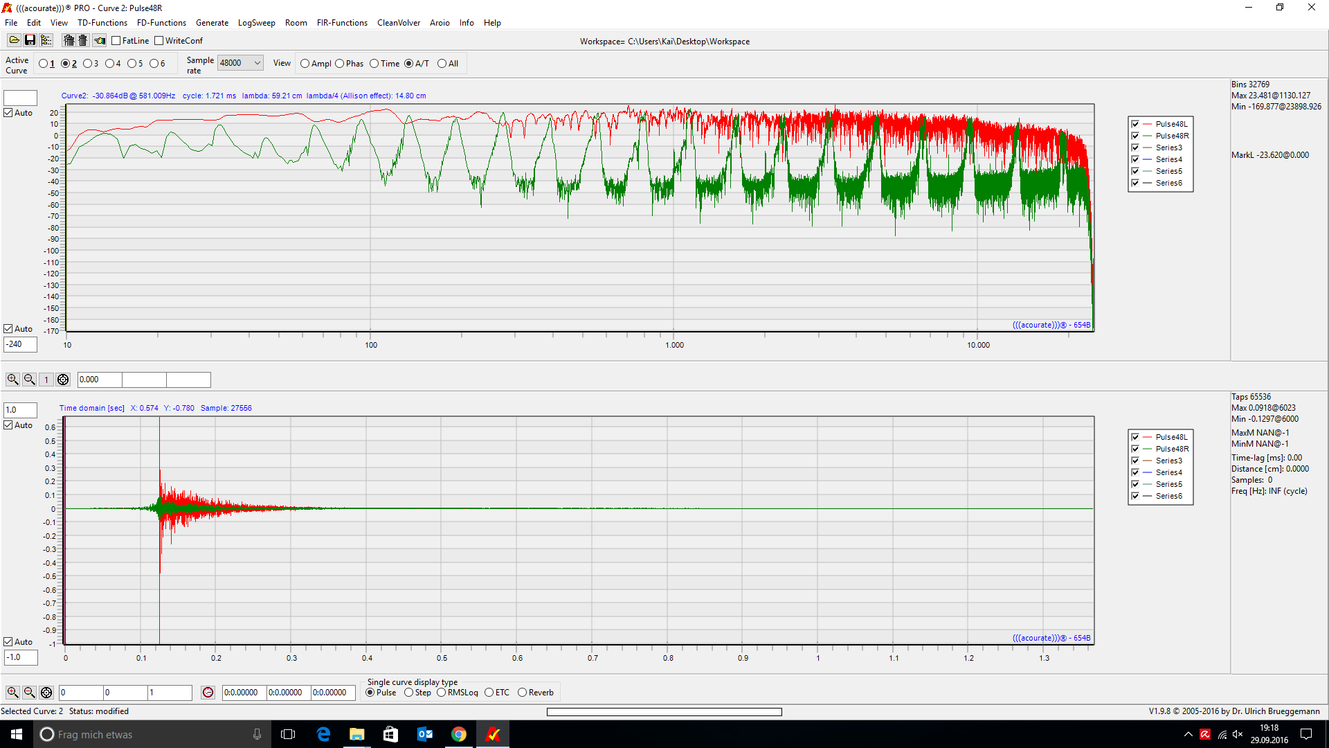

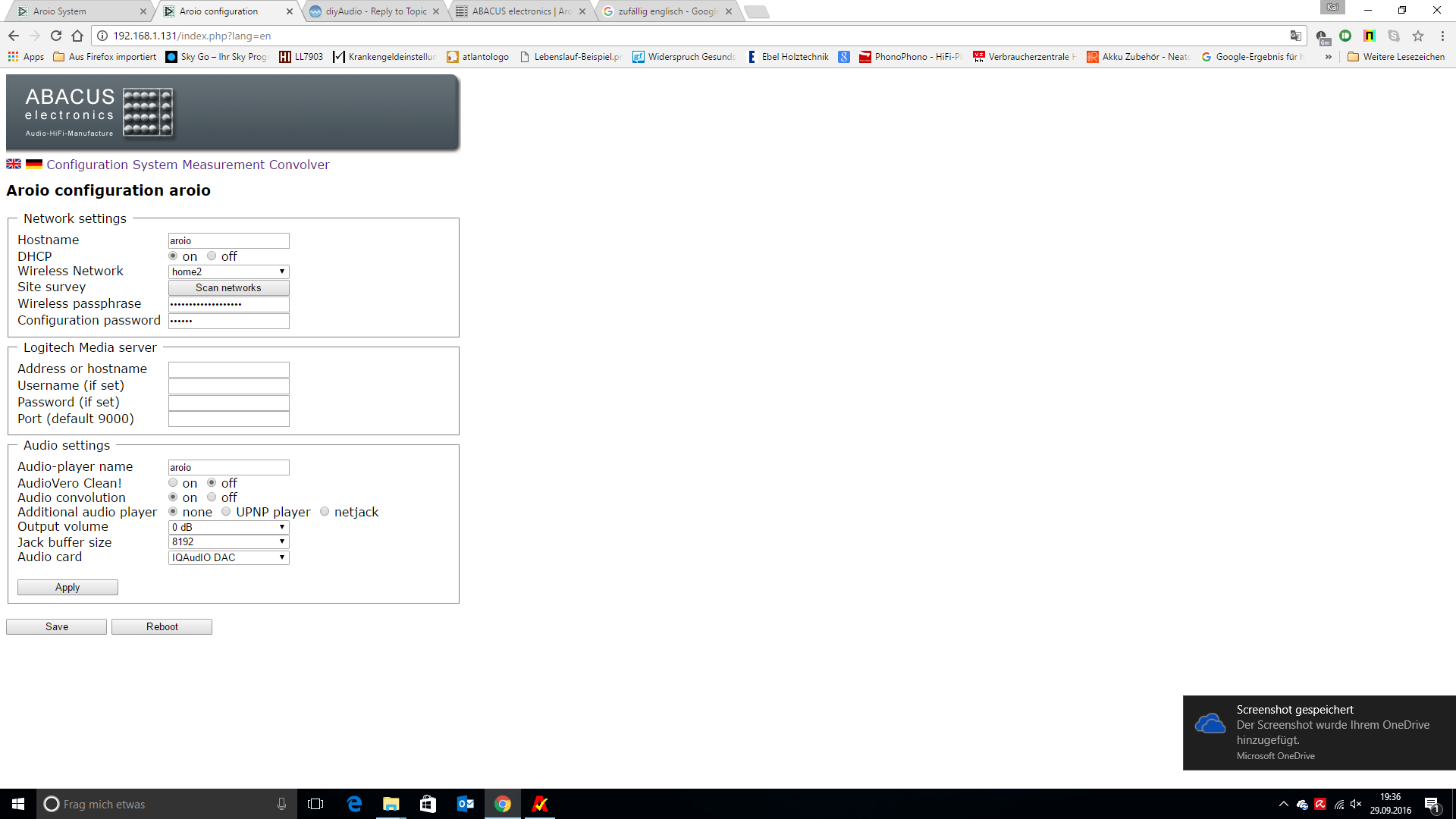

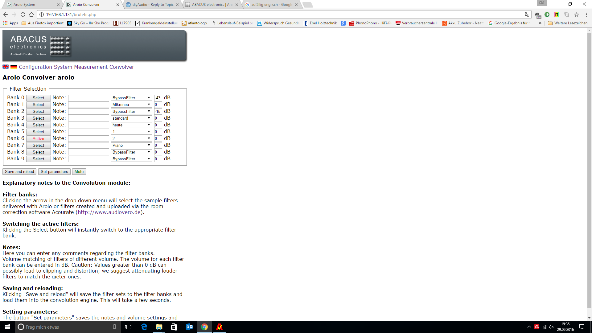

actually I'm using Hifiberry Dac+ Pro with my raspberry pi3. On the raspberry I installed a free AROIO operating system from the german manufacturer Abacus. Aroio uses Raspberry Realtime Kernel 4.1.21 and provides a squeezebox client and DLNA Player with a included convolver with 9 FIR Filterbanks. It has a webinterface for configuration.

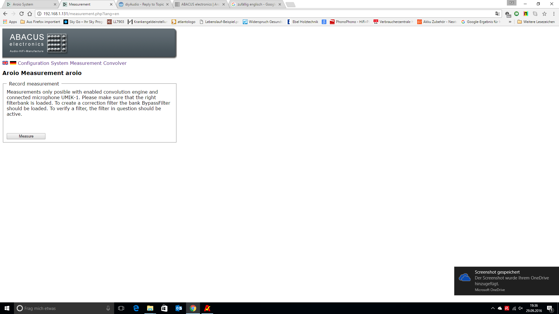

For generating a FIR Filter you have to plug a UMIK-1 into the raspberry and you have to buy Audiovero Acourate Software to record logsweep and generate FIR Filters.
My problem is, that as soon I installed the KALI reclocker I can't play the logsweep on the right channel anymore. The logsweep is played at 96khz sampling rate and the reclocker buffer always runs empty when the logsweep file is played on the right channel. Its a squence like 1second sound, 1 second silence, 1 second sound, 1 second silence and so on. The Kali reclocker shows empty buffer during silence beriod. It doesnt happen with Hifiberry Dac+ pro or with Piano DAC 2.1 when used without reclocker.
I dont't know if ist a software problem or a problem with the Kali.
So if someone accidentally also has the same Hardware combination and wants to download AROIO(its free and you can play the logsweep as long as a UNIK-1 is connected to the raspberry), only to see if its not a defective Kali here. You don't need Acourate for playing the logsweep.

ok, I was able to reproduce the problem. It's just simple, if generated a test tone only on the right channel, left no signal. My Kali just doens't play files/music whatever in mono right channel(left is ok). It does permanatly run out of buffer or looses connection.
