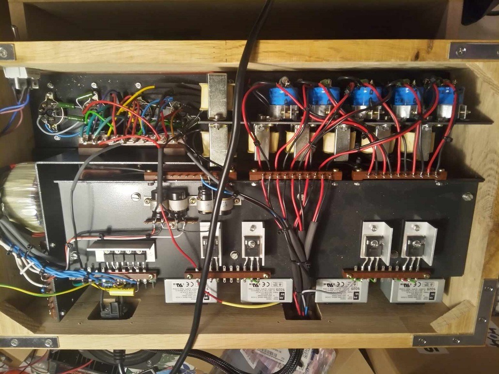

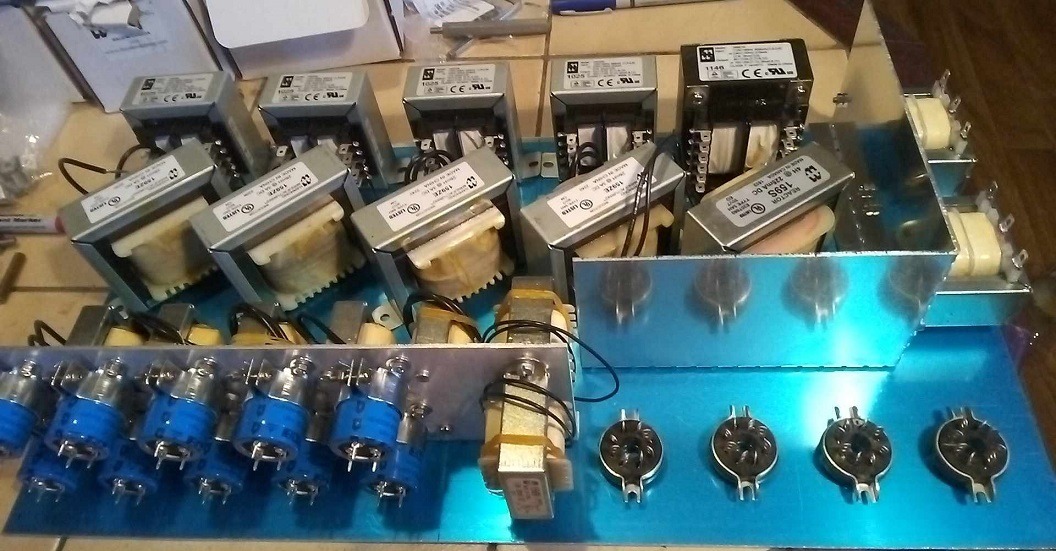

A few hours of "Iron Tetris" has paid off well, it seems I'll actually be able to squeeze all the LV supplies into one chassis with the cores of the transformers, input chokes and filter chokes pointing in three different axis:

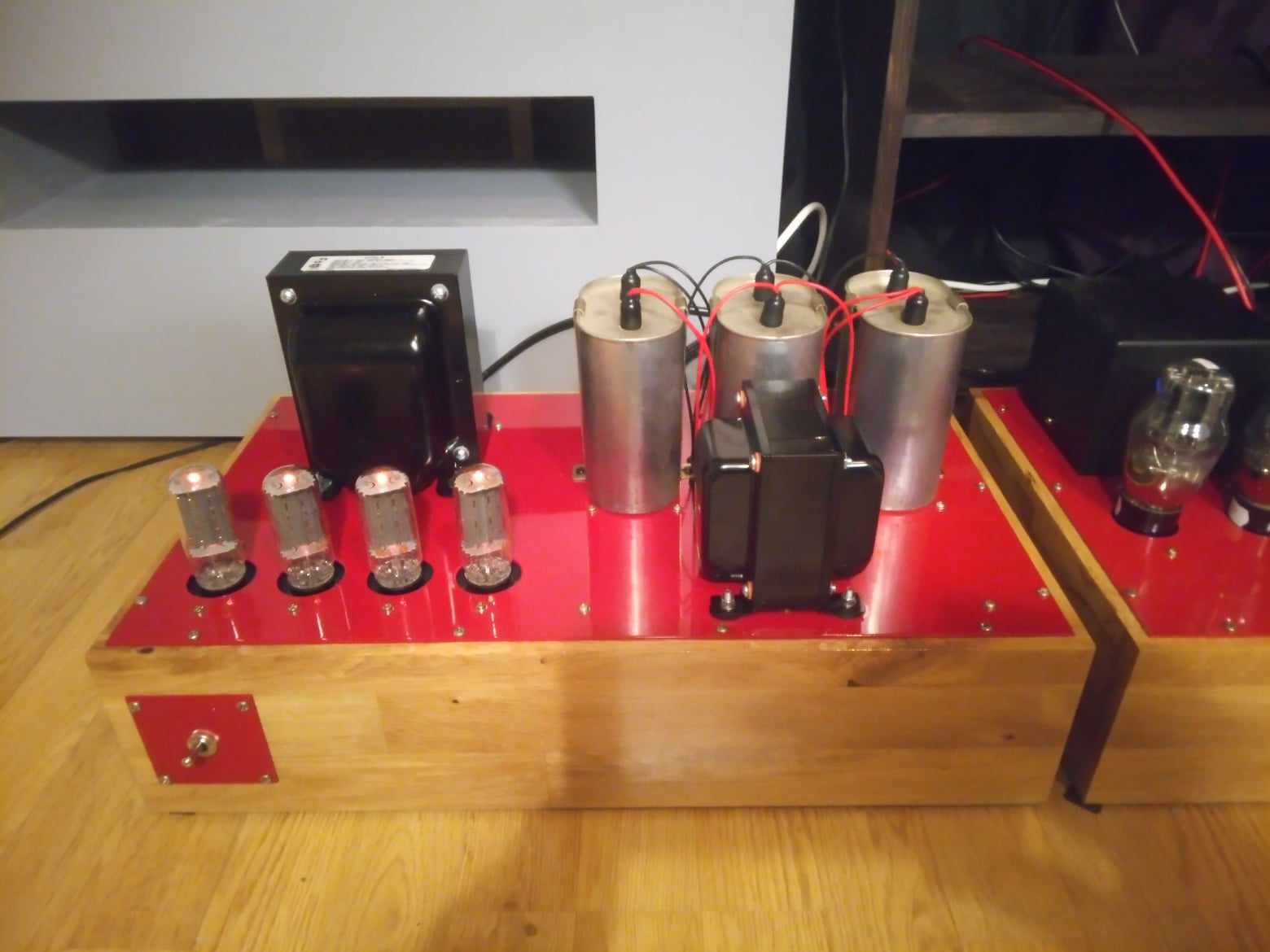

My PP amp is finally playing but some of the transformers or chokes in the PSU are buzzing, even though I tested them carefully on the bench before building to avoid exactly this problem. I think my raw DC is a bit on the high side so with some luck I can cure this just by lowering the AC input to the filament transformers, possibly by using the primary winding of my vastly overrated Hammond 370LX HT transformer as an autoformer and "steal" some juice from an unused 100V tap.

Lowering the input voltage to from 230 to 208VAC didn't help much against the mechanical buzzing. This decreased the DC from 11,1V to 9,95V, so I should be able to lower the AC input down to maybe 195V before the regs fall out ouf regulation. Doubt it would help though. Dammit, I tested the transformers and chokes before building the power supply just to avoid this. Perhaps the easiest fix would be to buck the input voltage down to 150V or so and remove the input chokes, not a very tempting solution though.
If you are using an LC (choke input) filter, please check that the choke current rating is well above the DC load current.
Chokes can make a mechanical buzz if there is any risk of saturation.
LC filters at 1A can be improved by adding a solid polymer (Kemet A750 series) 220 .. 470uF 16V right after the rectifier. Not many capacitors can handle the current in this position, please don't use ordinary Alu elkos here.
