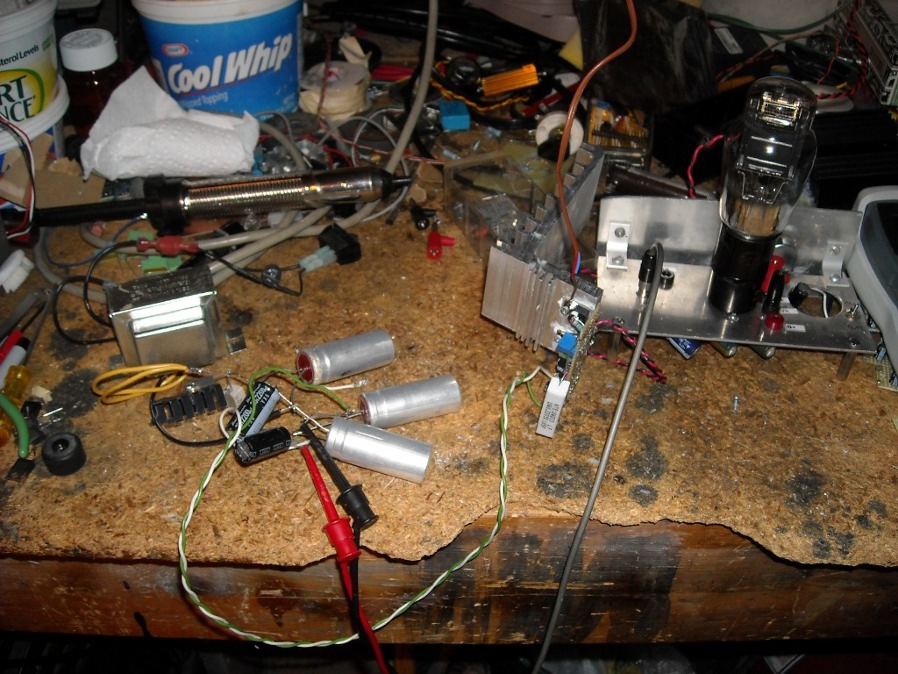

I've got some scrap heat sinks from power supplies so I set one up with a breadboard of the coleman reglulator (I'm not about to abuse the pcbs kits I have like this).
With the heat sink vertical to get some air convection it works pretty well with a 26 degree C rise. Vin is 7.64V and the sense resistor voltage drop is 0.86 (yes, not exactly the same circuit a I adjusted it for components on hand including a different thermistor ).
The current source Vce is 2.30, and the gyrator Vce is 1.96. I need a better transformer as my supply voltage is a bit low, and have some on order. However this should be good enough to get me in the ball park.
transistor Pd for both is thus (2.3+1.96) * 2.5A = 10.65W so figure I'll need 12W per regulator times two is 24W if I'm going to use one heat sink for two channels.
It looks like a 2" X 4" heat sink with 20+ fins would possibly be enough for a less than 60 degree C rise.

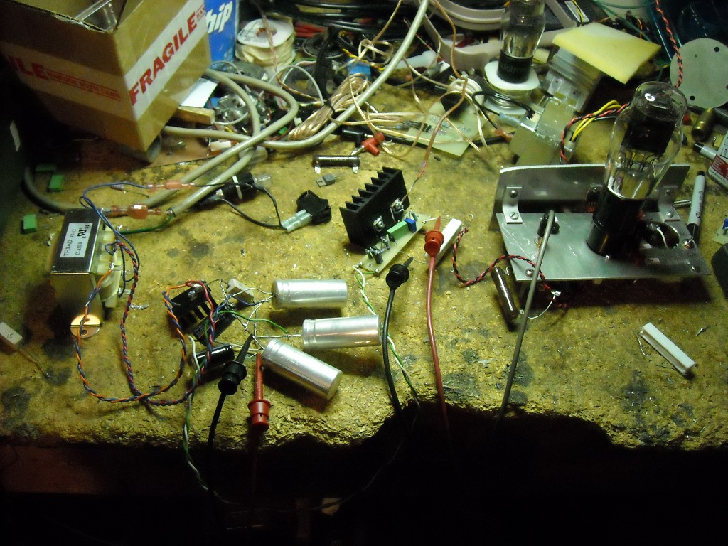

First Heat sink Test
Thisi s the first heat sink I received. It measures approximatly 2.5" X 1.5" with 0.7" deep fins that are 0.80" thick. There are eight fins.
I am using a Triad F7-12 transformer (12.6V Ct @ 4A) with a IR 12CTQ030 rectifier. (dual 6A 30V Schotty diodes) with 4 X 4400uF 35V capacitors for filtering.
Input to the Coleman type regulator is 8.28V.
I'm using a .33R sense resistor with 0.823V across it. With 2.5V on the 2A3 (bad tube with a good filament I use for testing) I'm left with about 4.96 volts across the two TIP122s.
At 2.5A that is roughly 12.4W dissipation.
Temp at the case of the current sink is 144F at an ambient of 70F for a 74F rise (about 41C). It looks like a 3.3C/W heat sink.
WIth a Tjc of 1.92 C/W and even distribution of the load between the two transistors, that works out to a junction to case rise of about 11.9C. Added to the 41C , and adding 21C ambinet I arrive at a junction temp of only73.9C which is only half of the specified 150C, so it should have a good reliability.
So it looks like a pretty small heat sink may be acceptable for a single 2A3 tube. Even if the voltage in is increased to 10.28V, the additional dissipation would only be 2.5W per transistor for a rise to about 8.3C for a die temp of 82.2C.
If the heat sink were mounted on a chassis and bolted to it, with vent holes in the chassis, the temp rise would be even less.

Good work!
I like to see the heatsink at a target maximum temperature of about 65-70 deg C - using the FP insulated transistor packages. With standard TO220, you can go a little higher.
This way, you have some margin when the power is applied to a cold filament after a power outage - ie the voltage across the filament is lower, and this extra voltage is applied to Q5. Then again, the Coleman Regulator applies the positive voltage on a slow ramp, so the effect is very small in practice.
Enjoy the 2A3 sound!
I'm using the standard TO-220 with a mica insulator and Dow Corning 340 heat sink compound. I have to use silicon insulators for HV because the hole for a screw in the mica insulators is way too large and I've had shorts with them.
Mica has a lower theta (0.5C/W) than the silicon pads (0.89C/W), but is more prone to damage and shorts. I'd like to try the ceramic insulators, but the TO-220 ones I've seen look way too thick compared to the ones we use at work, so I'm not too confident in them.

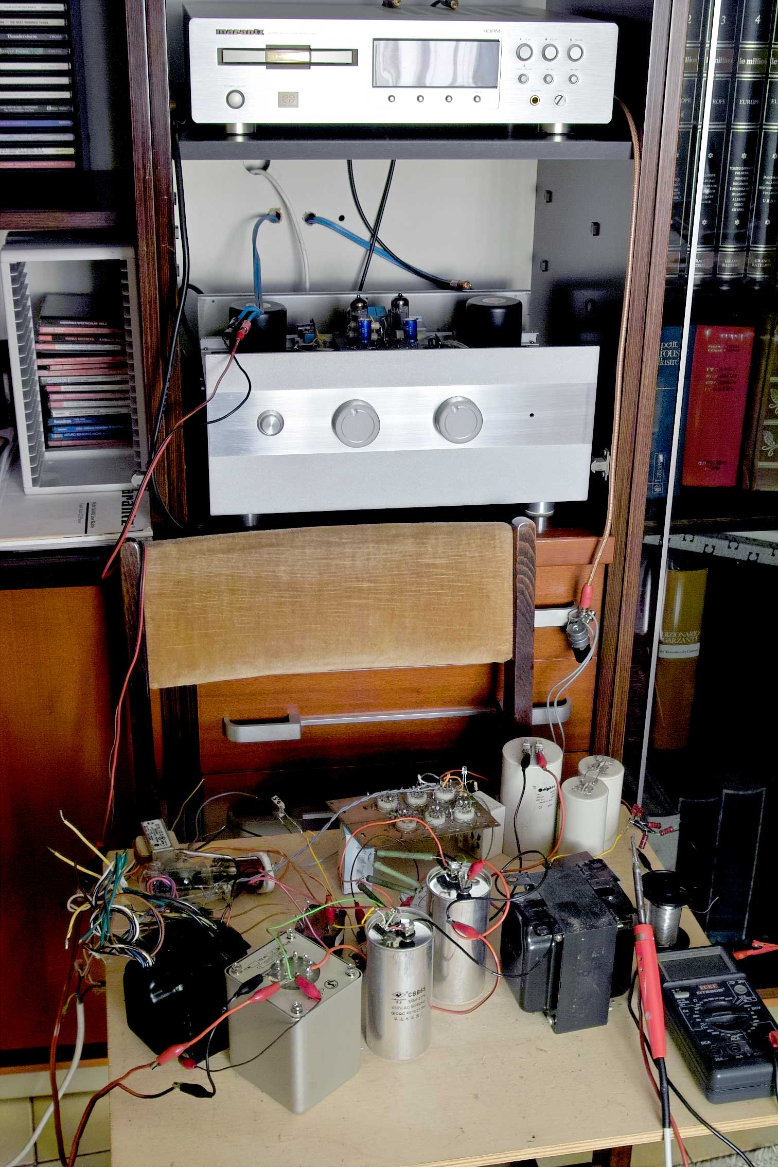

My 300B Loftin White.
Hi Rod.
I already wrote to you an email message yesterday by the Italian forum "Audiofaidate" asking if you can still sell two assembled units of your heater regulator for my 300B Loftin White (attached) and how I can pay them.
I just registered myself in this forum to obtain direct information from the attachments in your posts.
Just one channel (connected to my old modified Marantz SA8400)"lying" on a chair, is already optimally driving one of my 94db speakers.
-The "irons" have been chosen for a low impedance supply (63 ohm chokes, 37ohm-450Vac).
-All capacitors 100uF MKP 450Vac.
-High anode load impedance (5K) for lower distortion and high DF (about 5).

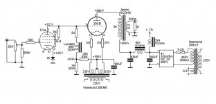

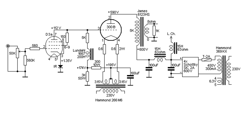

Just one question: in some of your attachments I see the positive of the heater go to ground, while in others the negative... which one?
Any suggestion on my layout is welcome!
Have a nice day,
Italo
Hi Italo,
I have sent you a "private message" with details for 300B regulators.
The Filament + terminal usually gives the best sound, but you can try -ve - but please take care that the bias voltage is higher, when using -ve side.
Some circuits are using "Filament Bias", and this time you have no choice - the -ve side must be used.
