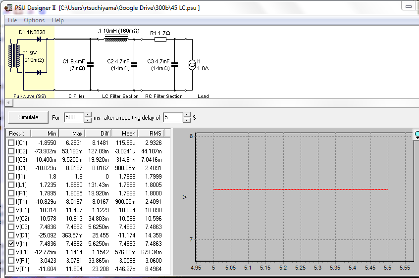

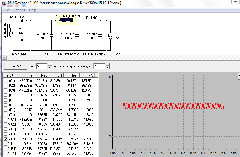

Ok, two sims attached, one with the larger cap at 9V, and one with 10u cap at 12v
Current is much lower, tradeoff appears to be a little more ripple voltage.

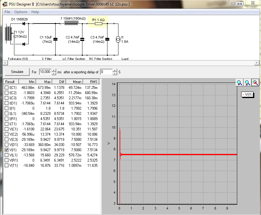

As Zen Mod suggests - that way the IT1 MAX and RMS values show you the peak charge currents (switching diode stress and noise coupling back through the transformer) without the influence of the initial inrush to charge the capacitors.
That will be more informative.
