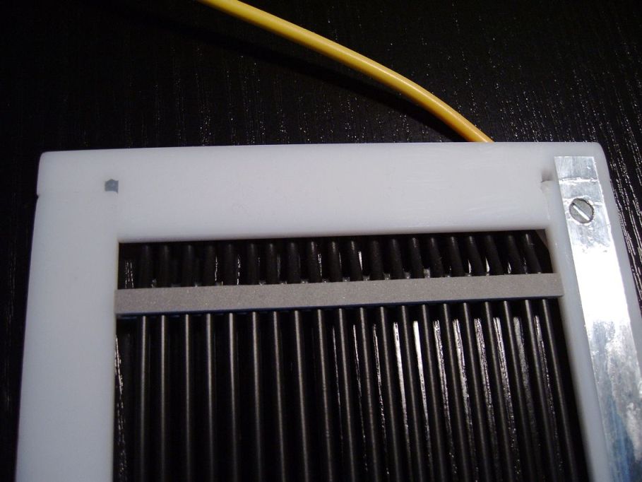

Attached are some pics of one of my old early wire panels to show some details of frame/stator construction and diaphragm contacting.
First pic shows the frame made from strips of a plastic ... think it was unfilled PVC.
The top an bottom parts shaped like a T to exactly define the inner width and to cope with the horizontal and vertical pulling forces that act upon the frame.
A simple machine screw bolted through a layer of household aluminum foil (yup!) and the frame acts as diaphragm contact strip.

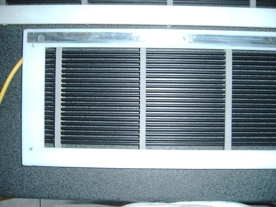

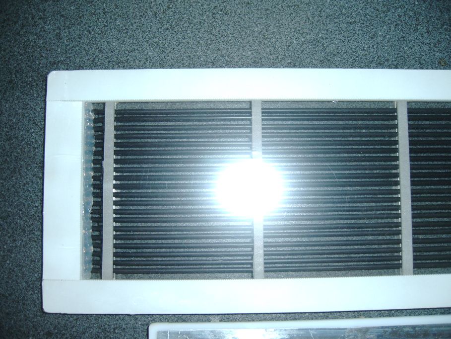

Second pic shows the second stator with mounted membrane.
Tape used here was a Tesa carpet tape.
The frame strip width was chosen wide enough that there´s enough glue joint area to cope wih the membrane´s pulling forces.
The tape is around 1-2/10s of a mm thick and should reach to the inner edge of the frame.
Be aware that a sharp inner edge of the frame may actually cut the membrane.
The thin tape provides for enough distance to keep the membrane safe.
In a larger panel I also glued some foam to the inner edges to provide for a bit of damping for the standing waves that develop over the membrane.
As additional dampers small strips of foam are glued below each ladder-step.

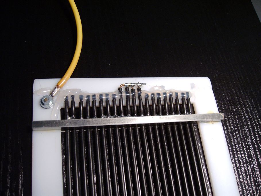

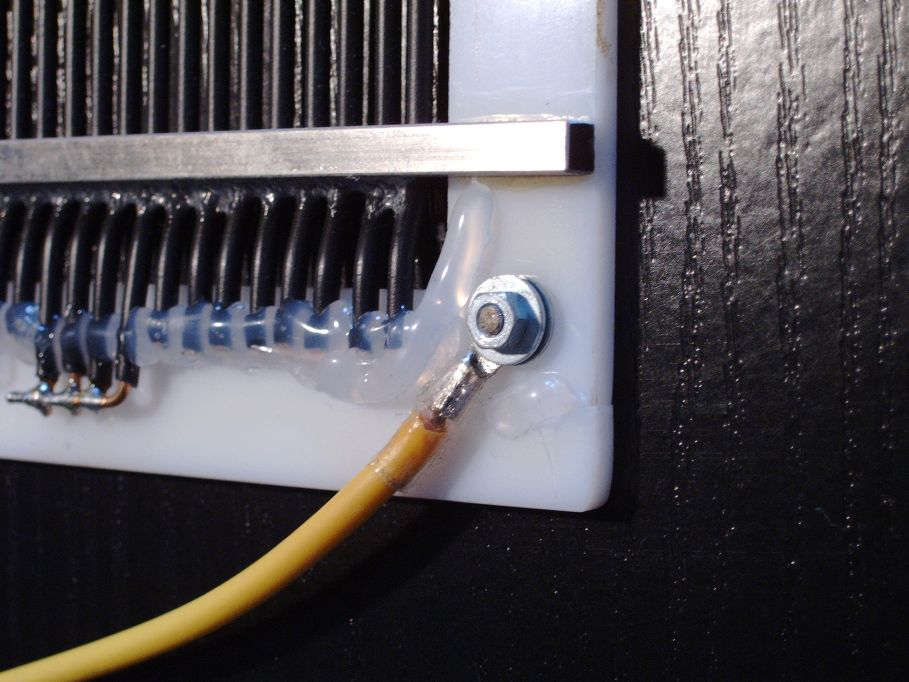

The ladder can be seen in pics 4 and 5, made from 5x5mm steel rods, cut to length.
Audiostatic used shallow quadratically shaped 10x10mm aluminum bars.
Both materials are easy to source in any diy-shop.
The metal bars are optically quite pleasing, but a insulative materal would be advantageous technically.
You may use the same material as for the frame, if You hide the panel later under a piece of cloth, or something like clear acrylics, if You like Your panels ´visually open´
The stator´s middle wires are connected to the transformer the same side as the Membrane bias contact.
The outer parts are segmented with resistors at the other end of the stator.
To get the wires perfectly straight You may build Yourself a stretching jig or stretch each wire its own.
The latter doesn´t require a jig and gives most perfect straightness, but is time and labour consuming.
Wire used here was a H0/VU which is used as standard household wiring.
As such You may source it at any corner at lowest cost.
Open HV-leading parts like the membrane connector or the wire ends are isolated with blobs of silicon.

In one of my earlier builds, I used .062" TIG rod, which is a thin steel rod which spanned about 12" (30cm). It acted like a harp with terrible ringing, but that is very different than standard copper, which does not have the stiffness that steel does. I have to agree with Calvin - stranded wire under tension has to be far more prone to resonance than single core copper which is not taut.
In my most recent build, I used far thinner TIG rod, but supported it every 1/2" (1.3cm) using egg crate and have none of the mentioned ringing problems.
If I were to build a panel with larger rods (say .090 or .125 dia) that may be a viable solution. But may ultimately be unnecessary.
I chose much finer rods (.035) spaced close together. Using shrink wrap on these would chew up all of the available space between rods.
Corona effects are greatest when there are pointy bits. Since the rods have their curved profile to the diaphragm, corona effects are far reduced. Having a very thick, effective insulation is less important than in perforated panels. A simple paint job was sufficient insulation, even with the small radius I had with the 035 rods.
The one and only circumstance under which the above could be tolerable is a isolated non-touchable mounting of the stators behind earthed screens.
