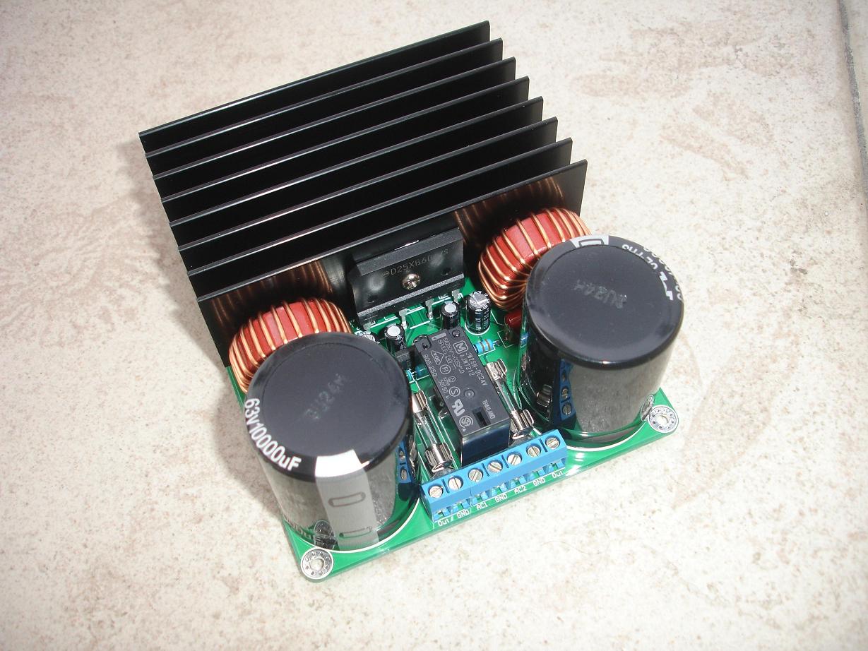

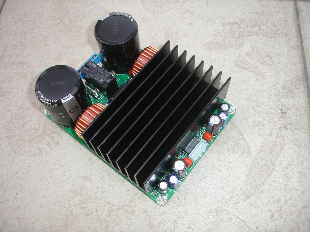

ta3020v3c
Hi CNX, what changes have been made to the TA3020v3c version? Would you recommend the smps1000 for this amp? Are any other components required besides these two things? Also would you still recommend the BIPS (180 phase shift) for this amp?
Another question... somebody earlier mentioned changing the mos-fets on the 3020 boards to IRFP4228 for higher output and cooler running... could you do that?
the gain can be changed only externally, attenuation with potentiometer. the TDA892x IC's has fixed gain which cannot be changed (not very simple)Is it possible to modify the input gain of TDA892x V2 board via pot? I'm not sure if the datasheet applies to this version of the board.
the manual is similar with the previous version, the boards are based on the same schematic, only the layout is changed.
on the TA3020v3c i added speaker protection circuit, bigger capacitors for the power supply (35mm diameter) and rectifier bridge. the amplifier can be used with smps as well, and the bridge can be removed in this case. BIPS can be used if the supply voltage is close to the upper limit, +-60V to prevent turning ON/OFF when the voltage boost over the maximum limit.Hi CNX, what changes have been made to the TA3020v3c version? Would you recommend the smps1000 for this amp? Are any other components required besides these two things? Also would you still recommend the BIPS (180 phase shift) for this amp?
this board can be used in BTL mode directly even without BIPS, by simply connecting one resistor which will bring inverted signal from the output of one channel AO to the input of the other channel AO.
the MOS-FET's can be changed, with IRFB4227 which is one of the best in his class, the efficiency will be improved a little but the output power is still limited to the maximum rail voltage which the IC can admit, so there will be slight changes on the output power.
