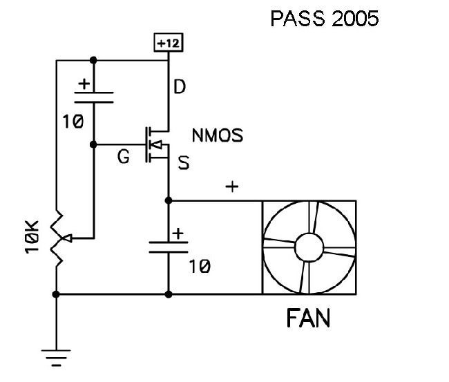

What about the temperature? I ordered me some fans to cool the whole enclosure...
thanks a lot!
Fans are a noisy. How hot does the heatsink get? A temperature of 50°C is no problem at all. A rule of thumb: if you can touch the heatsink for 2 seconds or longer you're good to go. Make sure the enclosure has ventilation openings on both top and bottom.

I have got holes in the top and bottom but the temperature rises to 60°C. I ordered fans that make 23db at 12V and I will try to reduce the current according to the temperatur. I have my camera in my office, but I will post some pics during the next week. Maybe you have some suggestions how to make it better.
I think the heatsink inside the enclosure is not the best idea, but i wanted to have the amp in a 19" rack system/enclosure!

Do you have any inrush limiting on the amp? A CL-30 in series with the mains will help. With CL30 and a 1KVA transformer followed by 90Kuf I found that I needed a 6A slow blow to keep from occasionally blowing the line fuse on start I have 120V mains, so your 2A slow blow ought to be in the ballpark.
If you can keep your hands on 60C sinks you are a better man than me. Each output FET will have a thermal resistance of 0.86 C/W junction to case and maybe .7 to 1 case to sink depending on your isolator choice (what did you use?). Therefore, the junctions will be 20W x (1.5 to 1.9) hotter than the sinks. That makes the junction temperature around 90 -105C. That is well within their ratings, but if anyone can come into physical contact with the sinks, it's probably better to have them a bit cooler.

Thanks for the reply. My English and especially my technical English is not that good. Can you please explain what you mean with CL-30. If we are talking about the power supply section i can tell you that i have a CRC there. The C1 is 22kµF followed by a 1 Ohm 5W resistor and again 22kµF capacitor.
I did not put my hands on the heatsink. I measured it with a PT100 and multimeter / circuit analyzer. Put the front and back of the enclosure were not mounted for testing the aleph. So I think with closed enclosure the heat will rise even higher. I have mounted the FET with a mica disk (if leo.org has translated the German word: Glimmerfolie right).
For protection of children or drunken guys in my living room all heat sinks are inside the enclosure.
I want to regulate the speed of the fan with a potentiometer as a changeable resitor. The Fan works for 12V and I hope it will be able to turn at 6V or less as well.
