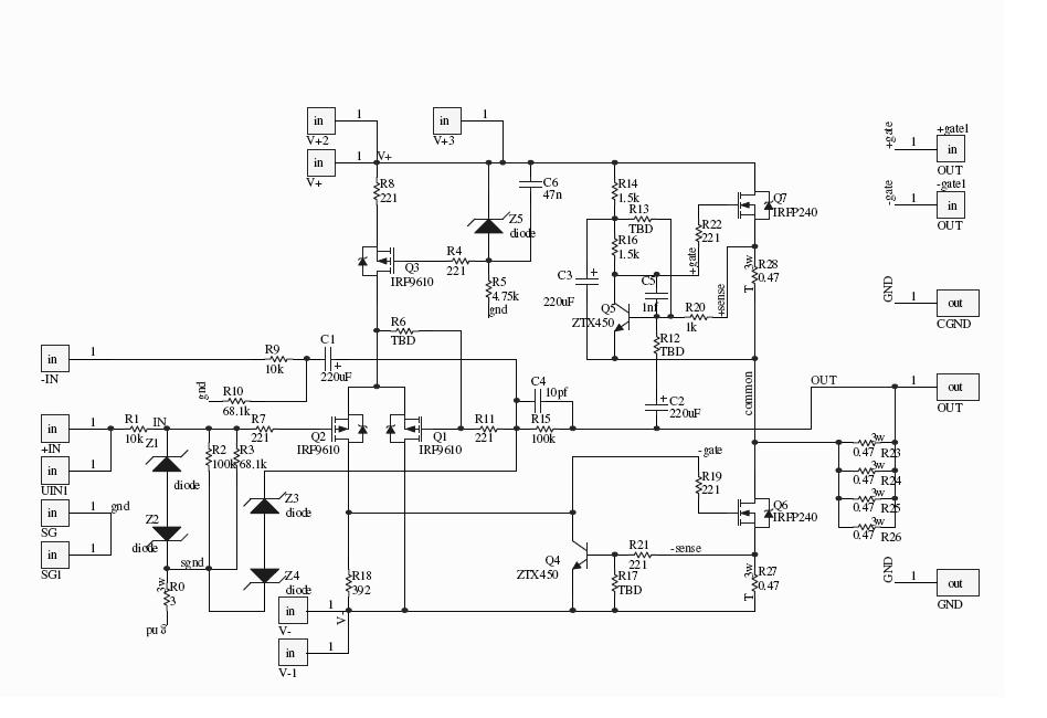

Just a couple of questions, as I'm planning on building this amp this coming winter.
BrainGT's schematic indicates ZTX450, whilst I have a load of MPSA18 (as used in the Aleph30). Any benefit in using the ZTX450 over the MPSA18?
Also, if not using the -in input, most are shorting to gnd. Why not just leave out R9, R10 and C1, saving on components?
As Bill Fuss demonstrated in the Aleph J thread (IIRC), the ZTX450 starts turning on at higher voltage than the MPSA18. If you want to use your MPSA18s use around 1K for R17.
When single ended leave in R9, R10 and C1, otherwise you have 100% feedback. Ground the negative input when single ended.
@ Woodenhead - I messed that one up - use <100R for R17 or 1K for R21 and 221 for R17. The reason for these parts is short circuit protection. you can leave them out completely if you are careful.
I went back and looked at the current limiter section in most of the Aleph schematics and the only one I found that could have a distortion problem is the Aleph J so everyones' projects should be trouble free. The Master has stated that the ZTX parts start causing distortion at .4Vbe so anyone building an Aleph J should raise R13 to at least 500 ohms, and 1K if they are using something other than the ZTX450 for Q3. I have heard from another forum member that ran into the same situation at higher output levels and was using the ZTX parts.
I still think it was a typo on the schematic.
The offset is 30mV and 40mV. Is that ok? I don't know how to minimize that value!
Those are good enough values, if you want lower values adjust R8 (see schematic). I used a trimmer.
