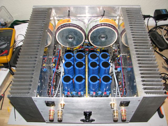

Nope, thats next to nothing so dont worry. I finished an Aleph 5 today, using BrianGT's small and nice boards. The amp isnt small though, it weighs in at just under 40kg. Dual mono, 2 500VA 2x25v trafos and 6x22000uF per channel. It can deliver the current needed to really rock my Proac Response clones:) The sound? simply terrific. Just what I like;)
Have a look.
Steen:cool:
Here is another one of the internals. The chunky heatsinks doesnt get warmer than its still possible to hold your hands on them after 3 hours (thats what the amp has been playing right now). They weigh just over 8 kg a piece. The psu sags about 2,5 volts. I had around just under 37V at no load and just over 34V under load. By the way, the amp worked from first turn on! I just love it, when that happens:D
Steen:)
Steen:)
Steen,
Very nice works.
Seems that you get very efficient heat sinks. I'm looking for such heat sinks for reasonable price. Care to tell us where did you get them, dimensions and the cost?
They measure 400mmx200mmx85mm. The bodyplate is 16mm thick. I havent seen them for sale anywhere. A friend of mine had 4 of those and I managed to pursuade him to trade 2 of them with me:) Would you believe that he wanted to cut then to smaller pieces to be used for gainclones? That must top the list of crazy things you can do to nice fat heatsinks. I had to tell him he was mad;) He still has the other set, he wants to use them for a Krell KSA50. Pheeew, glad he reconsidered the cutting :eek:
