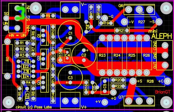

BTW, where is C6 on the PCB? I can't seem to locate it anywhere.
You got mail. :D C6 sounds like it is near the front of the board. maybe you have a older version of the ( printed on paper ) version of the layout. Check the actuall board.

The board that I'm using is http://www.diyamps.com/aleph/images/miniAleph-PCB.gif
which I now see is out of date. Doh! Good thing I didn't solder anything yet.
Brian added C6 in between R5 and Z5. Other than that, I see now other changes.
A couple of questions --
1. C1 should be reversed from this layout? http://www.diyamps.com/aleph/images/miniAleph-PCB.gif
2. Which path is C6 connected to? Judging by the pictures, C6 is a bridge between R5 and Z5 and should be connected to these two points?

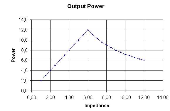

I have Aleph Power and Dissipation Spreadsheet from wuffwaff and when I enter 15V or 18V ( small diference in power at 4 Ohm ) I get around 8W ...
The picture below show 15V and 1A ...
From the sime spreadsheet, if I would like more power at 4 Ohm I would nead to rise bias ...
Is this right ? ...
what is the minimum recomended voltage for IRFP044 operation ?
my heatsink could only take up to 18-19W ... so if I would rise bias I would nead to lover voltage to stay inside those 18-19W

Hello Yoke,
As Jason mentioned, the best thing will be if you can
use larger heatsinks. (Perhaps use a fan?)
However, if you can only to dissipate 18W per
mosfet then I would perhaps try
12V @ 1.5A. Mr. Pass' mosfet testing article
( http://passdiy.com/pdf/mos.pdf ) shows that the
distortion goes up with decreasing
voltage and goes down with increasing bias.
