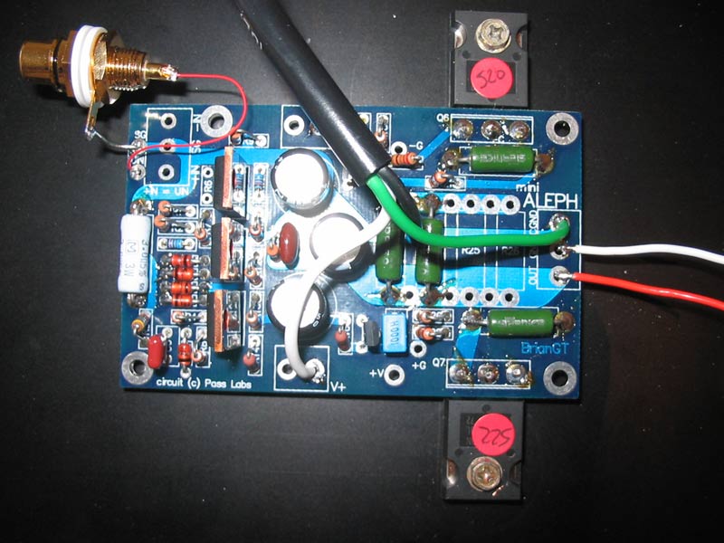

BrianGT said:
You are correct. Thank you for pointing out this error. I will put an update on the website. Here is a comparison of the schematic and the manual. I am sorry for the mistake. I will send out a mass e-mail about this soon.
The prototype amp (same amp board layout) has C1 with the polarity backwards and worked without problems:
http://www.briangt.com/gallery/miniALEPH-prototype/Brian_GT_Mini_Aleph_044_copy
I will talk to Mark and see if he noticed any problems. Sorry about this issue.
One more issue that I found last night, if you are using the 4 pin caps on the power supply board, you will want to remove the 2 unused pins, as the connected to the + capacitor lead, and this might cause problems. I will include this in a mass mail, and I will put an update on the webpage.
Brian

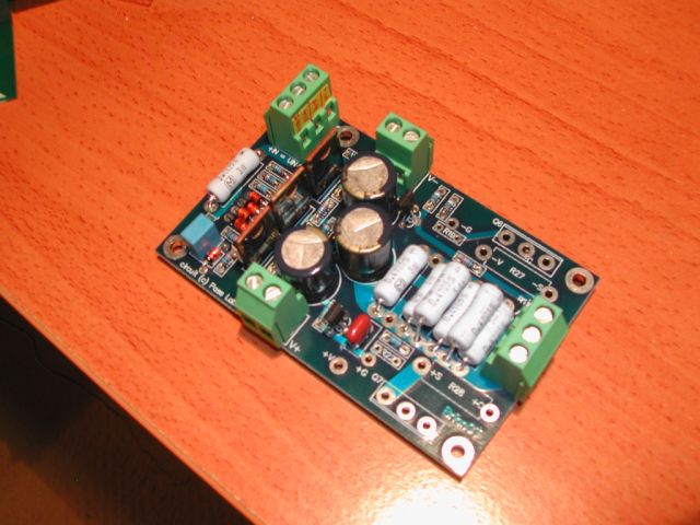

Ok. I FINALLY got around to assembling 2 boards and have a couple of quick questions before I install them in a chassis.
The caps supplied in my stereo Mini-A / A30 kit were 6 electrolitics, a blue one (polyester?) and a small film one.
Of course the 3 electrolytics are easy as C1, C2 and C3 with C1 being the wrong orientation on the board silk screen.
But That only left me wth 2 caps of different values / types.
Was my kit short the matching parts or are some not required?
I have empty spots for C4 and C5 on both boards and only 2 caps. Which one goes in which spot, and I will order matching caps for the 4 boards I have.
Also does anyoe have a close up picture of their boards completed so I can compare? I think Jason posted or sent one earlier but I've had to change PC's since then and have "lost" my references. Mother board died and I ended up purhasing a new PC versus trying to find an old RAMBUS mother board.
Any assistance would be appreciated.
hile reviewing this ENTIRE thread I noticed the following which I missed initially:
http://www.diyaudio.com/forums/showthread.php?postid=635468#post635468
Notice the position of the blue caps on Brians brds..
Now look at his picture and see where his blue caps are located:
http://www.diyaudio.com/forums/showthread.php?postid=655529#post655529
And Jason's...
http://jleaman.ath.cx/minia/IMG_2308.JPG
So where do the blue (poly?) caps go?

Make it look like this..
http://gallery.zorby-audio.com/displayimage.php?album=1&pos=7
This cant be to hard..if it is please pm me.

Since not all the parts were included in your kits, and since I trust brian's Engineering, I am doing a bit more research.
As an example of my hesitation:
C6 47nF BC2068-ND BC Polypropylene 47nF capacitor for D5
A little further digging and I found tha my OLD excel ss I printed did not have the above note on the side of C6 which I am just finding.
C6 is http://www.rapidelectronics.co.uk/r...CAT_CODE=30153&STK_PROD_CODE=M27985&XPAGENO=1
which should be on top of the Zener.
Nothing personal, but I've never lost smoke from DIY electronics before.. Only a few fuses... And I don't intend to start now.
rabstg,
Do you have this parts list for A30 and mini-A from Brian's web site? It should provide some answers to your questions.
http://www.diyamps.com/aleph/docs/miniALEPH-parts_list.xls
I ordered the parts that were shown on Brian's part list and it work out fine. Every part fits perfectly.
Here's a picture of my A30 stuffed board.
