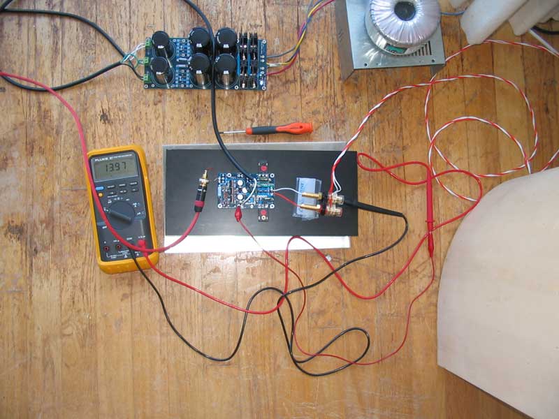

Jason-
Could the new one be in need of break in time?
Have one channel stuffed sitting on my bench. Have not had time for the other yet.
May I ask for a close up shot of only the main brd?
I will use it as a comparison to mine to ensure I stuffed it correctly before I fire it up.

I can only think it would be due to break in time. the blue mini a's SMD have tons of hours on them..
here is the pictures.
http://jleaman.ath.cx/minia

There both running right now.. bot new ones that is.. id lke to know what is dferent about the input tho.. the smd ones are much more sencitive than these ones..
I have been running the blue ones in passive mode these new ones are on the quiet side..
right now they are now workint at 20V rails.. not 15..
The SMD boards don't have the extra circuitry on the input, which was introduced with the A30 and A60. Read the service manuals and compare to the Mini-Aleph manual. The SMD boards also don't support balanced inputs. Think of them as version0 of the Mini-A boards, except with SMD parts.
You can also assemble the new boards in the same configuration as the SMD boards.
Brian

Hi Jleaman,
By the looks of your closeups you may have forgotten to ground the '-in' while using unbalanced inputs? That would certainly explain the low sensitivity.
Banned
Joined 2002
mpmarino said:
Hi Jleaman,
Do i have to short something ?
