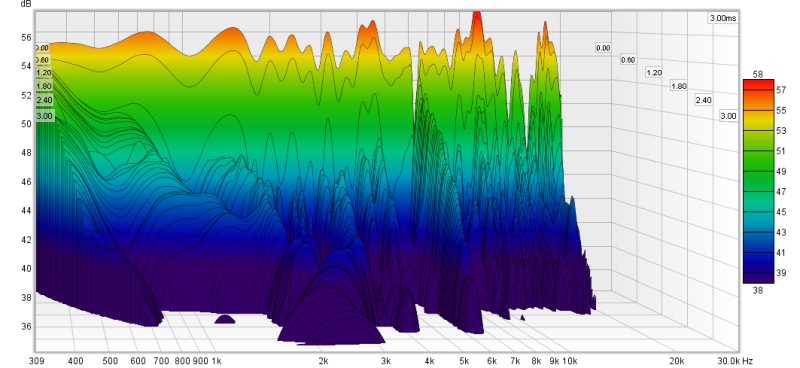

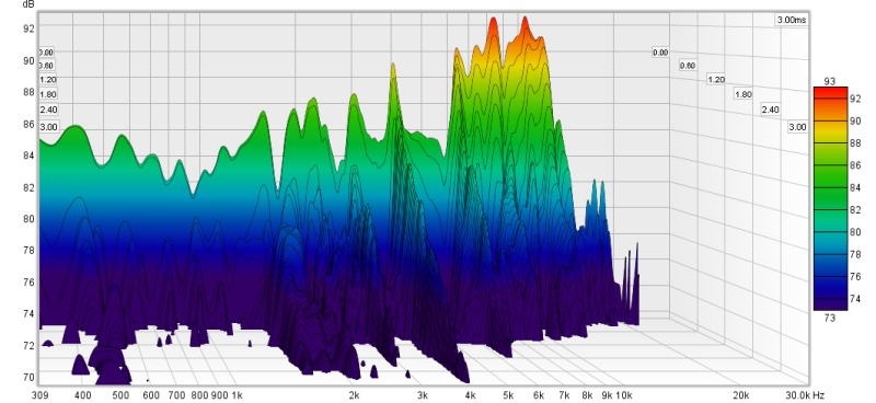

Here's a waterfall plot for the 12-250TC using foam as a lense to mod directivity with a first go at FIR:
