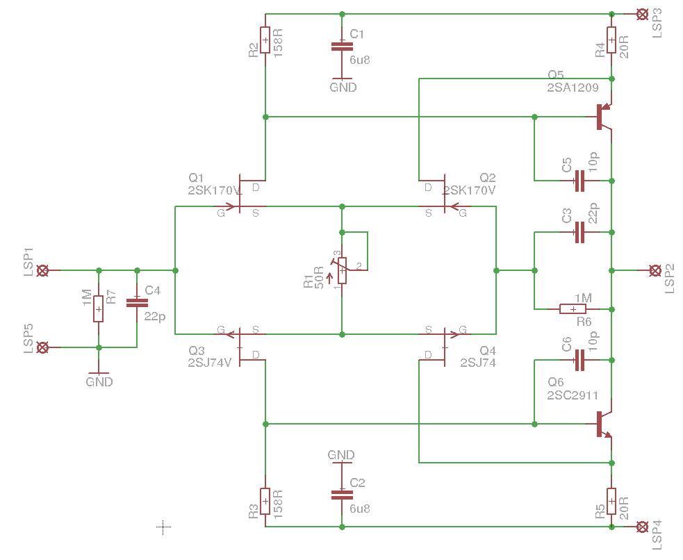

Attached is the schematic in it´s latest version (for now ;-) ), each Fet will run at 12mA, and the BJTs at about 50mA.
Next thing will be to change the capacitors to polypropylene types and to master Eagle PCB which is new to me (last time I used such a program it was running on DOS in the early 90ties ). I will report any progress here but it will take some time.

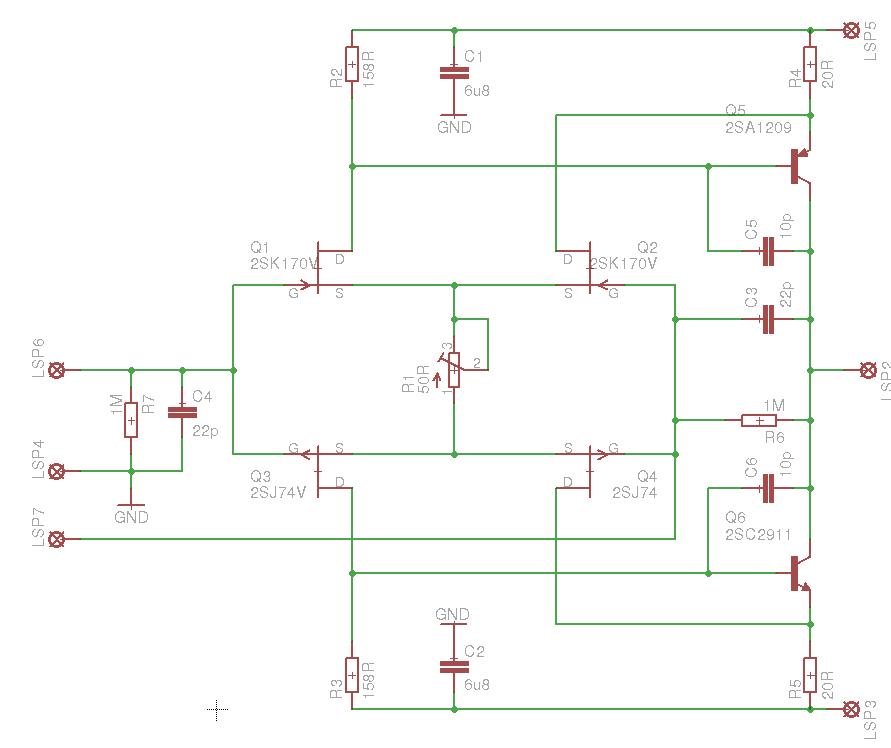

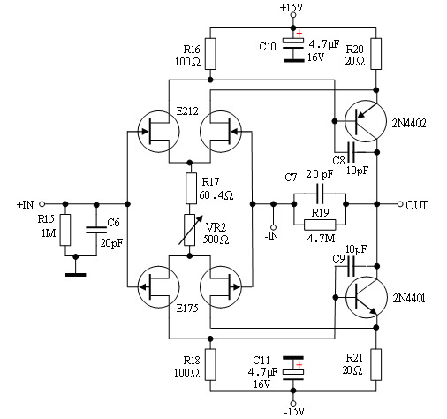

Andrew, did you actually read the thread ? (Post #131, Post #138, Post #148 ...)
Have you ever looked at the original schematic ? (see attachment)

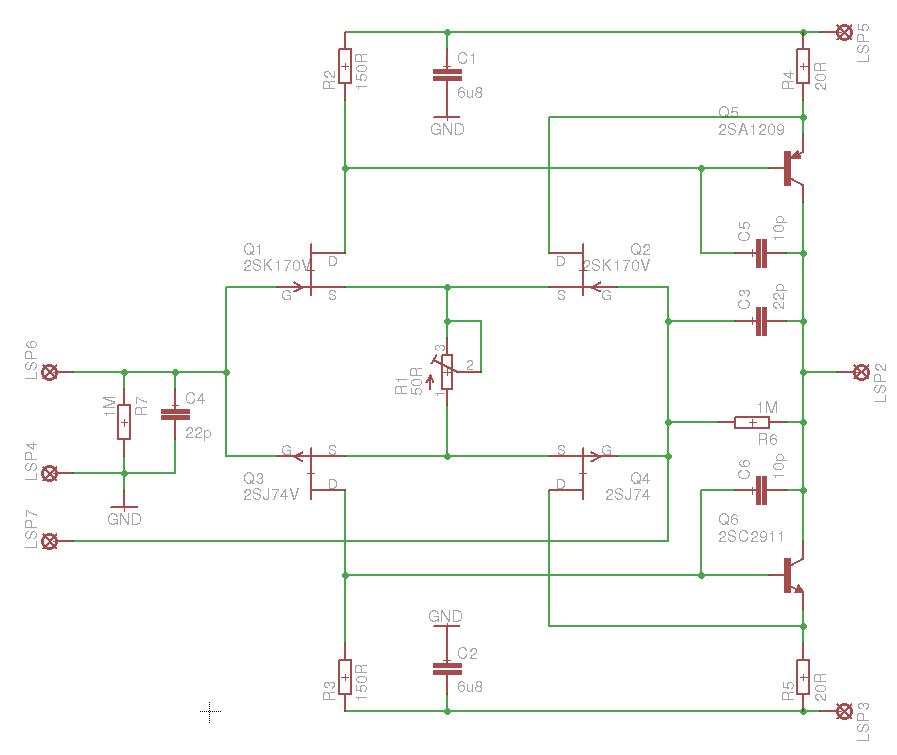

gk7 said:Oops, forgot the attachment.
It's annoying to see you still don't show the inverting input as externally connectable.
Sorry that you get annoyed so easily ;-)
But your´re right it was missing.
I have assigned the pin numbers like in my Post #76
AndrewT said:I am commenting on your latest schematic and reminding you to design in some adjustment to allow for parameter variations.
The original does not use such an adjustment and later Designs with this type of circuit (Parasound) do not use it. It´s obviously superfluous.
