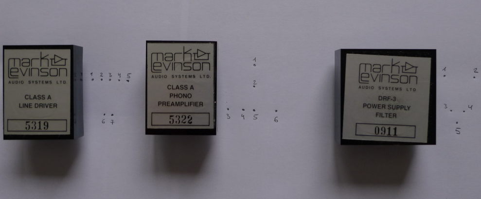

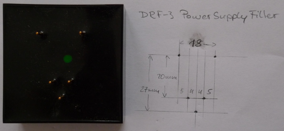

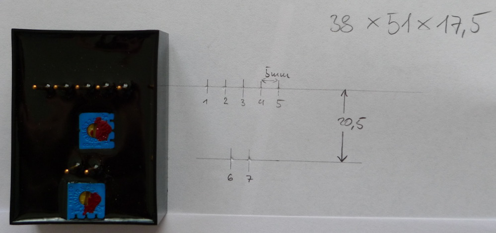

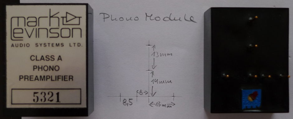

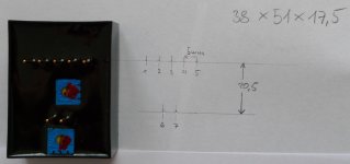

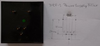

I have deliberately assigned numbers to the pins (see attachment).
Line Driver:
1 not connected
2 OUT
3 V- (-17V)
4 GND
5 V+ (+17V)
6 + IN
7 - IN
Phono:
1 + IN
2 V+ (+15V)
3 V- (-15V)
4 - IN
5 OUT
6 GND
Power Supply Filter:
1 -V out (-15V)
2 +V out (+15V)
3 -V in (-17V)
4 +V in (+17V)
5 GND
Line Driver:
1 not connected
2 OUT
3 V- (-17V)
4 GND
5 V+ (+17V)
6 + IN
7 - IN
Phono:
1 + IN
2 V+ (+15V)
3 V- (-15V)
4 - IN
5 OUT
6 GND
1 -V out (-15V)
2 +V out (+15V)
3 -V in (-17V)
4 +V in (+17V)
5 GND

If have placed the photos I made from the JC-2s inside here (they include a link to download the full resolution original too:
http://hal9000.at/JC-2/index.html

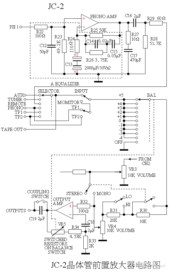

Capacitor replacement:
I refer to the part numbers used in the attached schematic.
C18a C18b (left and right) will be replaced by wire. In my ML-1 they are located on the copper side of the mainboard.
C16a, C16b, C19a and C19b will be replaced by polypropylene capacitors. These caps could be placed on the copper side (maximum diameter is then 15mm) or on top where the maximum diameter would be 20mm except for C19b which is between one line module and the power supply filter. This placement only allows for 14mm diameter.
Maximum length is 45mm.
Space limitations rule out most "boutique" capacitors.
These I use: Vishay-Roederstein MKP-1839 with 160 VDC
4.7 uF (41.5mm x 15.5mm) for C16a, C16b and
2.2 uF (31.5mm x 13mm) for C19a, C19b
