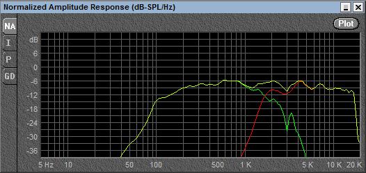

I have started playing with crossover simulation for the woofer & CD combo. This is mainly for fun / learning since I will measure the drivers when they arrive to try and crossover at the correct points to achieve smooth polar response.
Frequency graphs are copied using SPL trace, the CD + WG is from the driver vault (DE250 + OS waveguide) - should be more or less similar to the DDS waveguide.
I have attached graphs of frequency and phase response for the 2 drivers using the following crossovers:
woofer: 1.8khz 4th order LR
CD: 1.8Khz 2nd order LR

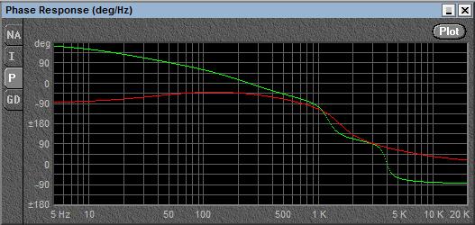

I'll admit that I have a poor understanding of phase shift in crossovers. I have used asymmetric slopes because this seemed to give me the smoothest response. However Im hoping someone could explain what is happening in the phase graph so that I can start to understand what it all means.

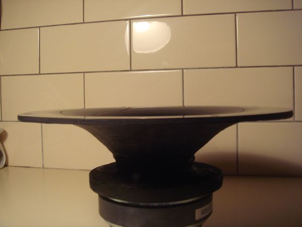

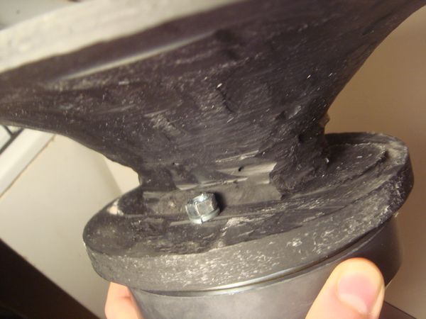

Drivers have arrived and the waveguides are better than I expected - quite rough on the back but very smooth and consistent where it counts. There are some bubbles and minor scratches on the external face but other than that I am happy.

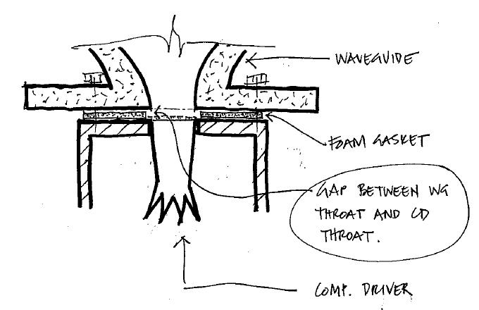

Only gripe is with the foam gasket on the comp driver - The hole is larger than the driver and WG throat. So when I connect them, there is an obvious gap. I drew up a sketch to illustrate the problem (please ignore the wacky scale). Perhaps I should remove the gasket to achieve a smoother transition?

Air leaks, particularly in the throat/neck of the horn, will kill its function. A gasket is required. Make/Buy a new one. Note, that when compressed, the gasket hole will become smaller.

Slope of the horn wall at entry should match that at the driver exit. Use of a gasket to achieve an air-tight seal is mandatory. An air-leak will kill the horn function.
Any physical discontinuity in the inner wall of the horn will be seen by the outbound wave as an acoustical impedance discontinuity. This will cause generation of a back wave and may trigger transverse standing wave modes within the horn as well. The severity of these conditions will be dependent on signal wavelength (frequency) and the dimensions of the discontinuity, particularly when they are of comparable magnitude.

The gap between the CD and WG throat is about 1mm. I will take some measurements once I have built the test cabinet. I can't see how a clean transition can be achieved without removing the mesh screen on the CD though - not too keen on doing that but maybe I will have to.

Do not mess with the bug screen. Just make sure you have a air tight seal between the horn and driver.
