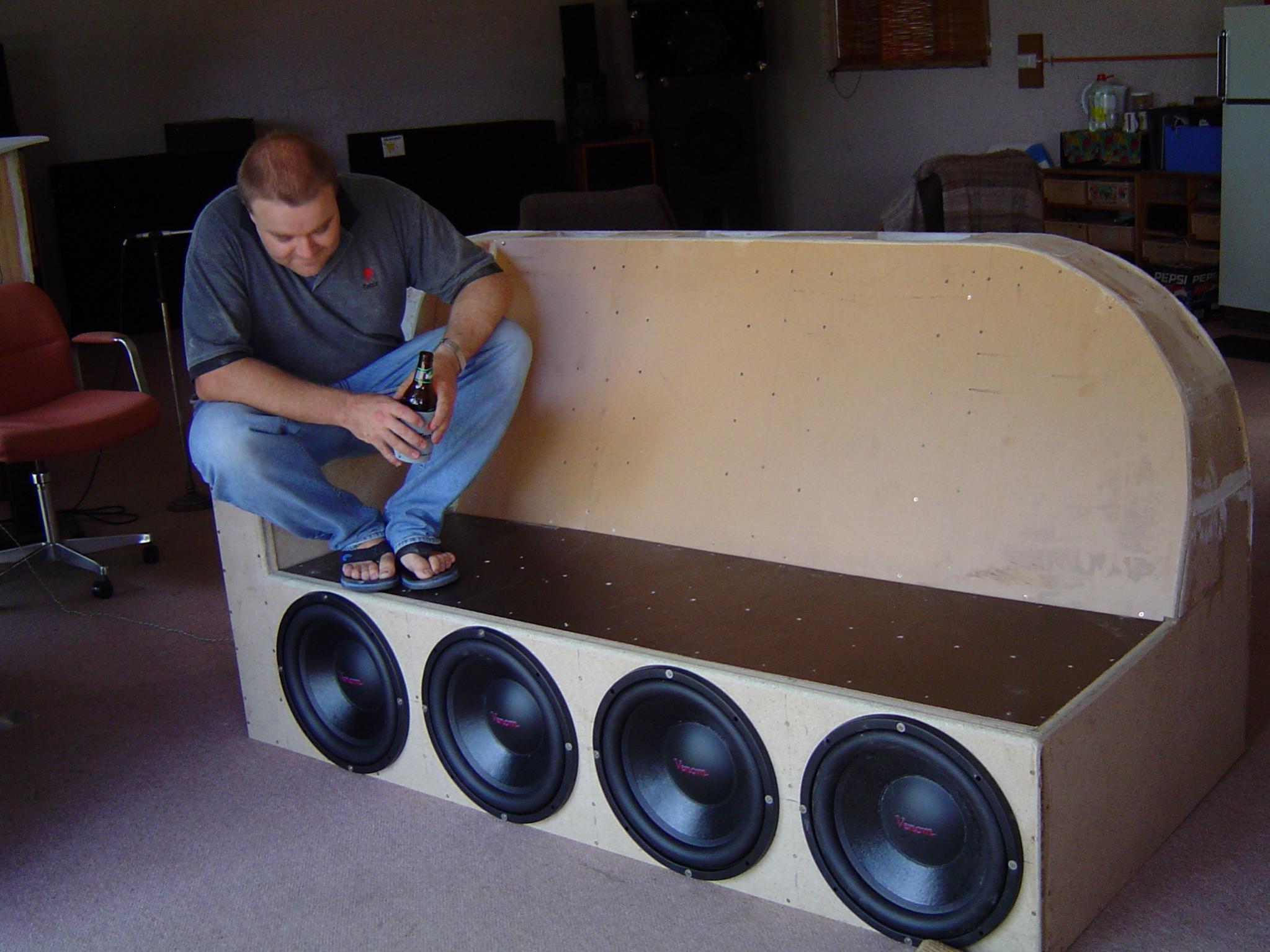

If you want seriously loud bass I can offer a couple of tips:
-1- Dirty big horns (built some 25Hz horn loaded subs using 18" PA drivers few years back). For efficiency with decent - for a sub - bandwidth I kind of doubt there is a better way.
The photo has one of the pair of subs (hey - if you are gonna build one, you might as well build two!), and I also needed to acoustically couple them to achieve decent output to 25Hz. The chair does give some sense of scale, but in my "play room" which was 40 by 40 feet, you could FEEL the bass in your guts. Hilarious.
or:
-2- Get up close and personal with the subs. the photo of the couch has 4*15" subs in it. It is 800 litres in volume, and is ported out the top of the couch. Tuned to 18Hz, and has a 3dB point of 19Hz. The amplifier provides 250W into each driver. Crossed at 70-80Hz, it is surprising how little you can sense the location of the sub - even though you are sitting on it.
It is probably one of the dumbest things I have built, but it was on a bet. I never did collect on that....
