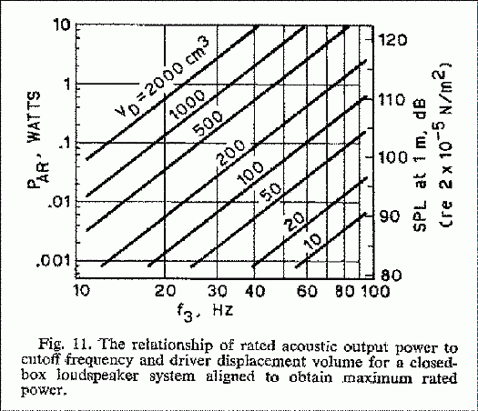

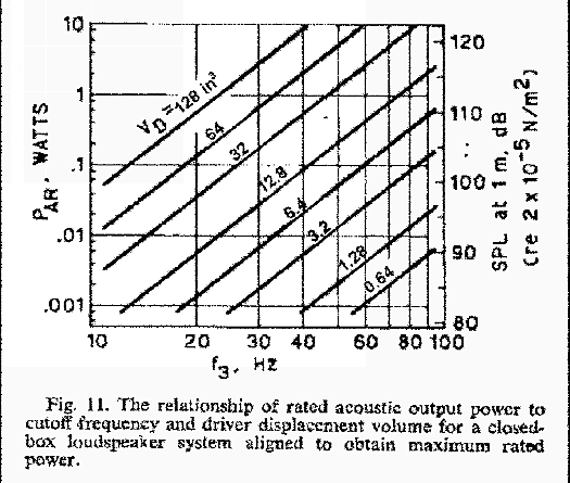

Here is the chart taken from Richard Small's article for volume displacement for SPL at various low frequencies:

The way it works is that the SPL at a given frequency goes up 12 dB when you quadruple the displacement.
Let's try for 30 Hz-we can always back off down to 40 Hz if we need to.
At 30 Hz, 128 cu in gives us 117 dB.
So, 512 cu in gives us 129 dB.
So, 2048 cu in gives 141 dB.
That means that, using closed boxes, we would need the cone area times the displacement to equal 2048 cu inches.
Assuming a one inch throw on a PA speaker, that means a cone area in a closed box of 2048 square inches. Considering a 15 inch speaker has a cone area of 130 sq inches or so, that means you would need about sixteen 15 inchers to achieve 140 dB @30 Hz.
diyAudio Moderator Emeritus
Joined 2001
Assuming you don't want to do that, there are things you can do.
A. You can move your target frequency up to 40 Hz;
B. You can use ported enclosures, which change things in your favor.
Let's see what the displacement is for 140 dB at 40 Hz instead of 30 Hz. As we can see, 128 cu inches gives us 122 dB.
512 cu inches gives us 134 dB.
1024 cu inches gives us 140 dB. (Double the displacement = +6 dB).
Assuming a one inch travel on a PA speaker, that means 1024 sq inches, or about eight 15 inchers.
That is in a closed box.
However, if you use a vented box with a Qts of 0.38 or so, you can cut that displacement requirement by 4. Instead of a cone area of 1024 sq inches, (assuming a one inch throw on your PA speaker), you now need only one quarter as much, 256 sq inches. Since most 15's have a cone area around 130 sq inches, you should be able to get this done with two vented box 15 inch PA speakers, with a one inch throw, with a Qts around 0.38, a box volume equal to the speaker's Vas and tuned to 40 Hz or so.
