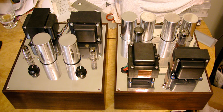

The choke in the old stereo supply wasn't that good and not built to the level of Bud's. I'm sure the old stereo circuit somehow filtered more but maybe something else is affecting it. The ripple is nearly to the volt on each side. Bud's iron is really overbuilt and wonderfully shielded. Here's a pic of the pre.

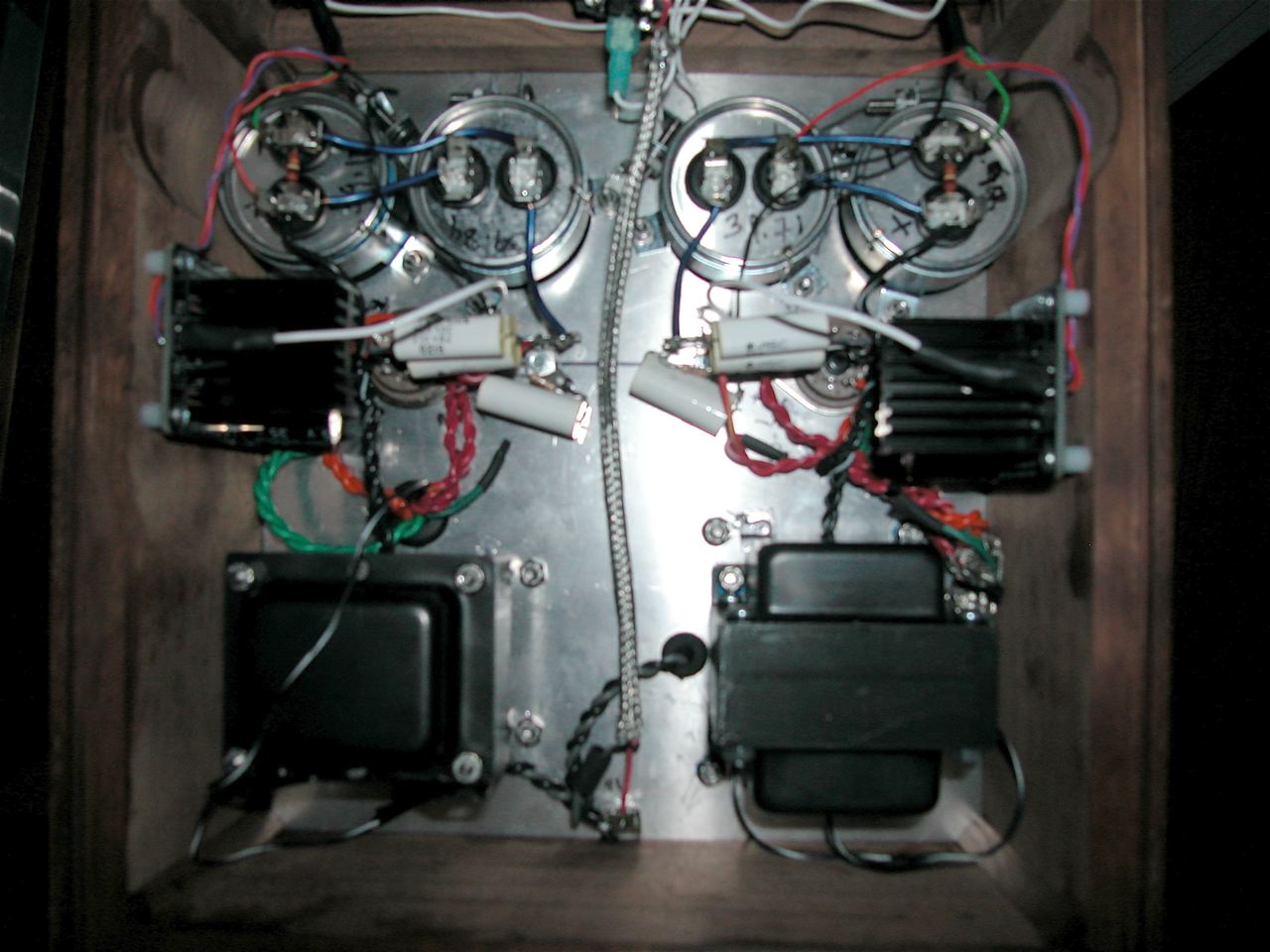

I found enough caps to parallel. Voltages are set. Now I have to deal with ripple. I don't know if it was an effect but now with the C1 in there @ .32uF I'm getting .3vac ripple whereas before on the board with the choke loaded regulated supply I had .045vac
Any tips on exploring possible causes is greatly appreciated.
Judging by your photo of the underside of the PSU, I'd wonder whether you are suffering from 'ground bounce' due to your physical layout.
Basically in a PSU you don't want star grounding throughout, which appear to be what you have built. The problem is that unless you get the 'star' electrically *perfect*, you may accidentally include some of the ground currents from the first capacitor in your output voltage.
What you want is two 'common grounds'. The first one is at the bottom of C1. From here goes a connection directly to the transformer center tap, a connection to the bottom of C1, and a short wire to the second ground 'star'.
The second 'star' connects to the first as just described, to the bottom of C2/C3, the 100uF in total filter caps, and the output connector to the amp itself. The 100 ohm resistor in your photo looks to be a ground loop breaker, which presumably goes to the chassis. If this is so, then it need to be connected to the second star, at the bottom of C2/C3.
The wire between the two stars can be quite short, an inch or two is plenty, and the two physical stars can be quite close together if needed. You could for instance build a new, second star on the terminal of one of the filter caps.
The point of this exercise is to make 100% certain that none of the current through C1 is running through the output ground connection. Right now it looks like this is what you are doing.

There is another potential problem with your physical layout. You have the two wires going to the chokes twisted tightly together. There is a large electric AC field across those two wires, and even a small amount of capacitive coupling between them is enough to couple hum to the output. It probably doesn't help either that the wires are passing close to the heating and HT secondary wires.
You need to think of the choke as an isolator, with everything relating to the rectifiers and C1 on one side, and the output caps and the load at the other. Use longer connecting wires if needed, and minimize stray capacitance between the two sides. 10-20pF in the wrong place is enough to ruin your day.
Additionally it looks like the chokes are directly below the mains transformers, even though you have attempted to locate them so as to minimize the coupling of the stray magnetic fields. One simple test might be to temporarily pull one choke out of the chassis on long connecting wires and see if that changes anything.

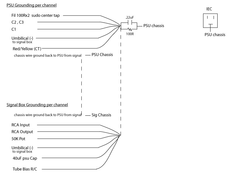

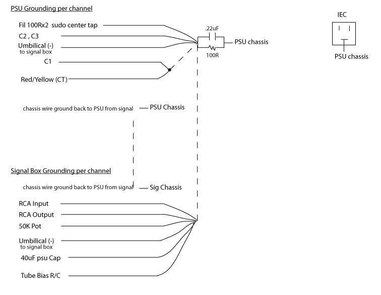

Frank's suggested wiring
Just want to make sure this is what you meant before I do it. If they become connected anyway I'm not clear on how just having a second star would shunt off some ripple or ground bounce but I always want to learn.

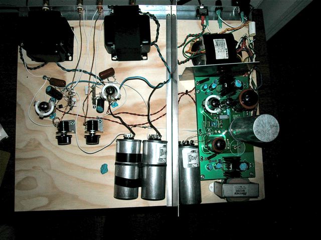

Original circuit on wood
I found a shot of it on the test board as reference. As you can see it was a different PSU and the iron was far apart from each other. Very close quarters now. I had the exact same grounding as shown in my drawing. I suspect I have something radiating in this build.

While Kevin is typing his explanation, I might jump in with another suggestion. ;) I'd completely remove the 0.22uF in parallel with the 100 ohm, the ground loop breaker. Instead I'd use a pair of back-to-back diodes in that spot. Something cheap and hefty, like 3-5A: 1n5408 etc.
The ground loop breaker's job is to *not* conduct anything during normal operation, least of all AC signals. You don't want a cap there. Instead the pair of diodes has a voltage jump of 0.7V in both directions, which needs to be exceeded before any noise can pass through. The job of the ground loop breaker is to only conduct when an error occurs, like a problem that might blow a fuse or similar.

When you said 'back to back' you mean each diode going in opposite directions? I have not experimented with that. I have tried the method I'm using and just a resistor without the cap and this one always provided better results. I can try this when I try your new grounding scheme provided I understand the orientation.
Yes, exactly. If your grounding is done properly, then you shouldn't be able to hear the ground loop breaker, unless it isn't there at all.

Kevin could you explain how Frank's method is shunting to ground better so there's no bounce? I'm having a hard time thinking on it. Yes, I agree, there is more probably going on. The 60 cycle sounds like transformer coupling.
Actually my concern relates the charging currents in C1. Frank's connection as shown provides a tight loop for the high charging currents in C1 and prevents wiring induced IR drops from modulating your grounds with ripple voltage induced by the charging current in that first cap. It may or may not make a subtle difference depending on the application, but the higher the charging currents the more important it becomes to segregate these charging currents from the rest of the ground circuitry.
