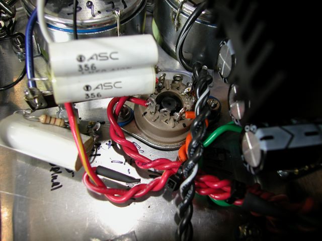

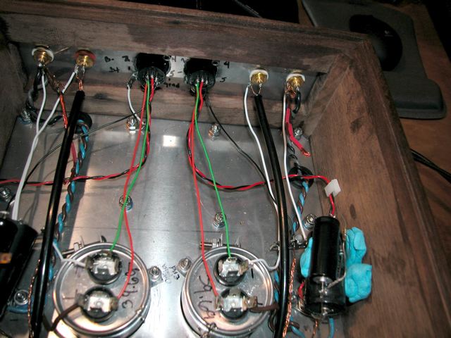

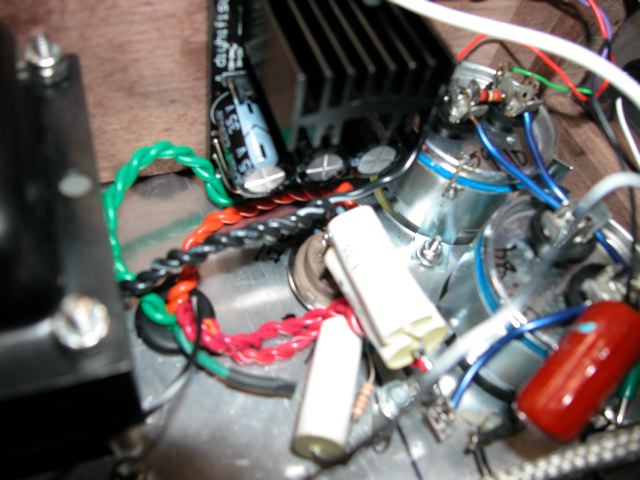

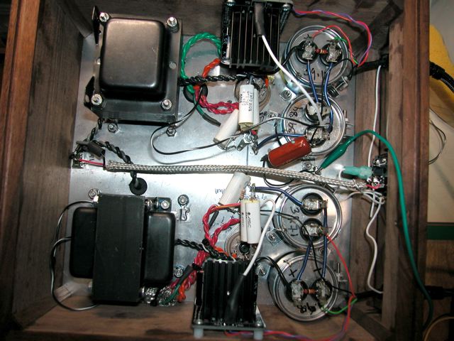

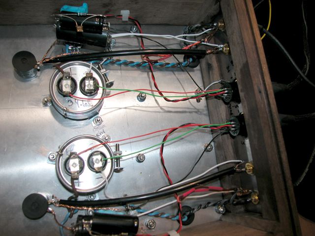

wiring shots 1
So far -- I unscrewed one channel choke and trans. My homemade ac probe didn't work. I new started playing orientation in every which way. Zero. I even had enough length to get the one choke out of the box. Zero. Turning the trans in one side made the ripple increase slightly. Nothing I did with the choke had any effect on the hum or ripple.
Tomorrow I will undo the output transformers and rotate them but I have a feeling something else is going on. Changing the orientations should have had some effect on the hum but it did not.

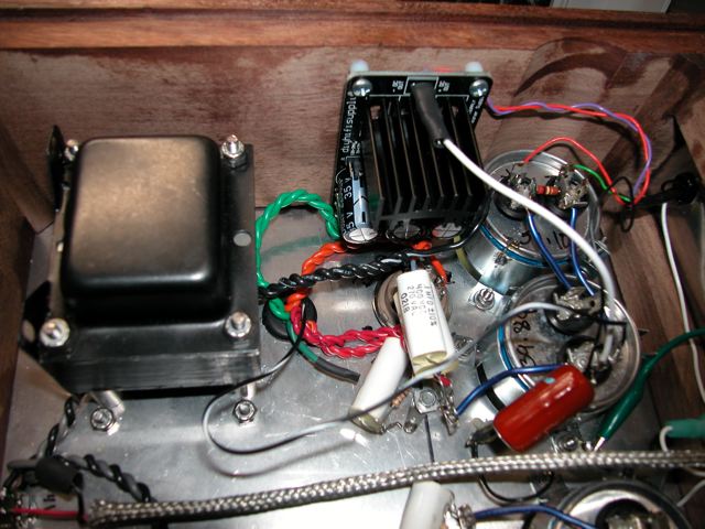

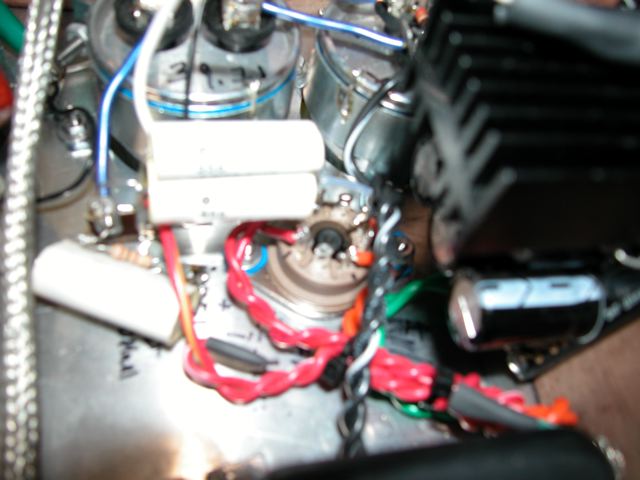

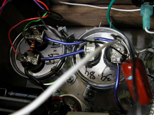

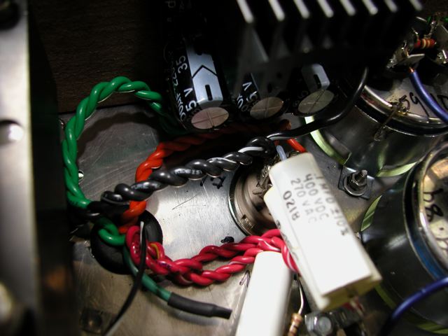

Here's a bunch of photos in case one of you can spot something obvious.

All good things to try, might want to lengthen wires and move the output transformers further away from everything and see what effect that has on the noise. I expect this could be quite significant. I build a lot of transformer coupled things, and the power supplies are generally located on separate chassis or I get some noise.
If no significant improvement you might still want to try the chokes you used in the prototype.
As you can see its two chassis. OTs are in the signal box. If you look at the picture of the prototype the choke is very far away from the trans but right beside the PCB. Again that choke is gone. If these were coupling shouldn't I have heard something once I changed all the orientation? I certainly have in the past. Moving a transformer around to find a null point was within 1/4 inch at times. These trans are build as isolation transformers and heavily shielded.
Since I could move the choke ALL around the internal chassis and no change in hum I'm kind of discounting them for the time being. One of the odd audio mysteries...
I took the time to do as much measuring as I could. I found a couple things. One rectifier socket was carrying 1vac because it didn't have connection with chassis (I have the on isolation dampening pads. Whereas the other has some connection with ground and it doesn't show AC. Ground it resolved the AC but didn't affect the hum.
The other thing I found was the CCS filament heat sinks had 1.35/1.8 vac on them. I'm a little concerned to just ground them as I don't know if that would harm the regulator.
These are ones I bought. DIYHFS Ultra Low Noise Filament Supply (Rev B2) 2-12V - eBay (item 230541340155 end time Mar-20-11 21:36:32 PDT) Although I didn't pay what they're asking now. :)
Would it be ok to ground those?
