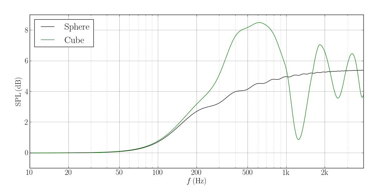

I still believe that those peaks are out of band. Could you plot both on the same plot using something more comparable like a sphere of the same volume as the enclosure with a driver size more like a real driver. I am willing to bet that below 500 Hz the two will not differ by more than one dB. In my work I fit between 200-300 Hz, sometimes as high as 400 Hz, never 500 Hz.
Here is a comparison with a cube of the same volume as the sphere. Specifically, a cube of side L=48cm. This is a good check of the very-low-frequency behaviour of any diffraction algorithm. Anyhow, we approach a 1dB error at about 250Hz. So, your claim about the 1dB deviation at 500Hz would certainly hold for a cube of side L=48/2=24cm.

Hi Jeff,
I agree that your blending will be perfect if its done over the range where diffraction is accurate. However, if, for example, the modeled diffraction makes an error X dB at 80Hz, then I think your anechoic reconstruction will also have the same X dB error at 80Hz.

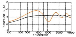

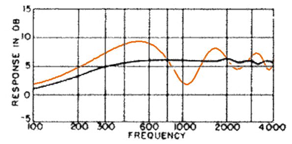

Ah, Jeff beat me to it... but here is another more crude plot, attached. I superimposed Olson's figure for the 24" wide sphere on top of a simulation of the response from a 2" diameter driver centered on a 24"H, 24"W cube that I calculated using a popular baffle diffraction simulator from the DIY community. The message is the same regarding the lowest frequency peak in the oscillations, here around 500Hz.
For my measurements, I blend them together starting at 200-300Hz and going up to 800-1000Hz. This is right where the big hump is located. The errors in the DIY model below 200Hz are inconsequential because they are below the blending zone causing the data to be taken from the nearfield measurement only.
It's interesting to compare the result here with that generated using the eigenfunction expansion... although we are using different sized objects. Thanks for posting that, Jeff. Maybe we can overlay the two models for the same size object?

I responded to Jeff B. along these lines already. I would say errors in the DIY diffraction model are of no consequence above the blending region. Below the blending region, however, you are still using the diffraction gain curve to correct the nearfield. Typically there is still gain at 100Hz. In other words, if the diffraction gain curve goes totally crazy at 100Hz, then your reconstructed anechoic response will also go crazy at 100Hz. The 3rd plot in post 47 illustrates the effect.
