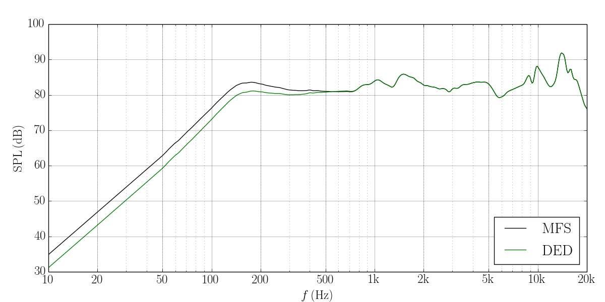

Hi Andrew.Just downloaded the paper and read it.
Yes, its unfortunate that some aspects of the paper are far from transparent. The method in practice also has some convergence subtleties that require care in application. Despite that you seem to have gleaned the implications of a number of the results. Let me emphasize that a good deal of the results are not new but were of course known earlier. For example, that nearfield measurements are not diffraction-free at all wavelengths was discovered (or at least documented) first by Vanderkooy. So really I just used the method to corroborate these earlier results and extend them a bit to more realistic geometry.

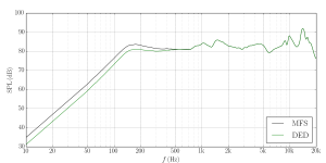

In the context of the present discussion, it might be useful to illustrate the typical sort of "incorrect" reconstruction to be expected from methods which have significant low-frequency error. So, below I show a few plots which illustrate how reconstructions differ when using (1) the MFS method and (2) the DED method (which is a more recent high-frequency approach by Urban, et al, JAES 52 (2004) 1043).
This is an easy example -- its a small full-range speaker (the Zaph Hi-Vi B3S single driver system) so the room is effectively "large". The microphone was closer than 1m so the level is slightly higher than the true SPL at 2.83V/1m.

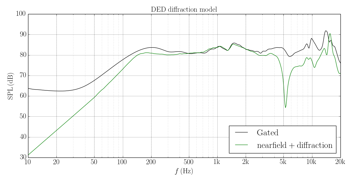

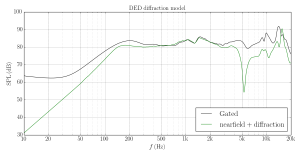

- The first plot shows the quality of overlap between (a) the nearfield+diffraction data and (b) gated farfield for the DED model. The overlap seems good from about 500Hz to 1kHz. The nearfield level was adjusted to match the farfield, on average, from 400-800Hz.

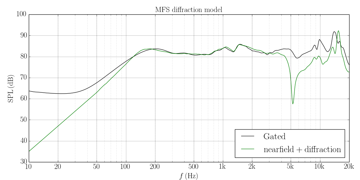

- The second plot shows the same overlap test for the MFS method (which is accurate down to 0Hz). Now the agreement is good from about 120Hz to 2kHz. Much better.
- The third plot shows the bottom line; namely, the final reconstructions of the anechoic response. Here we find the DED method underestimates the response everywhere below about 500Hz. Indeed, if you look at Zaph's reconstructed response, you see the flatness below 500Hz characteristic of the DED method, not the peak at 150Hz seen in MFS.

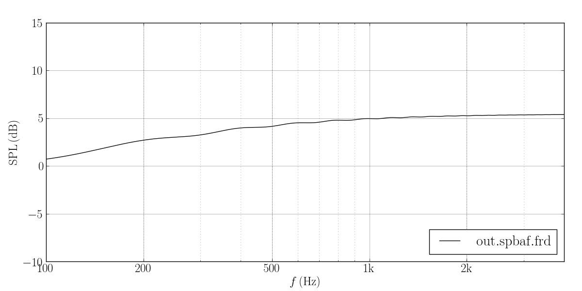

Here is a plot of the diffraction gain computed for a point source on a sphere of diameter 24" (radius=30cm) measured at a distance of 2m from the point source along the axis of the point source. The result agrees pretty well with Olson. The calculation method is straightforward eigenfunction expansion (using 90 Legendre harmonics). The gain here misses the very large primary (and secondary) peaks and dips of the rectangular enclosure.A speaker that small and a sphere that big would not show much ripple. A larger speaker or smaller sphere would.
I still believe that those peaks are out of band. Could you plot both on the same plot using something more comparable like a sphere of the same volume as the enclosure with a driver size more like a real driver. I am willing to bet that below 500 Hz the two will not differ by more than one dB. In my work I fit between 200-300 Hz, sometimes as high as 400 Hz, never 500 Hz.
That would be my concern - the primary baffle peak above the step frequency. Since we all tend to use rectilinear boxes we will almost always have to deal with some significant baffle diffraction peaking at the top of the 4Pi - 2Pi transition. This peak contributes to, and extends the step in amplitude. And its presence is part of what I am using to align the near-field and far-field response data with.
I recognize the potential errors in my model at lower frequencies, but there is a point where near-field data is full blended and that is controlling the level, not the diffraction model. What I need is reasonable accuracy in the 150 - 1200 Hz range to establish the correct alignment for blending the data.
