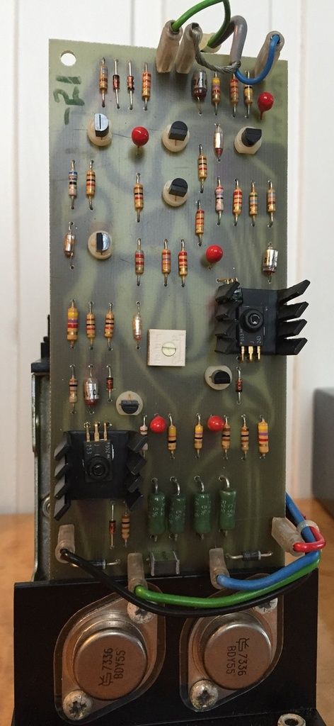

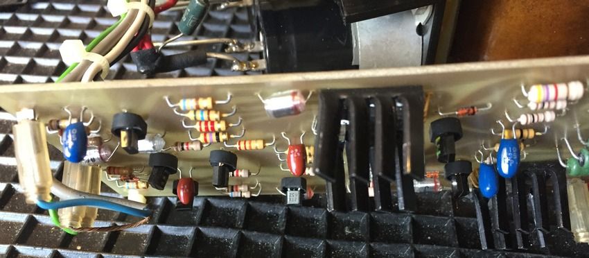

It was in fact not the NAP140, but the NAP120 (dated from 1976) which had the bias transistor connected to one of the drivers (of the darlington side).
The circuit is pretty similar to all other older Naim amps, besides of the VAS transistor, which seemingly was no ZTX type.

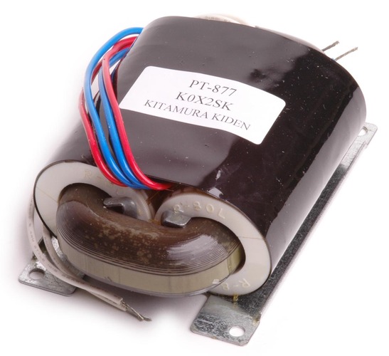

I use most often "double C" processors vintage(like Partridge or Marconi construction) and when I find second-hand, R-core from selectronic (which no longer exists), with a little patience, we find in wrecks of B & O beautiful double C transformers too and very good quality.

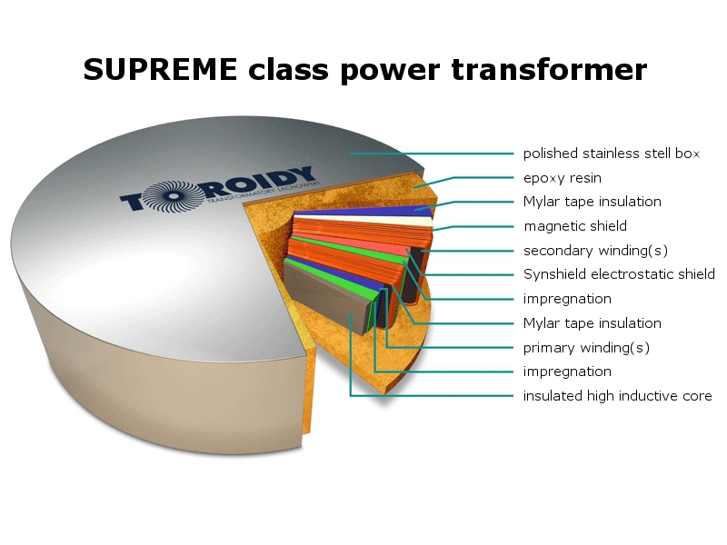

In a toroidal transformer the primary and secondary windings are coaxial and have relatively high capacitive coupling. On the other hand the leakage inductance is smaller. The coupling can be mitigated using a grounded shield.
A fundamental consideration is that of the capacitive coupling of the two windings, which can have very important effects on the general musicality of an audio electronics.
In my tube constructions I use only R-Core transformers, but since they are low power preamps, I never have problems of availability.
Obviously, however, when it comes to power ratings above 100/200 VA, the situation changes and there are major problems with the availability of R-Core transformers.
But personally I solve happily with toroidal transformers of the Audio Grade type, resin-coated and obviously equipped with a grounding screen (which effectively solves the problem of capacitive coupling) of Polish production.

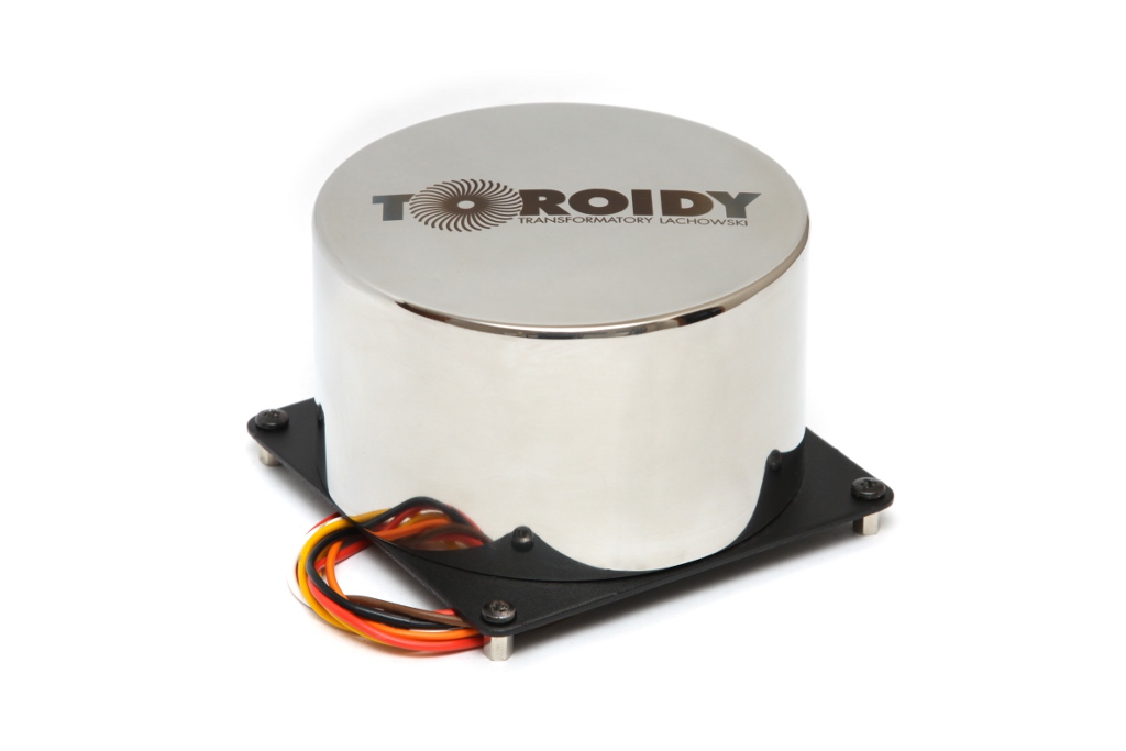

Any idea if the Toroidy Supreme is actually any different to the Toroidy Audio grade in terms of core and windings? Or is it the same thing in a nice case for double the price?
Unfortunately Toroidy don't seem to publish any figures for regulation, so it's hard to work out how good they really are. They also seem remarkably compact compared to the same VA rating from Canterbury Windings.
