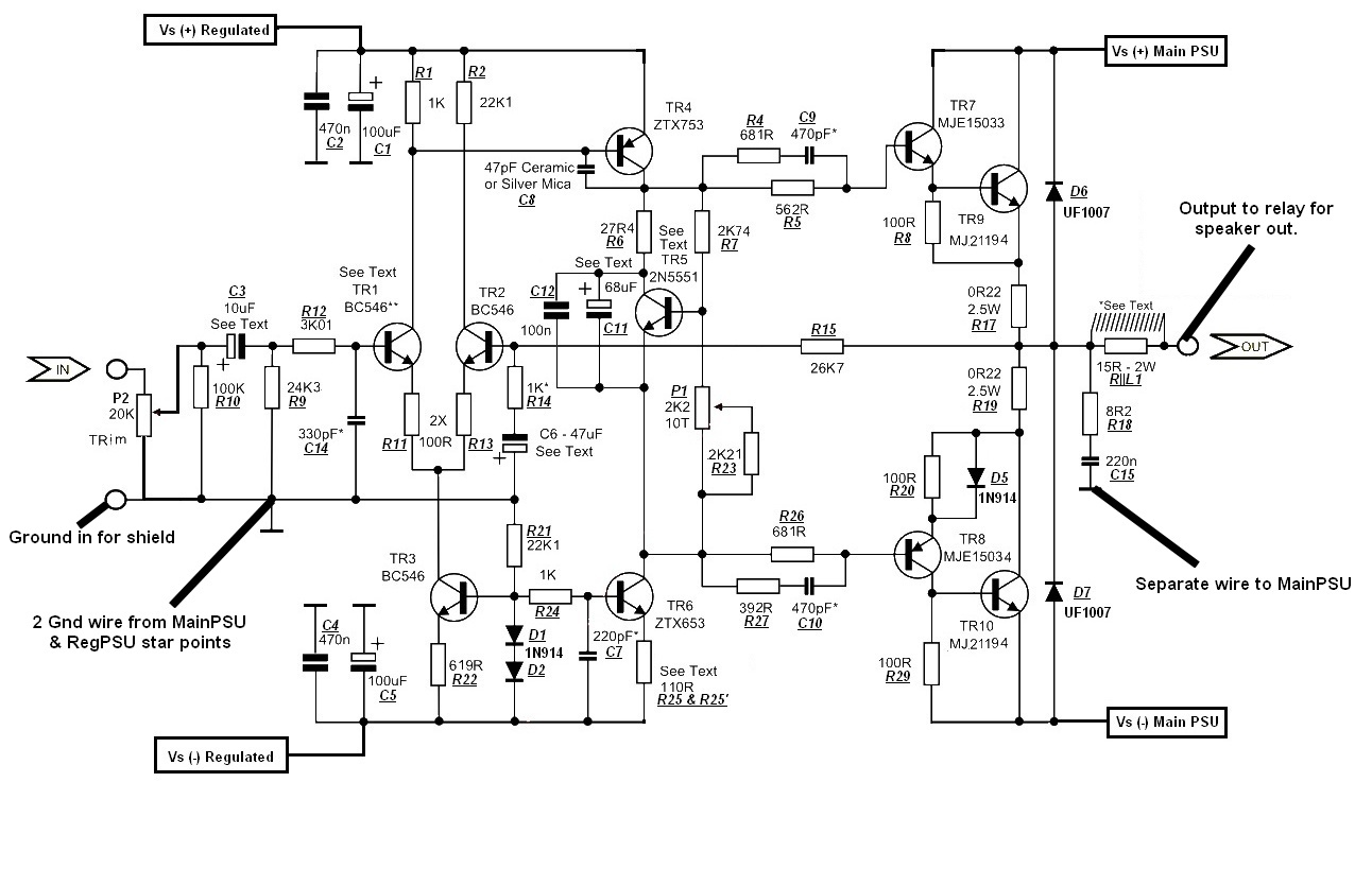

Ian do you think it worth to try the separate front power supply with regulated PS based on these schematics.
Please let me know what do you think

Hi Gabor. No, I don't think this is the way to go with simple Lin-Thompson topology, like all NAP and early Nait series models. The front end actually interacts with the output stage via the supply rails, as Rensli just alluded to. He went through this learning experience some time back and it echos what others have said about using refinements which isolate the power supplies for the 3 stages - particularly those designs that have been tweaked in more than one stage for best harmonic profile. It will screw that up completely and leave you with the sound quality of typical text book designs from the 1970s. In one my own tests on a clone of mine, I had clean and crisp sound but it sounded disappointing by comparison - no PRT effects etc.
Hugh Dean reminded of this interaction effect when discussing his own designs up to to the NAKSA 80 stage several years ago now and I know he has a lot more experience with using the principle to best advantage than any of us here. I don't pretend to be an audiophile or designer but I can say that Naim sound depends on this effect as well as a couple of other features that seem contrary to good engineering practice.
Naim designs have probably been denounced for technical reasons ever since Julian Vereker tinkered with an original prototype to come up with the first series NAP200 and 250. Still, they sounded much better to him and his supporters, than the designs they were based on and the competition. He was self-taught and his methods had little of the restraint that would have come with formal studies in electronics but the resulting demand for products continues to speak for itself.

It is always interesting to experiment, but I am also convinced that the power supply is separate and moreover stabilized (with the inevitable negative feed-back that in dynamic operation would be inserted directly on the signal line, in the delicate stage of initial voltage preamplification ) would not bring any advantage but only heavy consequences.
As foreseen in the original project, the separation between the preamp stage and the power stage, thanks to the two diodes placed on the two power lines, is already an efficient and perfect solution, in order not to bring the perpeters from the power stage to the delicate one of the pre-amplification stage.
Same goes for the AKSA amplifier and many others of similar topology.

Gaborbela was suggesting to remove the current limiting circuit. It has contribution to safety, not sound.
Actually, it does improve the sound significantly when I removed the current limiting circuit from an Ebay purchased (Jims Audio) kit.
Of course, when I found the NCC200 circuit I converted my Naim clone to that.
You will lose some of the tube-like warmish sounds in exchange better dynamic cleaner mid-bass more control more authority.
To those who want NAIM like sounds better to keep your close as close as possible to the Naim circuit. :)
