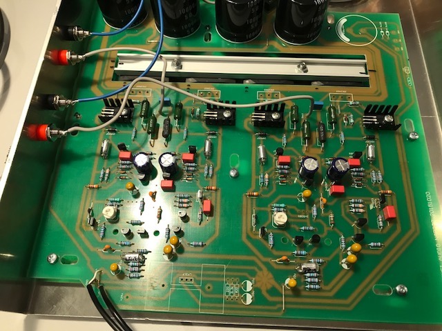

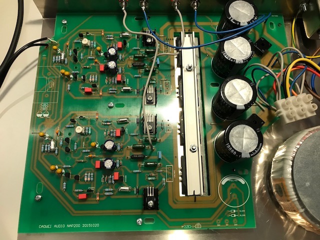

Very nice. But that will not answer my question if it is ok the the Transistors ZTX753 & ZTX653 are getting hot ( around 60°C). Is there a manual available for the adjustment procedure or a nap200 schematic?
There are lot of discussions about nap200 clones here, you need to spend a good amount of time to read them, I believe many of your questions have already been answered in the past. Check posts around years 2015-2016. If amp is working, there is no reason to think that they were installed incorrectly, otherwise they may have blown already. You may want to find NOS versions of those transistors, your versions are probably cheap Chinese versions.

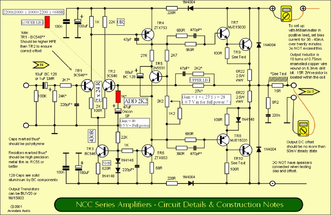

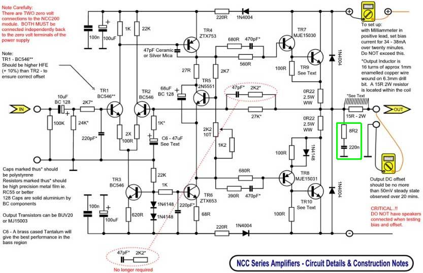

This kit should have its own thread by now. The NAP 200 is not the same as older NAP designs . Earlier here, more than a year ago when the NAP200 kit was new, member algar_emi reverse-engineered the schematic and posted hand-drawn diagrams. I'm not going to search for it again but the pics of the kit are large format and can be easily identified among other posts about NAP140 kits.

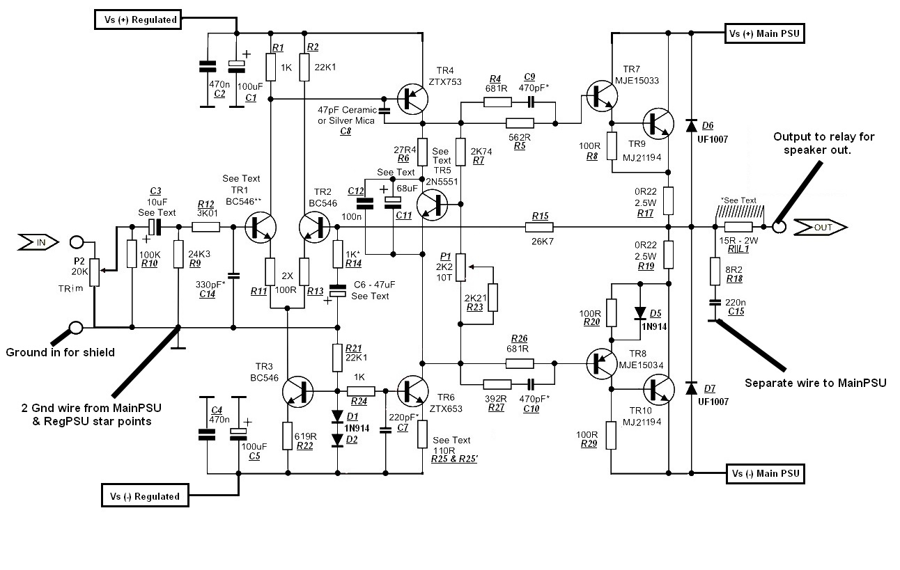

NAP designs always have VI limiter circuits for protection, i.e. TR6,7 on the various generic type schematics shown in post #2797 above. These are the only form of protection specified and Naim never used relays for good reasons - regardless of the generalised objections to limiters affecting the sound. The NAP200 is a newer design, developed with some advanced PCB layout techniques and dual slope VI limiters which more closely follow the curve of the specific original types of power transistor's Safe Operating Area. They are a 2 transistor design here, applied to both positive and negative output voltage swings. That's why you find 15 rather than 13 transistors in each power amplifier. The limiter transistors marked and supplied with my kit by Caowei are 2N5087/5089. I don't know how other brand PCBs are marked but these are not critical parts and the originals may have been MPSA06/56 which are obsolete.
Re: alignment of ZTX653/753. Look at the PCB and note the shape of the transistor outline which should have a flat side and a side with a radius to each side edge. Compare this with the standard E-line package transistor outline and your eyes or sense of touch will tell you which way is the correct alignment. (also see attached diagram which the same for either type).
If you need to know the pin assignement of any transistor, simply type the part number followed by "pinout" into your browser's search engine. Barring the possibility that some manufacturers messed with this on a number of BC (Prolectron series) transistors for their own reasons - it works for me and takes very little time.
