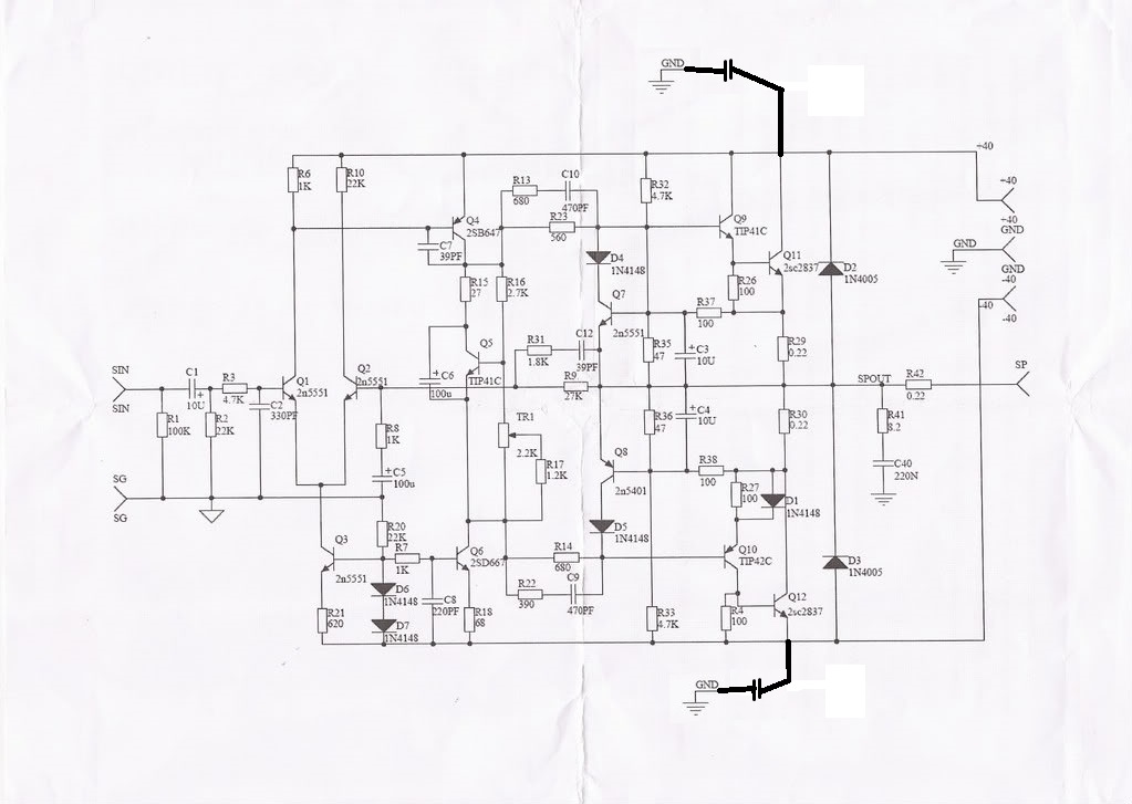

I know very well this schema ,the original creator is Bernard Corde in the 70" or 60"
the original schematic

You certainly wouldn't want to put a cap from base or emitter to ground though (and that's what two of the transistors appear to have in your illustration).
Agree...those caps, if used, should connect to the negative rail.
BUT I wouldn't add any caps unless you are sure why you are doing it and you know your way around caps. Otherwise I'd leave it in the original Naim arrangement; Naim did not choose use bypasses for good reason.

As far as I can see, this is how the suggested connections go (excuse my crude drawing) - the illustration also has two extra output transistors.
I'm fairly certain the board I have already has these caps on board.
I just checked my boards (10 years on and still incomplete!!!) and they do indeed have places for caps - just not those caps... They are caps for the driver stages (c1 and c2 in the image - not yet fitted!)

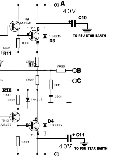

I believe I posted a pic of that mod. done correctly to the Nait2 here some years ago. It states bypass capacitors but I believe they are decoupling the DC supplies to the the output transistors, lowering impedance and distortion. There's no reason they won't be more effective on larger old series NAP models too as they tend to have long straight power supply leads which degrade noise performance and supply quality. You might consider whether this will be sympathetic to Naim sound quality and if you go ahead, larger caps than those suggested for the little Nait are advisable. For an amplifier built as a higher power type like NAP160, 180 or an unregulated 250, I think 1,000-1,500ufd 50V caps would be good in a mid-low ESR type like Panasonic FC.
Chinese NAP140 clone boards actually follow the NAP250 schematic and suggest supply voltages which are for a regulated supply amplifier running off +/- 40V rails. The NAP 140 could use the same PCB with appropriate lower, unregulated +/- 34V supply voltages, a few changes to the small transistor types, and the RC networks in the driver transistor bases. It seems though, most builders just follow the kit suggestions with the wrong schematic, and wind with a odd mix of substitute parts in a NAP250 design that really doesn't sound much good.
When you replace the VAS transistors with original ZTX653/753 types and carefully select substitutes for the obsolete small signal types, things begin get better. or closer to the Naim sound. So what about Naim sound? Well I guess you make your choice and build what you like even if its not like anything original. We do like to tinker and experiment to see what sound effects we can make by fitting wrong parts anyway - I guess its all fun if nobody gets hurt and no damage is done ;)
I've been looking at that decoupling mod for the Nap140 too and have gotten me some low ESR Panasonics rated to 50v to test.
Is C11 a bad idea?
(The schematic is from the Acoustica mod list).

That's interesting - something I've considered myself for a small amplifier but I've been too lazy to lay out a PCB that would fit an appropriate case. There is a hand drawn schematic with the appropriate components for the complete Nait on the web if you Google it. That gives you the original NAP90 power amplifier schematic, suitable parts and grades too if you check the NAP 90 pics there, as I imagine you already have.
Comments about the transistor types still apply though and a high gain, mismatched long tailed pair is a trick h[/I] to get the DC offset acceptable.
