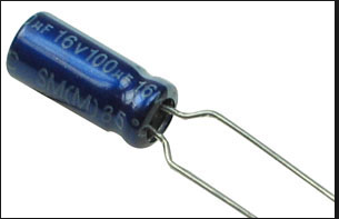

Agreed. Provided we select the right polarity of an electrolytic cap to suit the DC potential difference between TR2 base and ground, we can use any standard electrolytic cap for the FB cap. Note that the polarity shown on the schematic will likely be wrong so measure and prove it for yourself.
Naim just happened to like the idea of TAG tantalum caps because they were cool and new to audio, 45 years ago when the product was developed. You'll find standard, 100uF 16-25V electrolytics will fit most clone PCBs and you can also use non-polarised and special audio types if you wish but any benefit would likely be insignificant there.
Rensli I have a box of FB caps std 100uf electros 100uf bp 50uf bp all makes etc along with bead taints wet dry brass case etc but not sure why but the Axial Tantalum Capacitors Vishay-Sprague, i will look at ian comment Note that the polarity mmm me thinks could be right my off set is down to 0 mv on my test rig however the rest 24 in all are 20>50mv off set

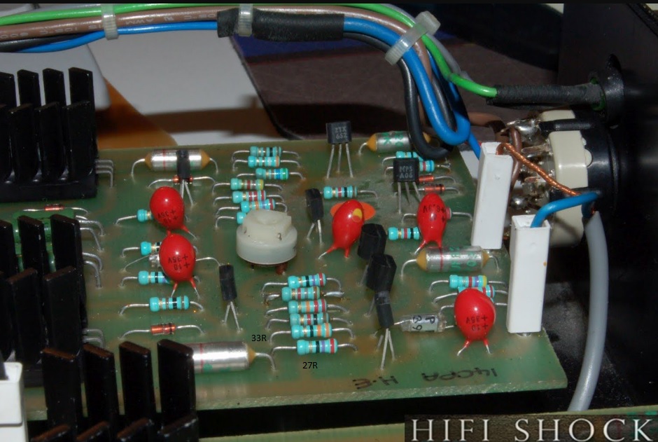

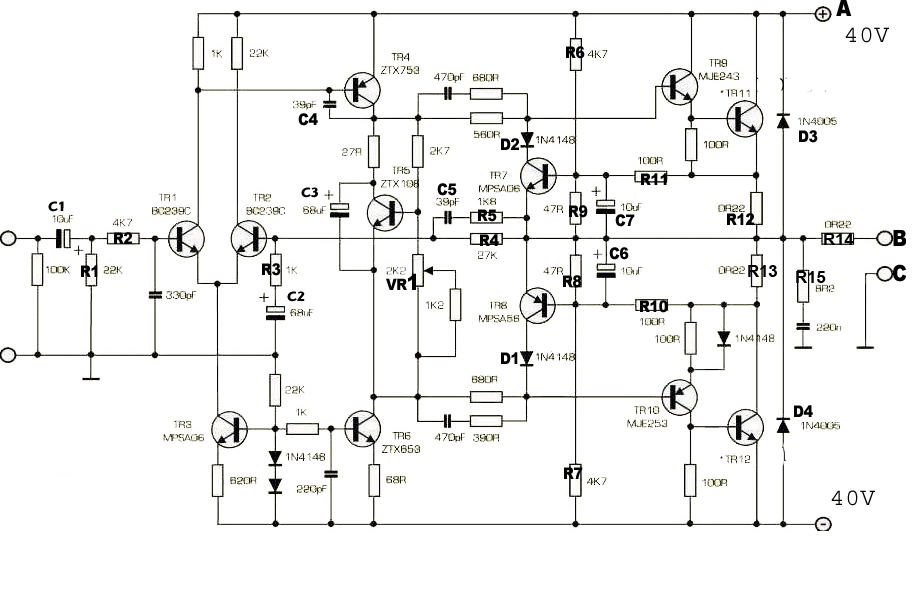

R13/23 and R14/22 are part of those small RC networks which correct phase differences at high frequency but some other models don't fit the networks at all. It's not critical that you use the exact values there but 27/33R seems quite wrong. Where did those values originate? For reference, look at the NAP schematic, shown several times in this thread, rather than the kit supplier's, though importantly, that will show their adjusted values to suit the range of parts supplied in their kits.
Note also that the specified 40V supply voltages are actually for NAP250. Don't exceed those rail voltages on any variation using the original semis. The semis supplied with cheap kits are rated at higher voltages but don't have enough heat dissipation anyway. In the real products, models such as NAP 140 use lower rail voltages and some resistor values are also slightly reduced to provide consistent bias currents in the front end. Otherwise, the same schematic is suitable for all early NAP models.
BTW, Q5, the Vbe multiplier transistor - TIP41? Amazing, I wonder what they were thinking when any small NPN will do fine there. If it needs to be attached to something, a BD139 or 2SD669 would be OK, otherwise any TO92 like BC548, 2N5551 etc can be used.
Hi, if i get time today, i will point you to the values presented here.
27R/33R has been common on NAP140 circuit, were non-regulated and small VA transformer, smaller values usually are used on upper NPN DRIVER BASE.
I have myself played with these filters and know, if filter network resistor values are high, the sound becomes more dry and potential of oscillation will rise.
If lower values are used, there is less chance for oscillation, sound profile also changes.
Most interesting part i experienced, is that if you loop one middle octave piano note and listen very closely to a speaker while turning trimpots on filter networks...you can actually hear some effect/noise with the piano note coming out and fading away, depends on resistor values
Hmm... that effect seems like drive current starvation.
When I simulate a generic amp (that's a Naim without the tweaks - same as that discussed at length in Douglas Self's articles and books) I find lowest THD with around 30R driver base stoppers. Traditional, nominal values have been 100R in many model designs I've seen and built but confess that I haven't played much with those values. There's a lot of fans of those early Naits but I wonder whether that has more to do with affordability than outright SQ.

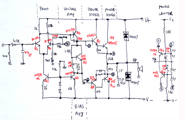

If you look at Nait models 1 and 2 at least, (attached is a hand sketched circuit from the net) you can see that the RC network is just omitted and not a stopper resistor is in sight - the VAS will die too when an output device shorts.

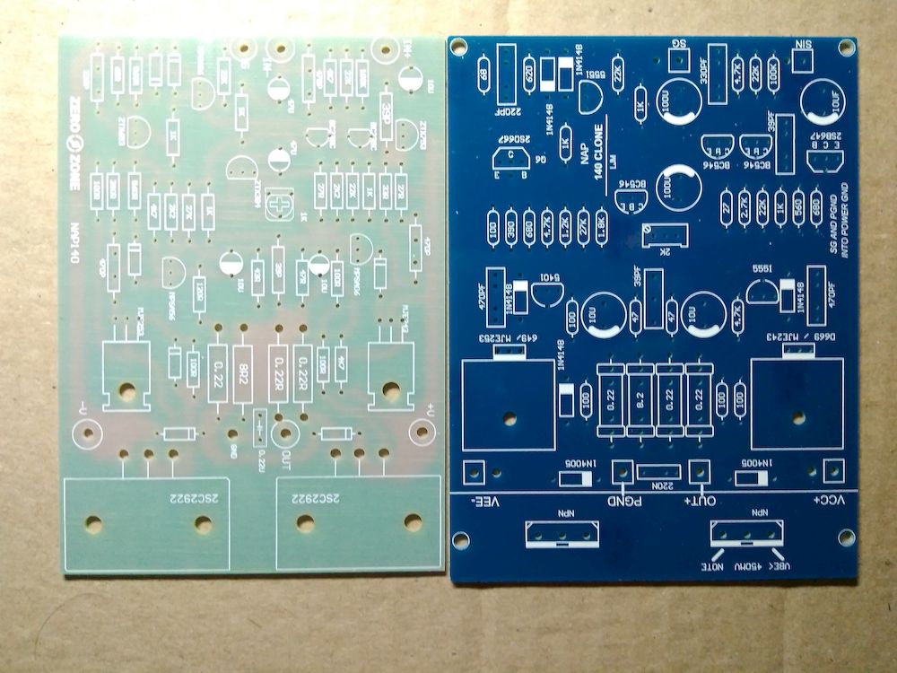

1.
The 27/33R are at the green PCB:
I't not a kit. Only PCB. (C2240 ) (http://www.diyaudio.com/forums/solid-state/112453-nap-140-clone-amp-kit-ebay-251.html#post5024464)
2. Q5 is C2240
2. Q5 is C2240
Ah, thanks Alex74, I have a pair of those on order as full kits but didn't realize they incorporated such a modification. Strange days when clone kit suppliers just follow their own path but use the same titles as the correct circuit, but with another different schematic that doesn't match either boards
There are countless photos about these resistor values, al seems legitable and original.
http://www.hifishock.org/galleries/electronics/naim/power-amplifier/nap-140-2-naim.jpg
