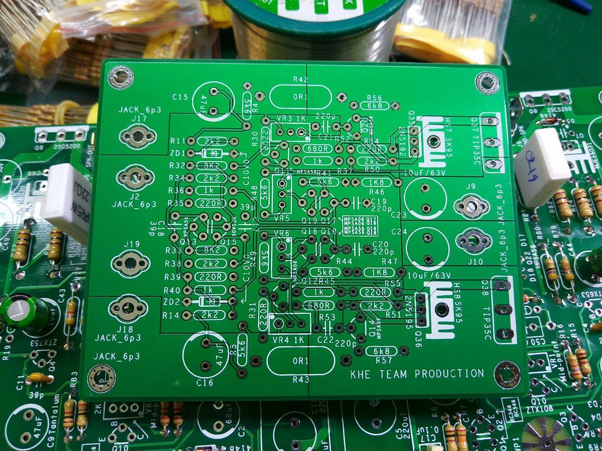

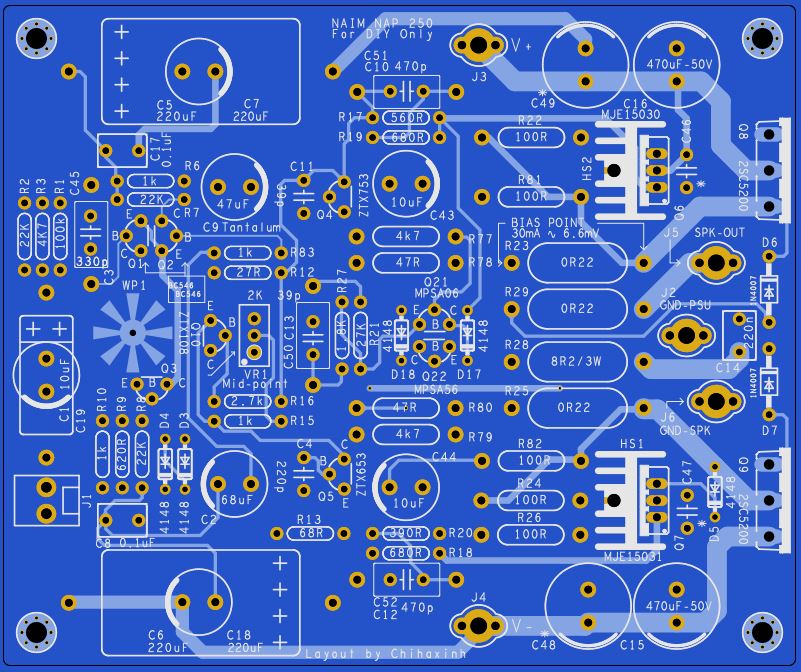

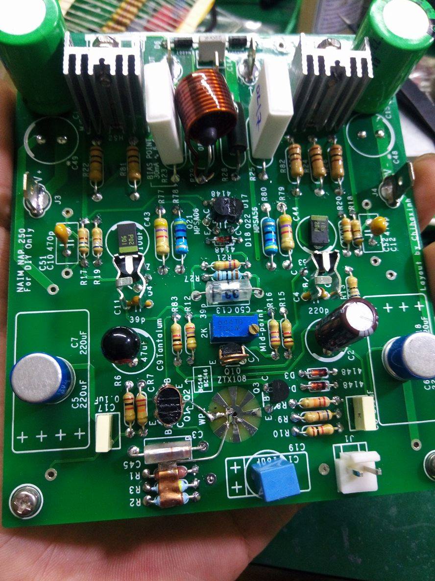

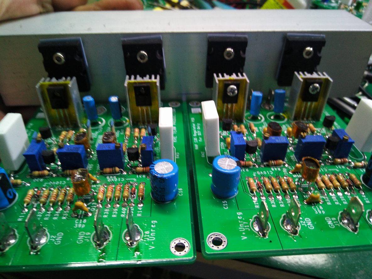

Hi

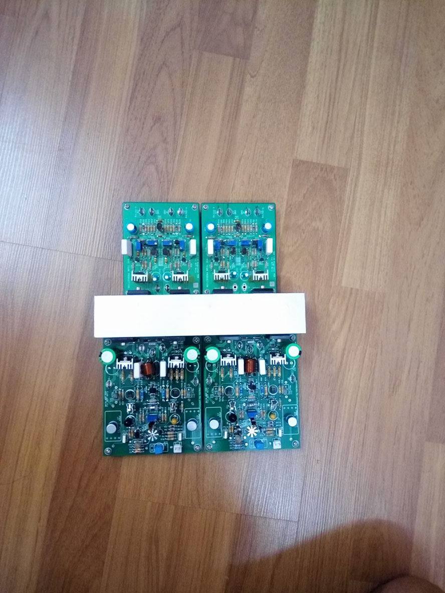

If anyone interesting about NAP 140 , i can provide PCB Power Amp and Regulator .
I layout PCB based on NAP 140 schematics and regulator ! Belows it's picture layout.
- Capacitor in based on Vishay axial tantanum cap
- NFB base on kemet tantan and pitch about 5mm for cap
- Layout for TO-3P Transistor like 2SC5200 or MJL3281A
- Pcb have modified option cap by pass power transistor.
Edit
You can chose 3 option
1. Full Kit : 2 pcb Amp + 2 pcb regulator - 30$ not include shipping ( EMS Shipping ).
2. PCB Power Amp only : 2 PCB Amp - 20$ not include shipping ( EMS Shipping ).
3. Regulator only : 2 PCB Regulator - 15$ not include shipping ( EMS Shipping ).
PCB: FR4 - 1.6mm
Copper : 2oz
Hot tin surface
Below it's some picture pcb i and my friend build ! :)

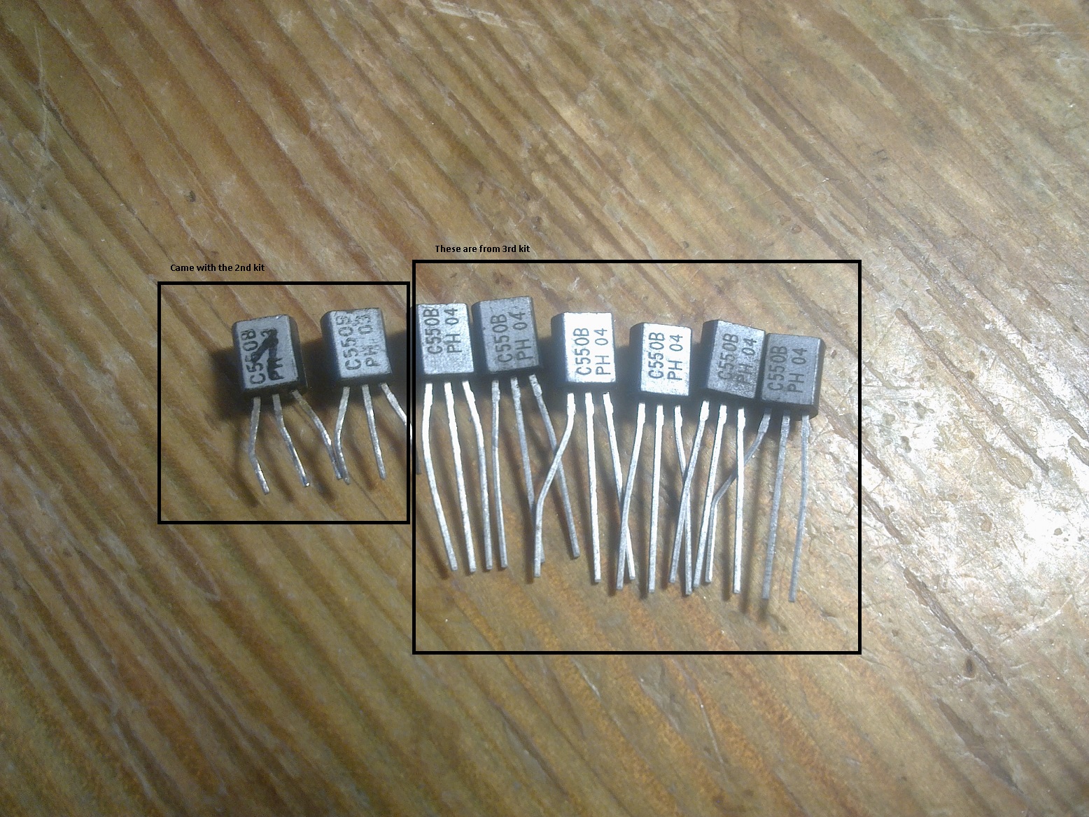

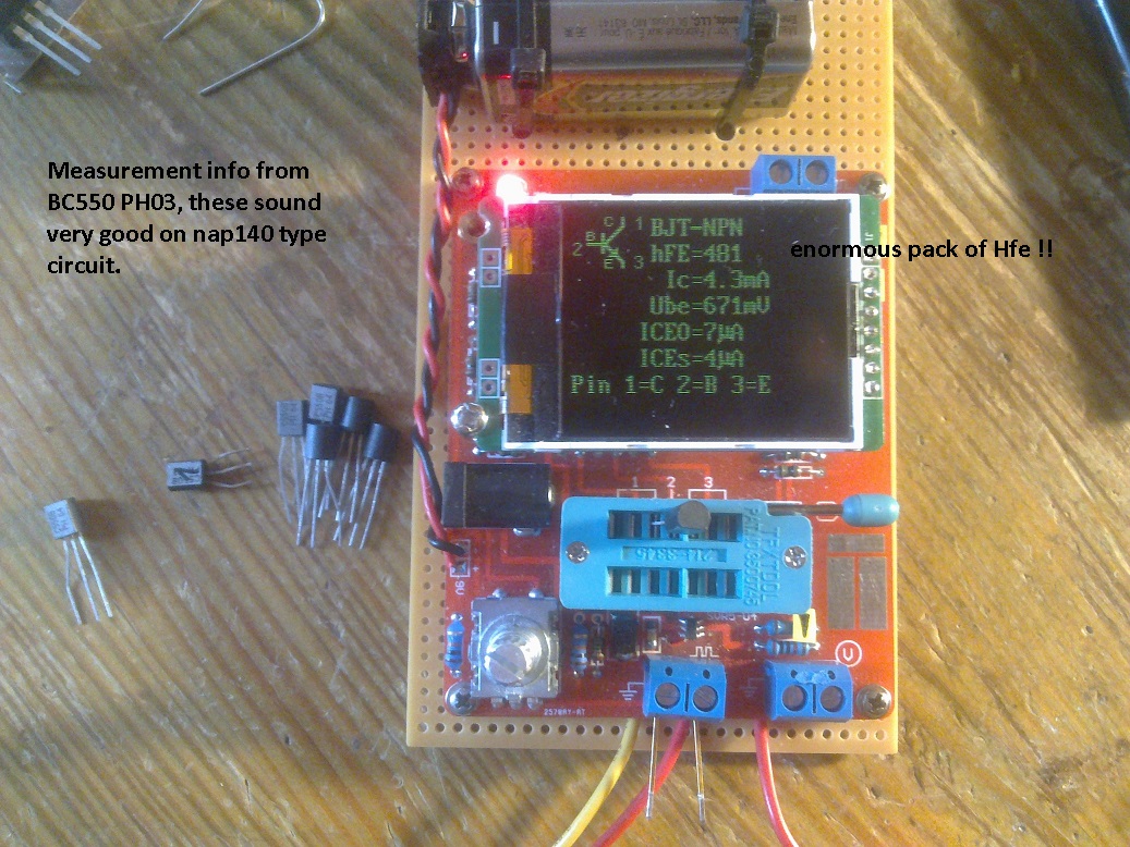

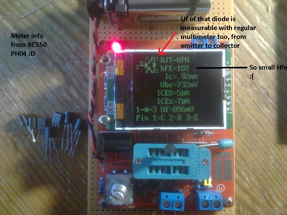

I recently recieved another H-140 clone.
Measuring input BC550B PH04 transistors got me wondering...looks like an IGBT to me:D
What you guys think about BC550B PH04 transistors?

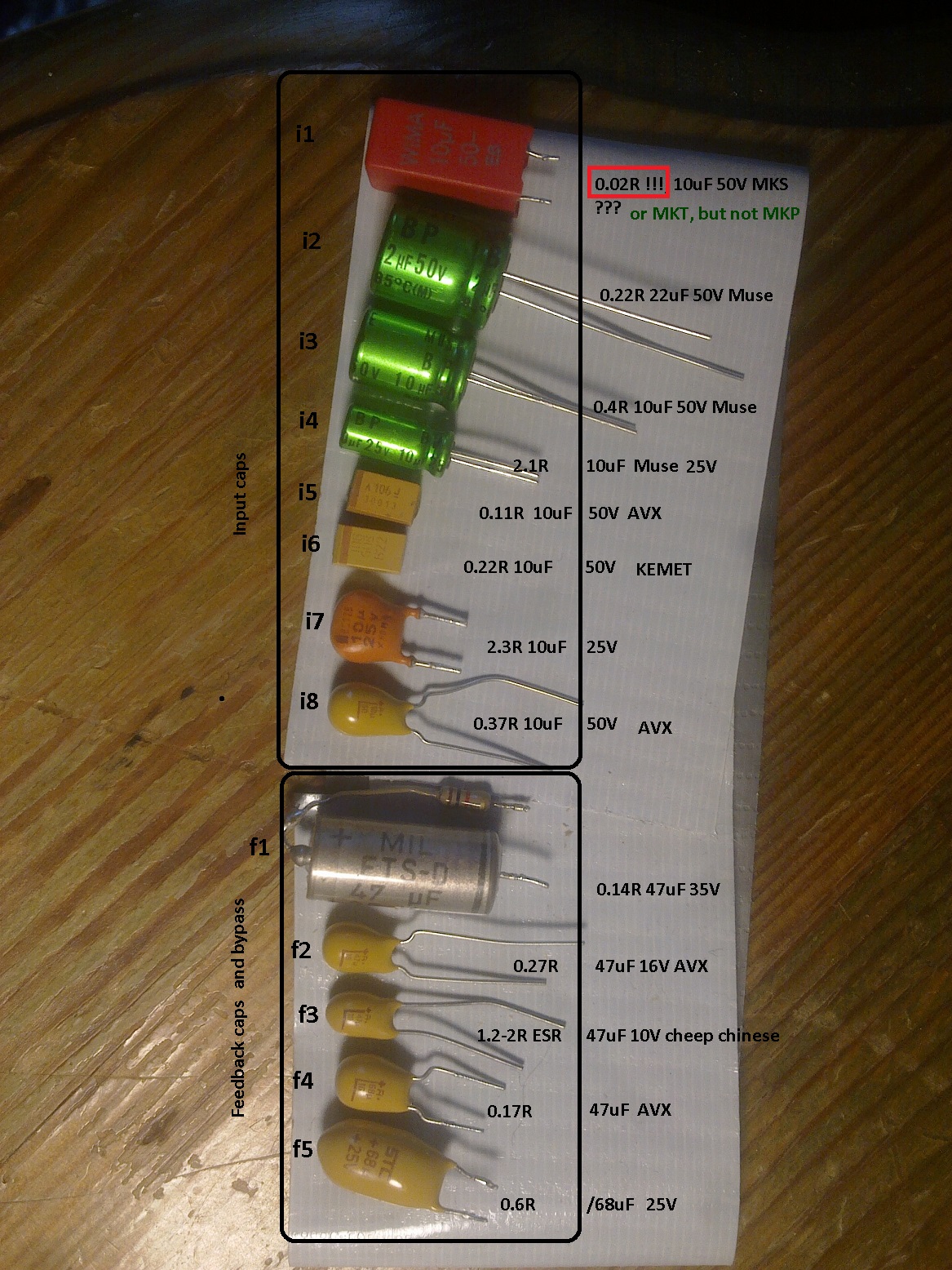

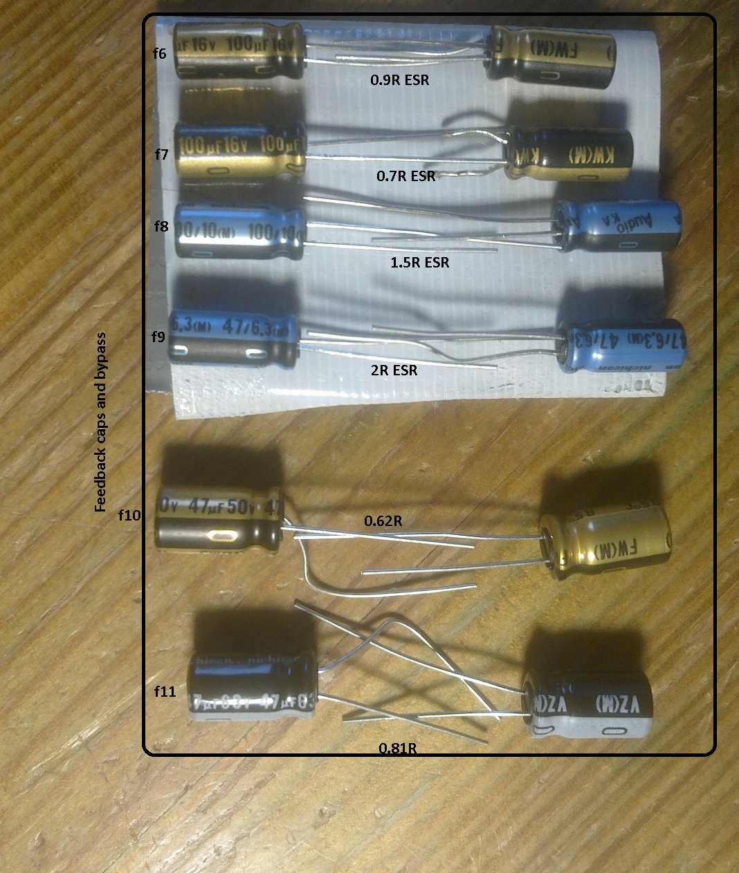

I would like to introduce snake oil capacitors a little,
here is what i have done:
I have listened to them all, long term, stereo config, NAP 140 close orig circuit and H-140 clone.
"i" stands for input capacitor
"f" is feedback and bypass
Input capacitors:
Good and all same-like capacitors, no difference.:
i8, i3, i1, i5
Interesting:
i7, i4
Metallic sound:
i6
Feedback and bypass:
Very interesting sound:
f3, f5, f6, f8, f9, tants have a huge impact on highs, making these softer.​
Everything else is just normal, not very very bad and also not very good.
Using low ESR feedbacks and bypass is a bad idea in this circuit.
EDIT: TYPO: f4 is 68uF, not 47uF as marked.

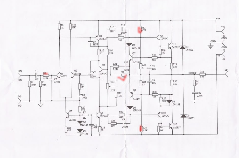

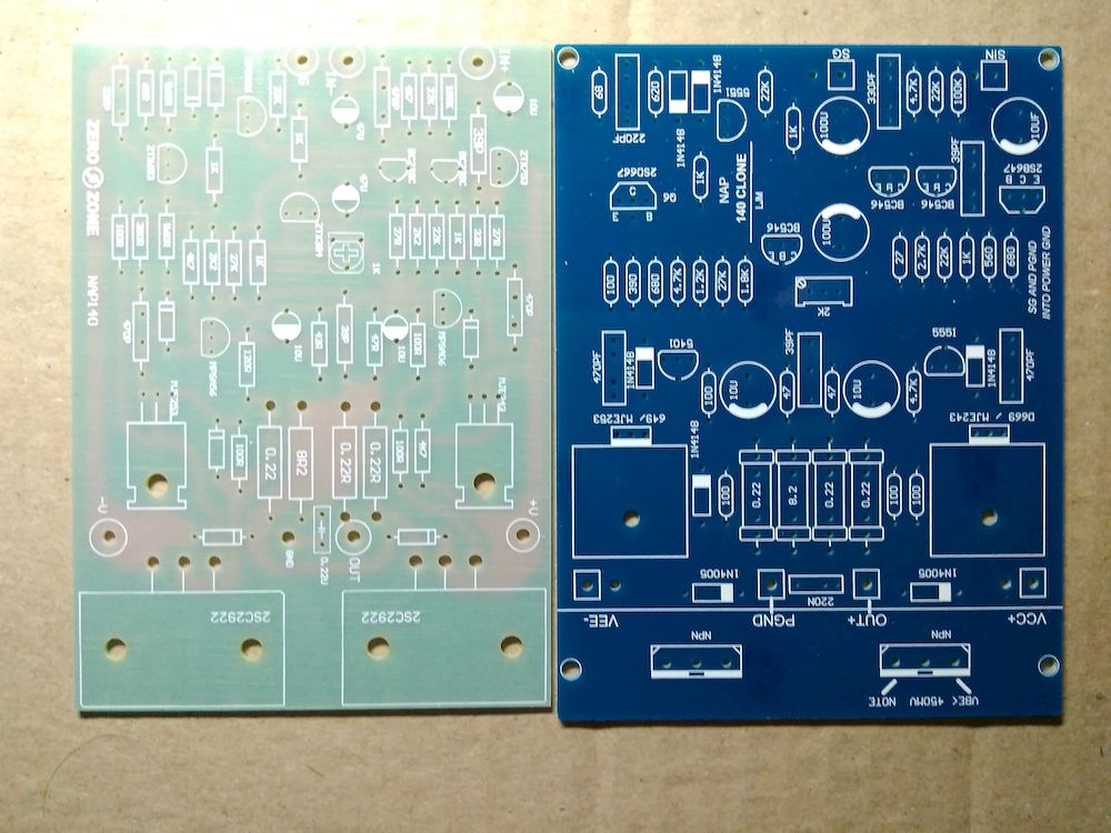

Hi! My PCB is green.
Several questions about components.
1. С40 - Wima MKS-2 0,022 uF / 63V is good? MKP Wima is very big
2. Q1-Q2 I can't find BC239C. May be BC550 (Fairchild), BC546B (DC), BC546BG (ON Semiconductor)?
3. Q5 I can't find ztx384. BC546, BC550 or tip41C?
4. R21 560R or 620R?
5. R16 2,7K or 2,2K?

C40, it depends again... 100-220nf, small wima is sufficient.
Q1-Q2, dont fail here, BC550B fairchild sufficient, BC550B PH03 philips best.
Q5, C2240 would be my option here, and not hard to get.
R21, it again depends...Try both and decide.
R16, 2.7K.
Also dont fail with DRIVERS, if you cant find original/correct TIP41C family, go with MJE243/253, or else amp will not sound.

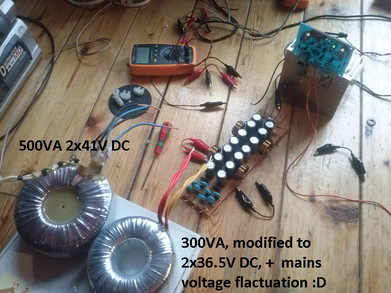

Most important that i found lately is the rail voltage that you will feed to your amp.
I found myself, that NOTHING is better then +/- 36V or absolute Maximum: 37V, in your case without the front end RC network, 33 or 34V would sound the best.
All others here and myself who used the amps with 40+ rail voltage failed hard. Its important... if you miss it... you will end up tuning your amp forever(changing every possible component and have a moment with a new FAIL sound thinking its cool..... it lasts a day... and after you will hate it).
And, if you happen to have output transistors with different HFE, then try to place LOWER HFE one in place of Q12, Higher HFE to Q11 position. This approach will "soften" the sound on MID-HIGH-s.
Also, Filterbank PSU must be in right size for correct operation, exceeding 15mF per rail will give you better background sound, but worse "overall" sound.
Using regular low-esr electrolytics in place of C6 and C5 will result in the same effect as with 15mF+ filter PSU :D
EDIT: there is no need for exotic nano tech snakeoil components for audio, just correct approach and bias, circuit will sound good with ceramics all over it :D
Failing it doing with regular components, snake oil will not help here either... it will make you think it helped... for a moment again :))

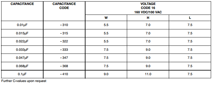

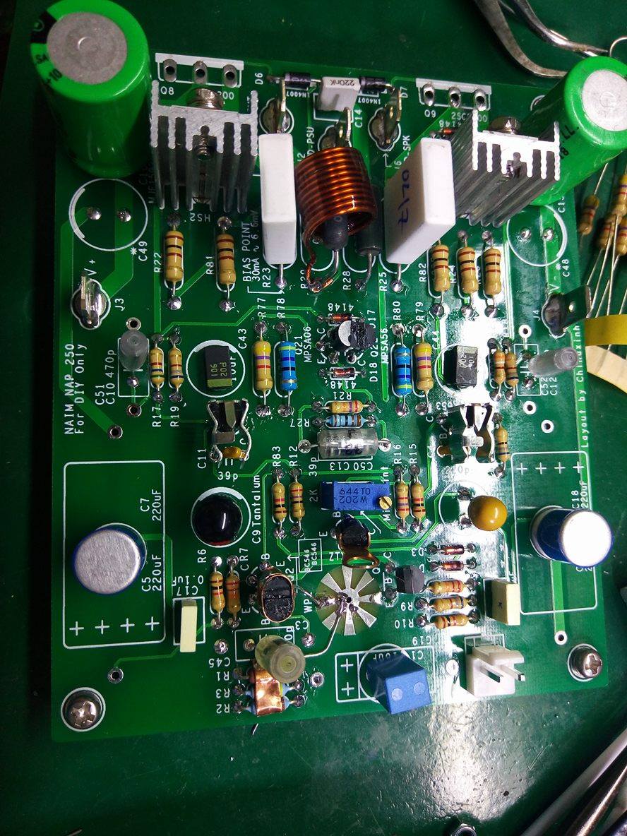

1. С40 - Wima MKS-2 0,022 uF / 63V is good? MKP Wima is very big....
Hi Alex. There are are many categories of film caps and DIY people often substitute to either get cheap prices or smaller size. However, polyester film types like MKT, MKS or MMK are generally not the best for audio applications. https://en.wikipedia.org/wiki/Film_capacitor
However, MKT type is OK and commonly used for the Zobel network (the RC shunt to ground at the output) capacitor of 220nF or 0.22 uF, as in Naim NAP models and most class AB amplifers. I think this must be the cap you mean (C40?). There is no claimed benefit to substituting polypropylene types in that Zobel network though.
MKP type is certainly larger than MKS but 0.022uF is not a large value cap in either type. Attached is Vishay Roederstein's dimensional spec. for 160V rated MKP caps:
As a general comment, I now find it is a good idea and usually cheaper to buy a full kit of Ebay PCB + components. In good quality kits like those for the PCBs you have, the few parts that could be upgraded (if you believe they will be better) won't be important to getting it working well and at least they will fit the PCB without hassles.
